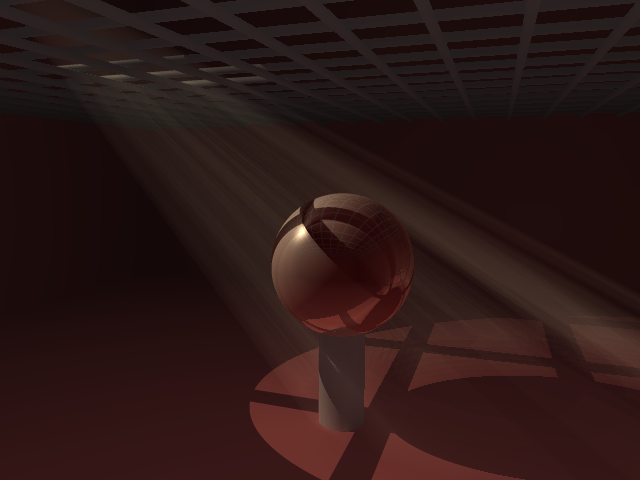

Hi!
Since most of the things I've done previously have very little - even
nothing - to do with media and radiosity, I wanted to try them out a bit :)
So here's a very simple one, a reflective sphere BELOW chequered (sort of)
plane. "Enjoy"
My civ3-units - modelled and animated with pov-ray:
http://forums.civfanatics.com/showpost.php?p=2036938&postcount=4
Download 'media_radiosity_test1.png' (116 KB)
Preview of image 'media_radiosity_test1.png'

very nice.  Can you repost it using an area light in your spot light.  I'd
like to see that.  I might even nick it for a wallpaper at work.

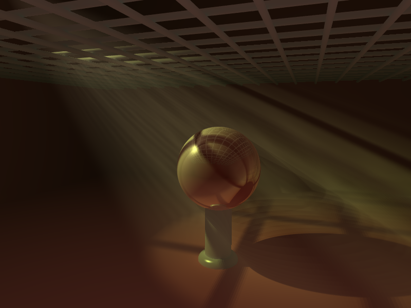

did you mean something like this? Do remember, that I'm kinda noobie with
these features :)
Download 'media1b.png' (224 KB)
Preview of image 'media1b.png'

Yes thats it!  It is now my wallpaper Thanks!
Whats the "ambient" setting in the pillars texture?

This is nice. If I may make a few suggestions:
 - Lower your anti-aliasing threshold; there are some noticeable aliasing
artifacts in the reflection and on the bottom of the sphere.
 - You can see the area light sampling bands on the floor. You can eliminate
this by bringing up the number of area light samples. Be sure to use
"adaptive 1" so that higher sampling is only done in the partially-shadowed
areas. If you're worried about this making the media render slowly, you
might consider using two separate area lights: one for the media and one for
the solid objects, by using light_groups.
 - The media itself has some banding problems. If you bring up the number of
media samples ("samples 20" for example), this could be reduced.
 - Finally, you might consider doing something to hide the abrupt ending of
the ceiling towards the edges of the scene. Maybe add walls, or make the
ceiling go farther out.
 - Slime
 [ http://www.slimeland.com/ ]

Now THAT looks really neat! The area light definitely helps...
(Agreed with what Slime said about turning up the various sampling
parameters. OOC, how slow it is currently?)
As an aside... there are several places in POV-Ray where adaptive
sampling is done. (Area lights, media, focal blur, radiosity...) I
always thought it would be nice if there were some common syntax for all
these different things. (Respecting of course that some of them
inherantly have different characteristics and so different options might
be especially applicable to only some of them.) But hey...

Slime nous apporta ses lumieres en ce 2005-07-09 01:11:
>  - Slime
Using adaptive 0 may be suficient. Try an area_light aray of 17*17 or 33*33 or even
65*65. Adding
jitter 1 may help but get less improvement when using denser arays.
I agree on more samples in the media, avoid using more intervals when using method 3
(the default)
as it dramaticaly increase the render time. 100 samples is faster than 10 intervals!

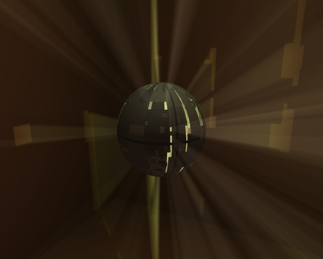

Ok, I think I understood most of these tips :)
To the question of render time: it was about 1 h 30 mins (because of the
large number of "holes on the roof where the light comes".
I also wondered what caused the banding there. Now that's clear, thanks.
Now, here's another type of media test. Render time: 33 mins. I increased
the number of samples in the media from 15 to 90 - no more banding :) (not
that I can see).
Download 'media_radiosity_test2.png' (393 KB)
Preview of image 'media_radiosity_test2.png'

aaglo nous apporta ses lumieres en ce 2005-07-12 05:04:
If you used a difference ov a large box and several small boxes, it's slow. Some beter
solution:
- use 2 arays of long boxes in an union
- use a small diference of 2 boxes. Place them repetately to recreate your roof.
When you punch lots of holes, you get extremely bad bounding: POV Ray have to check
for all the
diferenced small box to determine if you are on a solid or empty spot.
beter solution:
for all the
> Alain
they weren't boxes with differences. They were cylinders.
