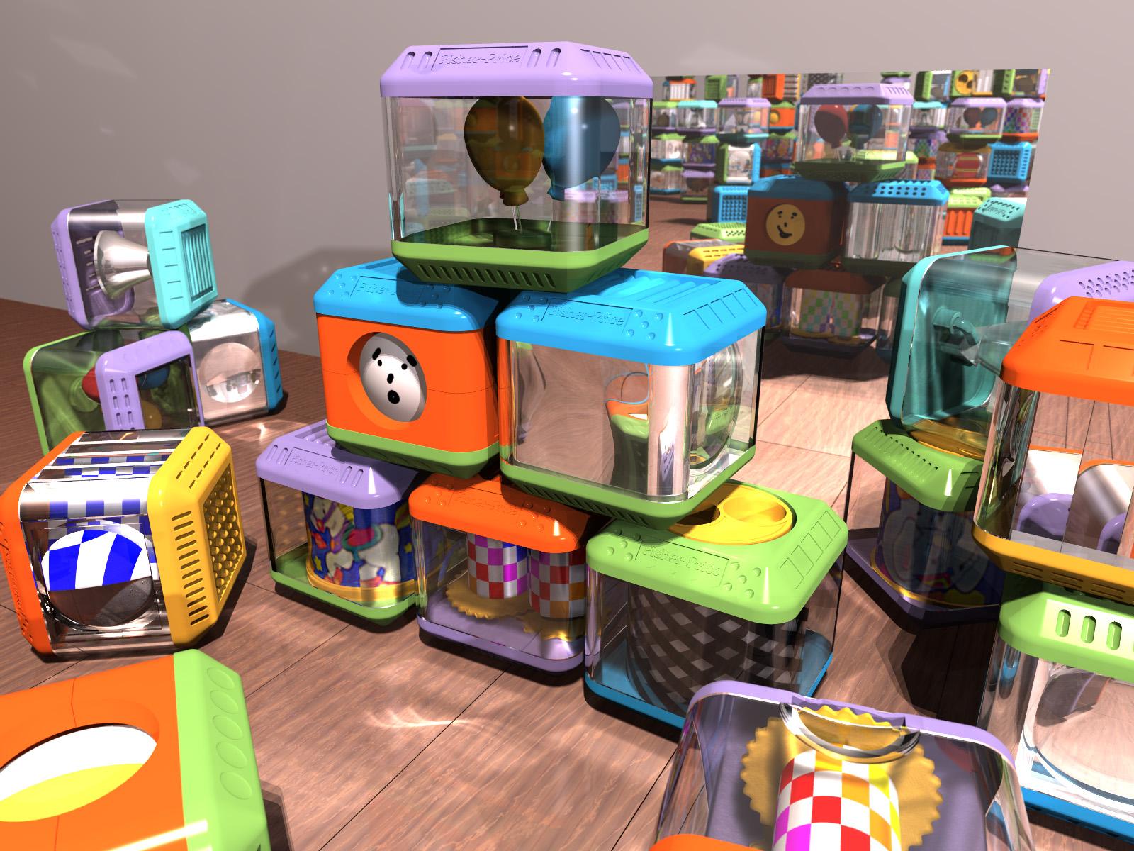

Ok. Here's another iteration. I'm getting much closer to what I want. The
index of refraction on the plastic walls is much too high. Need to tone it
down a bit. Other than that. I'm getting close to wrapping this one up. I
may add another block type or two. We'll see.
