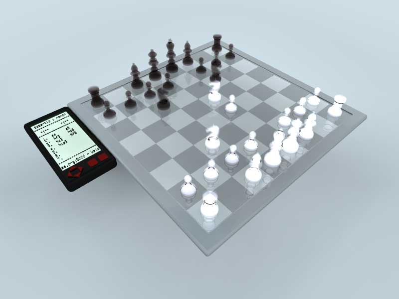

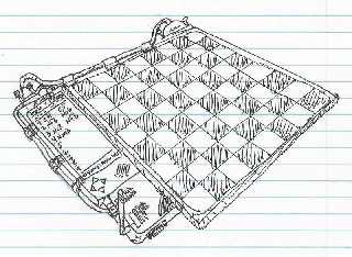

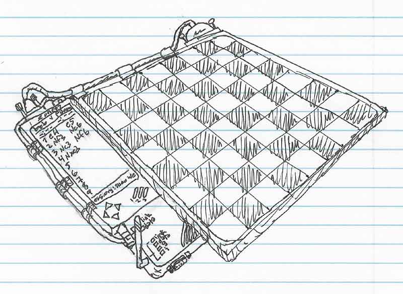

This is a simple render of a chess board I'm working on. It's supposed
to be electronic and the pieces are holographic. I also included a
sketch of what it should look like when it's done (since it's no where
near that yet :P) I didn't make the pieces, they are lathe objects I
found by Knut Arlid Estrad.
Any comments or suggestions?

From: Reactor
Subject: Re: chess board WIP (100k~)
Date: 28 Jul 2004 19:49:45
Message: <41083b99$3@news.povray.org>
I highly recommend using emission media to give a projected look, and making
the chess pieces "hover" a bit above the board.  If you play with the
samples and aa values for method 3 media, you could even acheive a staticy
effect.
  Scattering medias could be used to show that the pieces are projected
from a source, maybe make the white squares glow, and so on...
Just a few quick ideas.
         Reactor
From: bob
Date: 28 Jul 2004 20:06:21
Message: <u6slt1-342.ln1@phillip.local.net>
> effect.
>          Reactor
Thanks, I already am using emmission media, but I couldn't get it too
visible without making the pieces farily opaque, but I'm still working
(this is the first time I have used media) Thanks for your suggestions :D
From: Reactor
Date: 28 Jul 2004 21:06:05
Message: <41084d7d$1@news.povray.org>
"bob" <bob### [at] spamearthlinknet> wrote in message
news:u6s### [at] philliplocalnet...
When using emission media, the objects should be transparent or translucent
and hollow.
From your remarks it sounded like your success had been limited.  If you
would post a code snipet, I might be able to advise you better, but "better"
largely depends on what sort of look you want to achieve.  I had meant using
media to represent the object by itself, and not have a visible "shell" at
all...
                     Reactor
From: Josh
Date: 29 Jul 2004 12:44:36
Message: <41092974$1@news.povray.org>
very nice.  If you stick with the same transparency, it might be worth
"dulling" the reflection on the board itself, as this , although "right"
confuses the image of the chess pieces.

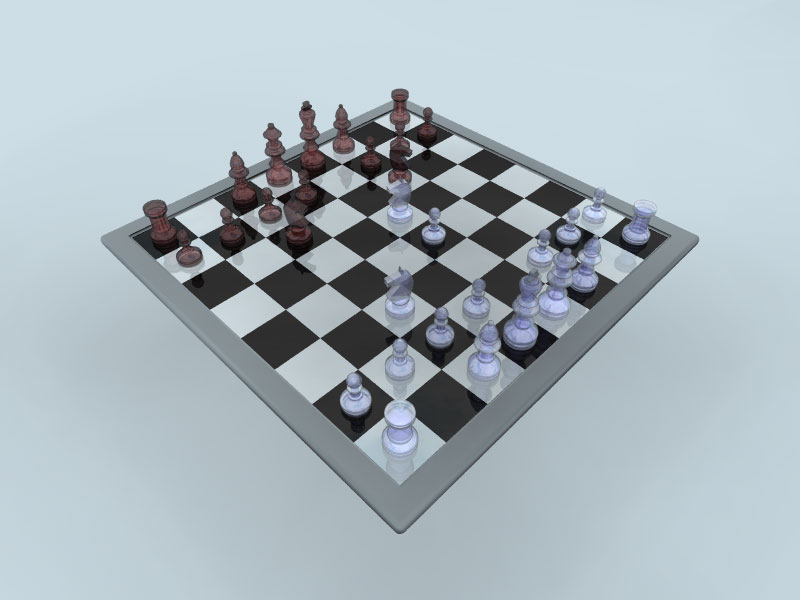

From: bob
Date: 29 Jul 2004 19:30:08
Message: <kvaot1-hj1.ln1@phillip.local.net>
> and hollow.
> all...
>                      Reactor
Ok, I figured out using media a little better. (I just made them almost
completely opaque to hide my terrible use of media in the first post)
For now I am just using a completely clear pigment and 'hollow on' with
'absorbtion <3.7,4.0,4.0>' for the black pieces and 'emission
<3.0,3.0,3.3>' for the whites. I tried changing other options in the
media, but took them out cause I had no idea what I was doing :P. I am
fairly satisfied with this look, at least enough to wait until I finish
modelling the rest to tweak it more. I attached what I have now.
Download 'chess.jpg' (24 KB)
Preview of image 'chess.jpg'
From: bob
Date: 29 Jul 2004 19:30:20
Message: <dtaot1-jj1.ln1@phillip.local.net>
> and hollow.
> all...
>                      Reactor
