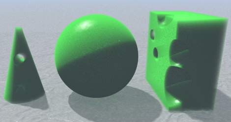

I also try to create some wax-like materials.
This is the first approach witch creates quite "light" wax i.e. with much
water in it, or partially melted).
To do:
- to transparent near thin corners, I'll probably change pigment{rgbf 1} to
something less clear
- no radiosity, GI calculations doesn't affect media (only there are
effected *by* media), but I have few ideas how to fix this.
From: Rafal 'Raf256' Maj
Subject: Re: Wax [wip, 1] - 1 attachment
Date: 30 Nov 2003 02:55:49
Message: <Xns94435AD0F8327raf256com@204.213.191.226>
spa### [at] raf256com news:Xns### [at] 204213191226
Download 'material_scattering_r01.jpg' (30 KB)
Preview of image 'material_scattering_r01.jpg'
From: Hughes, B
Date: 30 Nov 2003 04:26:20
Message: <3fc9b7bc@news.povray.org>
"Rafal 'Raf256' Maj" <spa### [at] raf256com> wrote in message
Or very fat-free cheese. :-)
Are you using absorption? How about media_attenuation in the light source? I
think a lot of scattering alone tends to look this way.
Bob H.
Date: 30 Nov 2003 05:17:40
Message: <Xns944372DD37467raf256com@204.213.191.226>
omn### [at] charternet news:3fc9b7bc@news.povray.org
I do
> source?
Light is at default settings
> I think a lot of scattering alone tends to look this way.
Material is:
  pigment { rgbf 1 } // <-- I will change it
  finish {  brilliance 1.3  phong 0.35   .... }
  normal { average normal_map {
      [1.0 facets coords .1]
      [1.0 facets size .1]
      [0.1 granite .3 scale .03]
  interior {
    media {
      #local C = <1,.3,0>; // color
      density {
        average
        density_map {
         [1 bozo color_map{[0 rgb .8][.80 rgb .8][.85 rgb 1][1 rgb 6]} scale 0.06 ]
         [1 bozo color_map{[0 rgb .8][.60 rgb .8][.80 rgb 1.3][1 rgb 2]} scale 0.02 ]
      absorption rgb 0.5
      scattering { 1 rgb C extinction 0 }

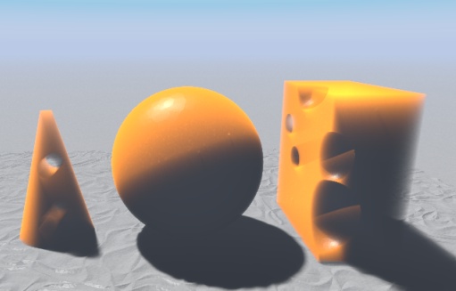

From: Hughes, B
Date: 30 Nov 2003 06:26:29
Message: <3fc9d3e5$1@news.povray.org>
Hey, Rafal, I might take back my thought about using media_attenuation in
the light source, since I think that matters only for the fading value used
within the light source itself. Not 100% positive about that.
Now I understand the appearance of your media better, that extinction value
being zero accounts for the extreme brightness on the lit sides.
I was trying out a similar test here immediately after seeing your image.
Found that it isn't as easy as it looks. You might want to try fade_distance
0.1 or 0.2 in the interior statement. I tried a index of refraction and
really messed it up. So... good luck with it!
Bob H.

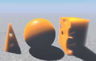

Subject: Re: Wax [wip, 2] - 1 attachment
Date: 1 Dec 2003 07:51:10
Message: <Xns94448CE20ACCFraf256com@204.213.191.226>
SSS by Raf256, second re-try.
Better, worse?
Do You like the little crand-like-thing inside media (noise) ?
Download 'material_scattering.mesh.jpg' (32 KB)
Preview of image 'material_scattering.mesh.jpg'
From: Hughes, B
Date: 1 Dec 2003 12:00:24
Message: <3fcb73a8@news.povray.org>
Better, yes. Yet, like I was finding out myself, it might prove nearly
impossible to get the cutaway parts looking right with media alone. Maybe
there's a way to obscure the CSG differenced inside surfaces from appearing
through to the outside by using fade_color.
The speckling gives it texture, but my first reaction was of a sponge
material except it doesn't show on the overall surface.
Bob H.
http://www.3digitaleyes.com
