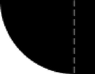

I'm trying to produce some visuals of a custom fish tank, and I'm not
having much luck so far.  The tank is a quarter cylinder, with one of the
flat sides extended out (see attached image, the dashed line is just to
highlight the shape).  I've tried straight CSG using merge, but where the
quarter cylinder and the box merge you can see where they meet!  If I make
the box a little bit bigger, so that there are no coincident surfaces, there
is a noticable ridge where the curve meets the box.
  I'm wondering if a prism shape would be better, but I have no idea if this
shape is possible with a prism.  I also need to be able to replicate the
shape for CSG, to remove all but just the thin walls of the tank, and to add
water.
  Another way to do this would be to make the walls and floor seperately,
but I have no idea how to make a quarter circle with one arm extended, and
this MUST be one seamless piece.
  For the curious, the tank is 36 inches along the back, 28 inches along the
side.  The quarter cylinder has a radius of 28 inches.  The tank will be 24
or 36 inches high (I haven't decided yet).  It'll be a reef tank.  Are there
any POV objects of corals and other marine creatures available?  I know
someone named "smb" was working on something like this several years ago,
based on messages on this server, but I can't find any references to that
project on the web.
Rich Allen
(Remove SPAM from my address to reply by e-mail)
Download 'shape.gif' (1 KB)
Preview of image 'shape.gif'

Do not try to extend the box part, rather extend the 1/4 cylinder, then!
sample:
 merge {
   box { 0, <1,-1,1> }
   intersection {
      cylinder { 0, <0,0,1>, 1 }
      box { <-1.1, -1.1, -0.1>,<0.1, 0, 1.1> } // instead of <0,0,1.1>
Non Sine Numine

Well, isn't that embarassing...  I should have thought of that, it works
perfectly.  Thanks!
