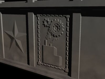

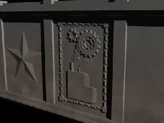

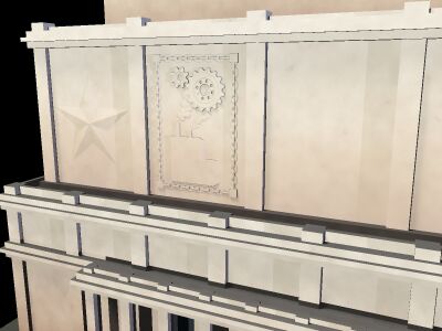

I've added some more detail to my bas relief of "INDUSTRY" for the Palace.
I still want to detail the factory, but that should be fairly simple.

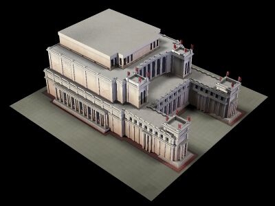

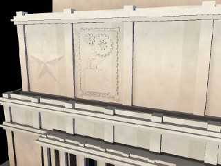

Three views attached: A neutral light viewing of the new, improved, panel,
an overview of the Palace as it currently stands (with new plaza and third
floor), and a detail view of the bas relief using the model lighting (a
little too subtle for me. I think I'll have to use some textures to enhance
it a bit.).
There are a total of 5 panels. I'm going to use stars for the first and
last, and INDUSTRY accounts for one of the remaining three. For the others,
I'm considering POLITIK and MILLITARY. I think that one of the MegaPov
depth post-process may come in handy for generating some of the
heightfields.
This is fun!

That is just amazing. I love the second image. Beautiful! :)

A grime shader would bring out the detail in a natural looking way.
Basically the color should get darker on concave areas where there is a
large normal variance over a sampled area. You could limit this to normals
within a certain range of "up" if you with to simulate the fallout of
pollution collecting in surface details.
Has anyone done this in POV yet?

A gradient layered texture would do that, somewhat anyway.
> > This is fun!
And it also looks like fun.  I've been watching along the way.

It already seems as if it's finished it will look great on a really large
render.  How much memory does it take right now?

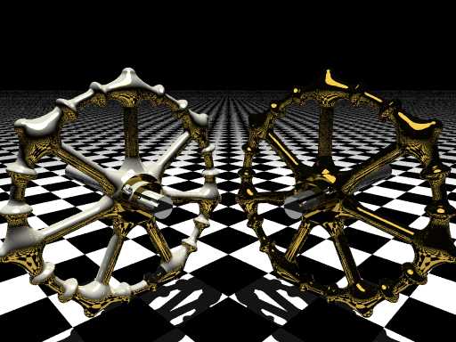

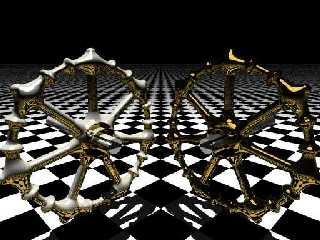

This image illustrates a 'dust' texture I developed for my image in the
Worship round (tgq1984) of the IRTC.  Obviously the image on the left has
the dust applied while the one on the right does not.  The dust texture was
made using the MegaPOV slope pattern.
