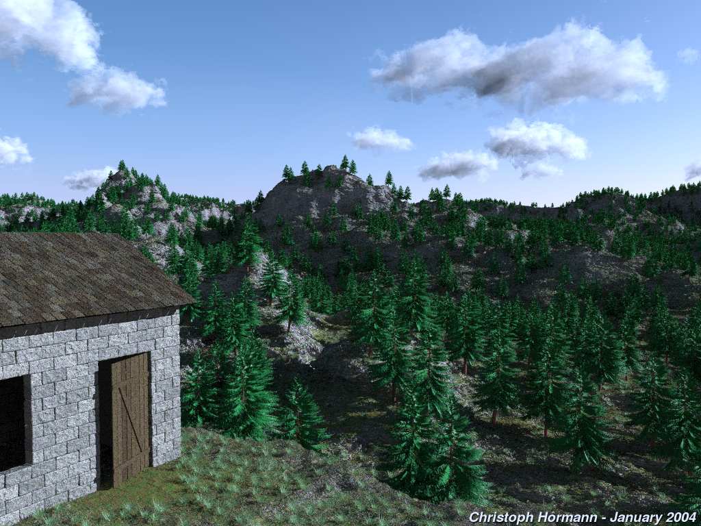

Here is a test render of a scene i have been working on the last days.
It is a bit of a test case for how efficiently you can use massive
instancing for reoccurring objects like trees instead of multiple
versions with different levels of detail.  The result is quite
encouraging, the scene contains:
  258000 grass patches each 6000 triangles
   24700 trees each 501000 triangles
   -> in total more than 13 billion triangles
The rest (terrain and house) is made with isosurfaces - total memory use
about 700 Mb.  And it only takes about 6 hours to render (with
ridiculously low radiosity settings, no area_light and quite bad aa though).
The clouds are made with makeclouds, the sky with lightsys/skylight and
the trees with povtree.
Some observations i have made with the different tools:
- lightsys: the mesh created for the sky is not very good, i got
multiple 'all determinants too small' messages.
- povtree seems to scale the leaves of the tree with the size of the
branches, normally you'd expect all leaves to be about the same size.
For the way how the leaves are used in a needle tree (which is of course
not so suited for a closeup view) this is not so bad but otherwise it
can look quite unrealistic.
- the makeclouds clouds do not look very good in a larger render but i
would probably just have to create a higher resolution df3 for this purpose.
American billions ;)
You can control that specifying negative values for 'Taper Off At'
on 'Bunch' tab. You can even achieve opposite effect when leaves
on top look bigger than bottom leaves :)
Gena.

Looks good, Chris. Too bad I'm not willing to put up with such long
render times.... I'd rather be animating :)
The rocky hills could use a little more variation in texturing to make
them look abused and overgrown with lichen.... In fact, considering the
way the trees are placed and the structure of the hills, I'd say they
could be composed of volcanic ash (a.k.a. rhyolite).
We have places nearby which look a lot like your render. Such places are
also overgrown with bonzai manzanita and mountain mint (smells like
toothpaste).
I consider 6 hours as rather fast, but this is of course a low quality
render.
The flatter parts of the mountains have more structure in the texture
but most of it is covered by trees.  I also rendered it without trees
once and it looked quite interesting (it is quite amazing how such a
modification changes the look of the scene completely.
I am not sure about your suggestion for the type of stone, metamorphous
rocks can lead to similar formations i think.  The lack of structure in
the shadows is also due to the low radiosity quality.
Ah, will try that.

Very nice, I really like your terrain isosurfaces.  I wils I could get mine
to look that natual.
