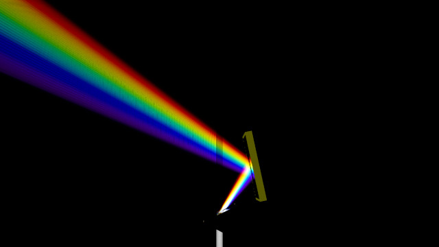

I'm taking a stab at reproducing Bruno Cabbason's "Extreme optics," but
as far as I can tell, he has not published his source code.
Does anyone know how to get rid of that dark band across the spectrum
above the light source?  It is not an object casting a shadow; it is the
light source itself that is creating the shadow.  There is no such
shadow in Bruno's render.
---%<-----%<-----%<-----%<---[BEGIN CODE]---%<-----%<-----%<-----%<---

Download 'extreme_optics-media.jpg' (22 KB)
Preview of image 'extreme_optics-media.jpg'

Most helpful will be increasing the media samples to say 10,10 or more.
There are secondary sampling frequency effects in play too: jitter
on/off in the global_settings media block (use on); media jitter
on/off(2); that official releases of POV-Ray have a banding effect in
the media due how the photons are distributed - which has been removed
in the yuqk branch (1); there are internal differences / fixes in media
sampling between v3.7 and v3.8 - and of course AA.
Bill P.
(1) - Best guess is the photo deposit banding / shift effect was due
some debug code added at some point and never removed.
(2) - The yuqk fork disables media 3 jitter because it does nothing but
introduce 'more' noise given how the adaptive sampling works... And, at
media container boundaries the jitter bleeds outside the container.

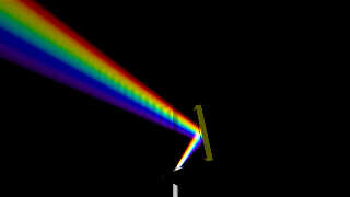

I now see that this is related to the "Light beam won't refract from outside
media container" I posted in p.bugreports, and WFP has responded to that.  I
believe the shadow was caused by non-photon media interaction with the light
source.
But for some reason, the unrefracted light beam isn't showing.
Download 'extreme_optics-media2.jpg' (23 KB)
Preview of image 'extreme_optics-media2.jpg'

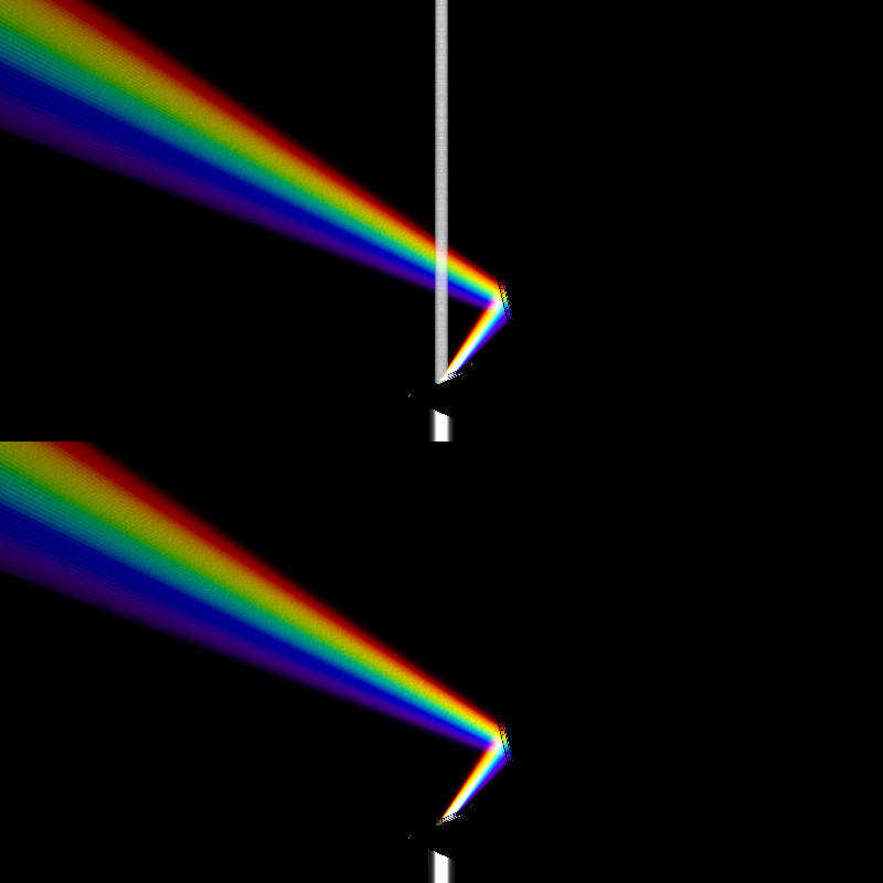

OK. The origin of the light source is inside the box{} media container -
  which is invalid for scattering media calculations; Here in a way
tangled with the photon + scattered media calculations(1).
In the light_source{} block:
     <0, -HALFH - 0.99, -3>, rgb 1
should read:
     <0, -HALFH - 1.01, -3>, rgb 1
With that change and adding:
     photons { target collect off reflection on refraction on }
to the media-box{} block - we get the, additive, results in the top row
of the attached image as one might expect.
If we then add:
     media_interaction off
to the light_source{} block (as you already have), we get the results in
the bottom row of the attached image.
Bill P.
(1) No. I've not run down 'exactly' why the scattering + photons
calculation goes wrong when the light source is inside the media box.
Given we know that's an invalid set up, I'm not motivated at the moment
to run it down.
Download 'ricky_brunocabbason_story.png' (158 KB)
Preview of image 'ricky_brunocabbason_story.png'

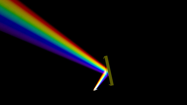

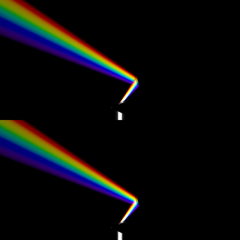

I don't recall ever seeing that image. It's really cool! For others who
might have been distracted too at the time:
https://news.povray.org/povray.binaries.images/thread/%3Cweb.4d54f6b329b411e54aa45fdf0@news.povray.org%3E/
He mentioned having to run with jitter off to avoid splotchy results -
but then getting the banding (interference fringes). I think the banding
spoken about is likely the photon distribution issue mentioned
previously in this thread - which is fixed in the yuqk fork. Attached an
image of your scene (plus previously mentioned adjustments), global
photon jitter off, no AA, with v38 results on the top and yuqk on the
bottom (1).
Aside: Puzzling performance results. I am unsure why yuqk is so much
faster with the scene set up for the attached image?
v3.7
577.29user 0.33system 2:42.95elapsed 354%CPU
v3.8 beta 2
572.11user 0.35system 2:33.45elapsed 373%CPU
yuqk
105.71user 0.13system 0:33.08elapsed 320%CPU
Bill P.
(1) - Yuqk's global photon jitter on|off results look pretty much the same.
Download 'bandingfixinyuqk.png' (162 KB)
Preview of image 'bandingfixinyuqk.png'

2) With global photon jitter on, the number of stored photons is exactly
the same between v3.8 b2 and yuqk.
3) The performance given (2) becomes comparable too:
v3.8 beta 2
131.73user 0.20system 0:42.00elapsed 314%CPU
yuqk
131.10user 0.14system 0:40.54elapsed 323%CPU
So, the yuqk fix to the photon distribution where jitter is off seems to
be the trigger for the many times better performance in that case.
However, I'm left lost as to why a better distribution of stored photons
matters so much to the 'render stage' performance.
Been a long time since I was in the photon code for the photon
distribution fix, but IIRC, the global photon jitter is 'jittering' the
spiral shooting pattern of forward tracing photon rays. The yuqk fix
changed how the photons are distributed along each shot photon ray in
the media.
Both the fix and the spiral photon shooting jitter make the distribution
of stored photons more noisy / random in the stored media - and this
apparently helps 'something' in the photon code work a lot faster.
Bill P.
