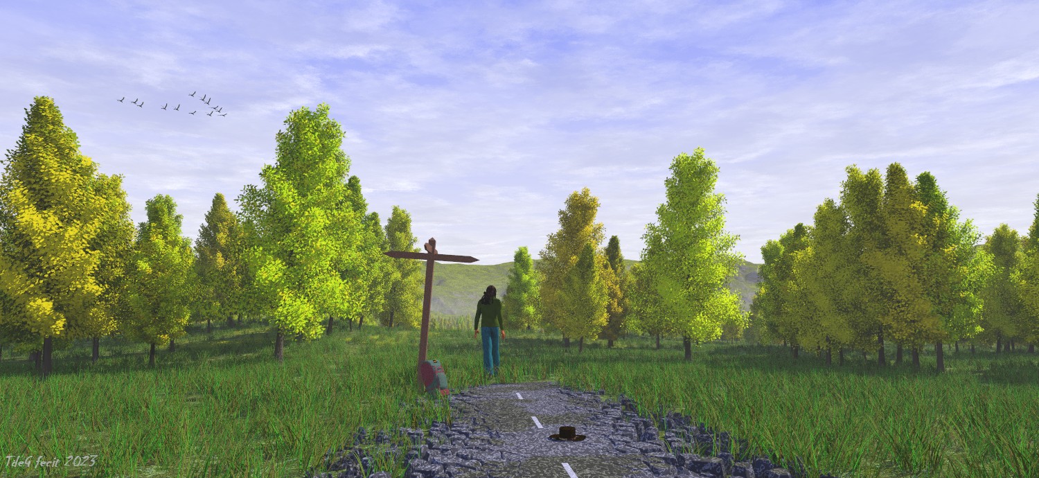

"...your ticket is no longer valid."
No reference here to the novel with the same (French) title by Romain
Gary, but to the ubiquitous warning signs at the exits of the /Metro/ in
Paris.
My last scene for this year (I worked on it on and off since last
August). Worth mentioning I guess: the broken-up road surface which is
based on the "Pattern Control Trick" by Rune Johansen which I add to
this message.
The trees are Arbaro mesh2 ones by Friedrich Lohmueller. I changed and
randomised the leaf textures. More - different - trees would have been
better but I was lazy ;-)
I wish you all a Merry and Peaceful Christmas!
Download 'beyond this point_10l.jpg' (320 KB) Download 'rj_pattern control trick.pov.dat' (7 KB)
Preview of image 'beyond this point_10l.jpg'

That's excellent Thomas, really like the composition, especially the woman
walking down the path next to the sign and the birds flying overhead! The forest
with the foggy hills in the distance looks very good and remind me of what you
would see in 2000s CGI movies. Have yourself a great Christmas, looking forward
to what you make next year!

I really love the style of this. The trees have an almost painterly
quality to them instead of looking ray-traced. How did you pull that off?

Josh English <Jos### [at] joshuarenglishcom> wrote:
> On 12/23/2023 4:32 AM, Thomas de Groot wrote:
> > My last scene for this year...
Oooh, I like this. Very beautiful and peaceful, Thomas.
That's exactly my impression too. Nicely done!

Thank you indeed, Josh, Kenneth, much appreciated.
The trees are very simple in fact, and basically the result of their
Arbaro origin which makes them very useful for large number use, more
especially in backgrounds. However, to break the monotony of a single
leaf colour, you need to introduce some variation.
For the Black Tupelo by Friedrich Lohmueller, the original is as follows:
// tree textures: ---------------------------------------
#declare Stem_Texture =
  texture{ pigment{ color rgb< 0.70, 0.56, 0.43>*0.25 }
           normal { bumps 1.00 scale <0.025,0.075,0.025> }
           finish { phong 0.2 reflection 0.00}
         } // end of texture
#declare Leaves_Texture_1 =
  texture{ pigment{ color rgbf< 0.27, 0.36, 0.0, 0.1>*1.4 }
           normal { bumps 0.15 scale 0.05 }
           finish { phong 1 reflection 0.00}
         } // end of texture
#declare Leaves_Texture_2 =
  texture{ pigment{ color rgbf< 0.25, 0.35, 0.0, 0.1>*1.4 }
         } // end of texture
#include "black_tupelo_15m.inc"
//#declare Tree_Height = black_tupelo_15_height; // // ~22.10  ft
// tree with leaves
#declare Black_Tupelo =
    union{
           object{ black_tupelo_15_stems
                   texture{ Stem_Texture }
           object{ black_tupelo_15_leaves
                   double_illuminate
                   texture{ Leaves_Texture_1 }
                   interior_texture{ Leaves_Texture_2 }
       scale 1/3
       rotate <0,40,0>
       translate<0,0,0>
     } // end of union
Black_Tupelo
I did not touch the Stem_Texture, nor did I touch the Leaves_Texture_2
which represents the underside of the leaves. I could have done so and
maybe I shall some day in the future to explore further possibilities.
So I first designed a leaf texture macro with randomizing possibilities:
#declare LeafPig =
pigment {
   granite
   color_map {
     [0.4 rgbf <RRand(0.3, 0.6, R), RRand(0.4, 0.7, R), 0.0, 0.1>*1.4]
     [0.7 rgbf <RRand(0.7, 0.6, R), RRand(0.4, 0.7, R), 0.0, 0.1>*1.4]
   scale RRand(0.1, 5, R)
   warp {turbulence 0.5}
#macro LeafTex ()
   pigment {LeafPig}
   normal {bumps 11.5 scale 0.0001}
   finish {specular 0.5 roughness 0.001 diffuse 0.8}
#end
And finally, after including the tree mesh file, a tree macro which
would take into account the randomizations in a trace loop (I used 1500
trees in the scene):
// tree with leaves
#macro Black_Tupelo ()
#local Tupelo =
union {
   object {
     texture {Stem_Texture}
   object {
     double_illuminate
     texture {LeafTex()}
     interior_texture {Leaves_Texture_2}
   scale 1/3
   rotate RRand(-179,180,R)*y
Tupelo
#end
And then it is only a matter of calling the macro repeatedly:
object {Black_Tupelo()
   scale SomeRandomScale
   translate SomeRandomTranslate
Improvements pending obviously ;-)
