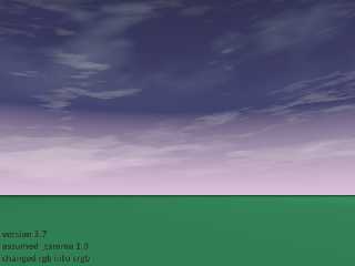

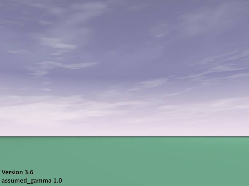

I started small and upgraded skies.inc, using the scene files provided
in scenes/textures/pigments/skies.
This brings up a couple questions, illustrated by the images below. In
this particular skies case, the scenes are typically labelled version
3.6 with assumed_gamma 2.2 (image: s_cloud1-1). Obviously, this cannot
be maintained in any self-respecting program promoting assumed_gamma
1.0! :-)
So, I changed assumed_gamma to 1.0 (image: s_cloud1-2) and while I was
at it, I experimented with Ive's transformation macro and Clipka's
colour boost macro, and thus achieved a version with srgb colours
(image: s_cloud1-3). These macros have been discussed  fairly recently
in these ng's.
The fundamental question is: What do we want?
Download 's_cloud1-1.jpg' (30 KB) Download 's_cloud1-2.jpg' (27 KB) Download 's_cloud1-3.jpg' (30 KB)
Preview of image 's_cloud1-1.jpg'
Preview of image 's_cloud1-2.jpg'
Preview of image 's_cloud1-3.jpg'

Just as a check, I rendered your example  SCloud_1  skysphere in v3.8xx
(assumed_gamma 1.0), and get identical results to your middle image. So far, so
good ;-)
However, I think that in v3.6 days and prior to that, there was a real
question-- not to mention a bit of confusion-- about using assumed_gamma 1.0 vs.
2.2. My own *guess* is that the  SCloud_1  colors were chosen in a 2.2 gamma
environment, and that the 1st image is probably what was intended. But that's
just my gut feeling; it's very difficult to 2nd-guess someone's intention (and
working gamma space) from so long ago...not to mention having to deal with any
unknown color/gamma problems that may have existed in older versions of POV-ray
itself, which may have confused the original author.
I actually think that both the 1st AND 2nd images are pleasing-- but not the
3rd, it's too washed out. PERSONALLY, I think the appearance of these specific
sky colors should be somewhere *between* gamma 1.0 and 2.2, ha. But apparently a
2.2 gamma was what the author had in mind...so image #1 would be my pick. As a
jumping-off point, I would suggest simply changing the specified colors to srgb
versions-- no fancy conversions-- and see what it looks like at assumed_gamma
1.0.

Hmm, they are not quite identical after all.
I thought I would do a side-by-side comparison of your v3.6 assumed_gamma 1.0
version to v3.8xx (I changed the "skies.inc" pigments back to their originals.)
There's a definite difference; I assume that it comes from the many
'under-the-hood' changes made to POV-ray since v3.6.
So it seems to be very difficult to determine (and update) what the author's
*original* visual intent was for these pigments.
Unless we all go back to using v3.6  :-O
Download 'version_comparison_at assumed_gamma_1.jpg' (84 KB)
Preview of image 'version_comparison_at assumed_gamma_1.jpg'

> I decided to try that myself, for the S_Cloud1 skysphere. It makes use of the
> pigments P_Cloud2 and P_Cloud3 in "skies.inc", so I changed those as well. All
> srgb colors now, with assumed_gamma 1.0.
> SO...the result is not what I was naively expecting; very different from the
> v3.6 assumed_gamma 2.2 version. Rather stark and ugly.
> I guess my 'simple' color/gamma conversion scheme is not the way to proceed...
This is strange. Attached find my version of the same which is
comparable to the original. Something is different apparently.
In skies.inc, I also changed the version to 3.7, which is also used in
the scene file.
Download 's_cloud1-4.jpg' (32 KB)
Preview of image 's_cloud1-4.jpg'
I have not tested it, but maybe your differences come from the fact that
you use version 3.8 here. I did not, from the principle that version 3.7
and/or 3.7.1 are the /last/ official versions of POV-Ray. As a start,
the includes should comply with those versions. Version 3.8 is beta and
may need more changes in future.
