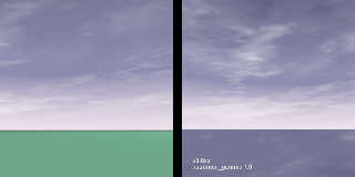

I am currently browsing through the include files to see if I can give a
meaningful contribution to their upgrading to 3.7+ standard. Over time,
some have been added to or partly upgraded, some are in am almost
pristine state going back to version 3.1.
I started small and upgraded skies.inc, using the scene files provided
in scenes/textures/pigments/skies.

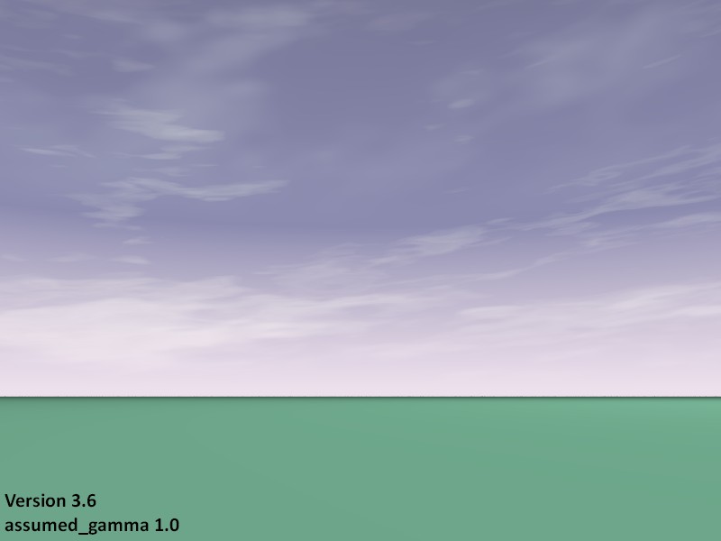

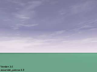

This brings up a couple questions, illustrated by the images below. In
this particular skies case, the scenes are typically labelled version
3.6 with assumed_gamma 2.2 (image: s_cloud1-1). Obviously, this cannot
be maintained in any self-respecting program promoting assumed_gamma
1.0! :-)
So, I changed assumed_gamma to 1.0 (image: s_cloud1-2) and while I was
at it, I experimented with Ive's transformation macro and Clipka's
colour boost macro, and thus achieved a version with srgb colours
(image: s_cloud1-3). These macros have been discussed  fairly recently
in these ng's.
The fundamental question is: What do we want?
Download 's_cloud1-1.jpg' (30 KB) Download 's_cloud1-2.jpg' (27 KB) Download 's_cloud1-3.jpg' (30 KB)
Preview of image 's_cloud1-1.jpg'
Preview of image 's_cloud1-2.jpg'
Preview of image 's_cloud1-3.jpg'
From: Kenneth
Subject: Re: Upgrading POV-Ray's include files - a few remarks
Date: 28 Feb 2021 08:15:00
Message: <web.603b97176dc18cedd98418910@news.povray.org>
Just as a check, I rendered your example  SCloud_1  skysphere in v3.8xx
(assumed_gamma 1.0), and get identical results to your middle image. So far, so
good ;-)

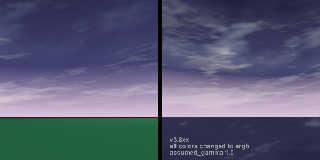

I decided to try that myself, for the S_Cloud1 skysphere. It makes use of the
pigments P_Cloud2 and P_Cloud3 in "skies.inc", so I changed those as well. All
srgb colors now, with assumed_gamma 1.0.
SO...the result is not what I was naively expecting; very different from the
v3.6 assumed_gamma 2.2 version. Rather stark and ugly.
I guess my 'simple' color/gamma conversion scheme is not the way to proceed...
Download 's_cloud1_1_srgb_colors_assumed_gamma_1.jpg' (99 KB)
Preview of image 's_cloud1_1_srgb_colors_assumed_gamma_1.jpg'

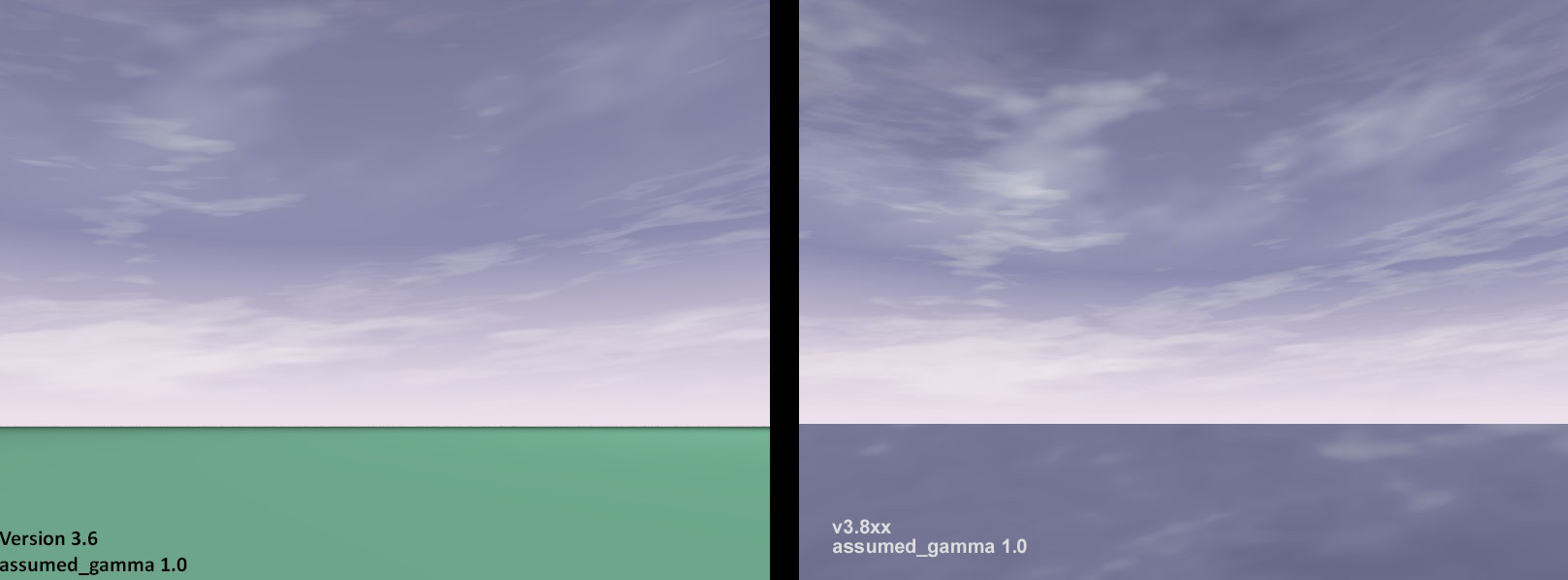

Hmm, they are not quite identical after all.
I thought I would do a side-by-side comparison of your v3.6 assumed_gamma 1.0
version to v3.8xx (I changed the "skies.inc" pigments back to their originals.)
There's a definite difference; I assume that it comes from the many
'under-the-hood' changes made to POV-ray since v3.6.
So it seems to be very difficult to determine (and update) what the author's
*original* visual intent was for these pigments.
Unless we all go back to using v3.6  :-O
Download 'version_comparison_at assumed_gamma_1.jpg' (84 KB)
Preview of image 'version_comparison_at assumed_gamma_1.jpg'
This is strange. Attached find my version of the same which is
comparable to the original. Something is different apparently.
In skies.inc, I also changed the version to 3.7, which is also used in
the scene file.
Download 's_cloud1-4.jpg' (32 KB)
Preview of image 's_cloud1-4.jpg'
I have not tested it, but maybe your differences come from the fact that
you use version 3.8 here. I did not, from the principle that version 3.7
and/or 3.7.1 are the /last/ official versions of POV-Ray. As a start,
the includes should comply with those versions. Version 3.8 is beta and
may need more changes in future.
