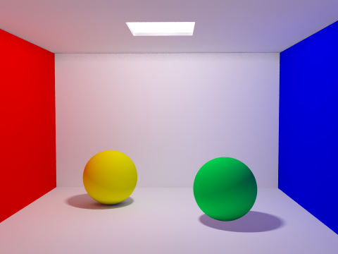

You'll notice something very unsettling about the green ball...
It's the other feature of my patch (currently engeniusly titled GE-POV) --
no_radiosity. This feature works in the same way as no_shadow or no_image
only it affects radiosity calculations.
What is the use of this you might ask? If you want to have a visible light
source as a bright ambient object but still have a conventional light
source inside and use radiosity, the light from the ambient object and the
conventional light source would conflict resulting in overexposed lighting.
This effect is especially dramatic when you use really bright objects (eg.
ambient 10) to create visible "dings" on objects as opposed to the
unrealistic specular component. Using no_radiosity on the ambient object
for the visible light source would fix this issue completely.
no_radiosity is used not only on the green ball but also on the ceiling
light ambient object to prevent the double lighting conflict issue.
PS. dispersion_jitter, the first feature of GE-POV is demonstrated in my
guessing game article posted yesterday.
Download 'no_radiosity-test.png' (76 KB)
Preview of image 'no_radiosity-test.png'

  Does this also result in a decreased render time if used on Isosurfaces?
I have a scene that uses Iso-rocks, which kill the render time if radiosity
is used.  The rocks themselves get little to no benefit from the radiosity
calculations, so being able to label them with no_radiosity would be ideal
if that negated the increased render time.
Rich Allen

It may, but the no_radiosity keyword means that the no_radiosity object
will not affect the radiosity of other objects. In the scene I posted, the
green ball had no_radiosity but it still had radiosity lighting. The
difference it made was that the no_radiosity green ball had no little dark
shadow on the ground like the yellow ball did. no_radiosity should prevent
self-casting radiosity (similar to self-casting shadows) which may speed up
your isosurface render and the rendering of the surrounding objects should
have a slight speed increase. Just keep in mind the funny shadows that
no_radiosity objects have. (like the green ball)
Another speed issue is that the current binary (compiled with Visual C++ 6
Pro) runs noticeably slower than the original POV compiled using the Intel
compiler. I'll try and address this when I make a public release. I'll be
sure to post the source too.
> object will not affect the radiosity of other objects. In the scene I
> posted, the green ball had no_radiosity but it still had radiosity
> lighting. The difference it made was that the no_radiosity green ball
> had no little dark shadow on the ground like the yellow ball did.
> no_radiosity should prevent self-casting radiosity (similar to
> self-casting shadows) which may speed up your isosurface render and
> the rendering of the surrounding objects should have a slight speed
> increase. Just keep in mind the funny shadows that no_radiosity
> objects have. (like the green ball) Another speed issue is that the
> current binary (compiled with Visual C++ 6 Pro) runs noticeably slower
> than the original POV compiled using the Intel compiler. I'll try and
> address this when I make a public release. I'll be sure to post the
> source too.
Sounds promising, I'm looking forward to seeing what it can do.
Rich
