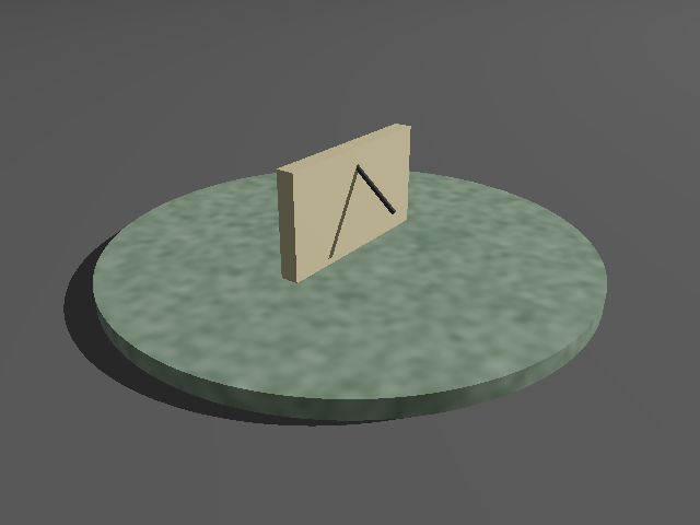

Hello,
Little brain teaser : the attached image is part of an animation that
simulates a simplified sundial. In order not to overload the image, the
shadow of the sundial has been removed with the "no_shadow" attribute.
But not for the gnomon to get the "time". As you can see, its shadow is
also projected on the ground "through" the wall.
So, how to remove this shadow on the floor but keep the shadow on the wall ?
Kurtz le pirate
Compagnie de la Banquise
Download 'cadransolaire109.jpg' (46 KB)
Preview of image 'cadransolaire109.jpg'
From: William F Pokorny
Subject: Re: Sundial and shadow problem
Date: 3 Jan 2021 08:08:49
Message: <5ff1c1e1$1@news.povray.org>
On 1/3/21 5:36 AM, kurtz le pirate wrote:
> Hello,
> wall ?
If the scene is simple - like what you shown - you might be able to dial
back on the scene's max_trace_level until the unwanted shadow disappears.
There is also the projected_through feature for lights. If you put a
special object on the back side of the no shadow shape (or maybe just
the gnomon) for that projection_through shape it should be the shadow
disappears. Off the top of my head a little unsure about how light
attenuation (if any) acts with the feature.
Hmm, wonder if you could just project through no shadow shape... Would
the shadow on it still show up normally?
Might also be seam issues to fight between any inserted
projected_through shape and the seen ones if that shape is in the scene.
IIRC. You need not otherwise insert a projected through shape in scene.
Meaning it can be defined and then referenced only by the
projected_through keyword in the light. In that way it affects nothing
else in the scene except being a local light portal into the scene for
the given light definition.
Bill P.

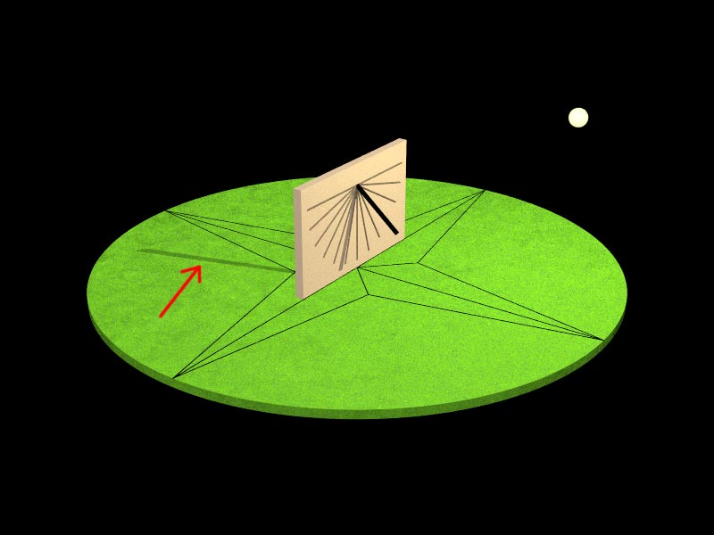

From: kurtz le pirate
Date: 6 Jan 2021 11:56:11
Message: <5ff5ebab$1@news.povray.org>
On 04/01/2021 16:57, Kenneth wrote:
> After reading the various suggestions here, I experimented with different
> set-ups, and finally found one that works. It uses two light sources: a
> shadowless one in a light_group with the large horizonal disc, and another light
> for everything else. The no_shadow flag is not needed in any of the objects.
Interesting approach. I'm trying this out.
Thanks Kenneth
Kurtz le pirate

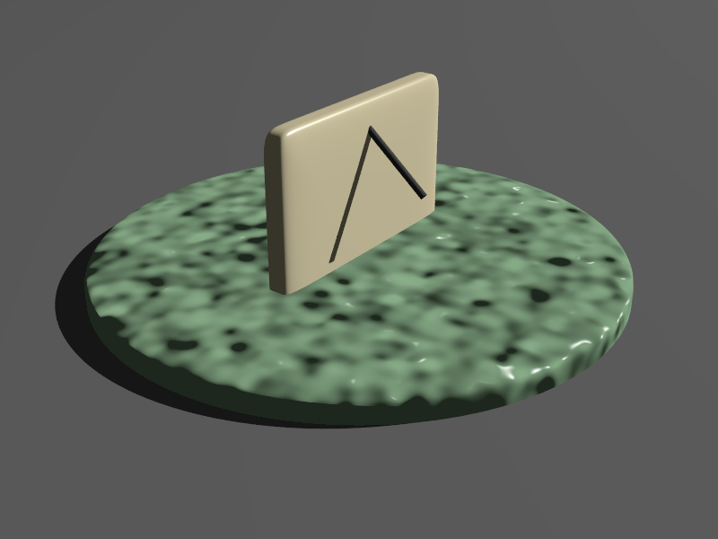

From: Subclick
Date: 6 Jan 2021 22:01:49
Message: <87czyhtppn.fsf@sp.am>
"Kenneth" <kdw### [at] gmailcom> writes:
I’ve tried that out, too.  With a shadowless light source, you don’t get
highlights.  You can remedy this by setting “no_shadow” for both the
wall and the gnomon, and putting the former in a light group with a
negative-intensity light source projected through the gnomon.
Download 'sundial.mpg' (658 KB) Download 'us-ascii' (1 KB)
Date: 7 Jan 2021 13:17:12
Message: <5ff75028$1@news.povray.org>
You can see the result with Kenneth's method here:
<http://louisbel.free.fr/wip/sundial.html>
Very close to Subclick
LOL
Kurtz le pirate
From: Kenneth
Date: 8 Jan 2021 11:55:00
Message: <web.5ff88e1a346ceddfd98418910@news.povray.org>
> > set-ups, and finally found one that works...
> I've tried that out, too.  With a shadowless light source, you don't
> get highlights.  You can remedy this by setting no_shadow for both
> the wall and the gnomon, and putting the former in a light group
> with a negative-intensity light source projected through the gnomon.
That is a really clever solution, and a good improvement. I didn't notice the
lack of highlights in my own test.
At first, I thought that the negative light_source would 'invert' the color of
the wall object; but that's not the case.
Here's my own demo code. (Note that the light_group requires global_lights ON).
#default{finish{ambient .04 diffuse .8}}
camera {
  perspective
  location  <-4, 2.5, -3>
  look_at   <0, 0,  0>
  right     x*image_width/image_height
  angle 40
// light_source A-- main
light_source {
  0*x                  // light's position (translated below)
  color rgb <1,1,1>    // light's color
  translate <20, 20, -20>
plane{y,0 pigment{rgb .2}}
// large horizontal disc
superellipsoid{ <1,.2> rotate 90*x scale 1.5*<1,.1,1>
texture{
pigment{ rgb .5*<.6,1,.6>
       finish{phong .8}
       normal{bumps .7 scale .1 bump_size 1}
// --- sundial ---
#declare GNOMON =
cylinder{0,-.55*z,.02
pigment{rgb <.8,.2,.2>}
rotate -40*x
translate .9*y
no_shadow
object{GNOMON}
light_group{
// light_source B-- same position as light_source A
light_source {
  0*x
  color rgb -1 // NEGATIVE light
  projected_through{GNOMON}
// vertical wall
superellipsoid{<.1,.3> scale <.7,1,.08>
texture{
pigment{rgb <.95,.85,.55>}
finish{phong 1}
no_shadow
global_lights on
} // end of light_group
Download 'sundial_shadow_solution_2.png' (119 KB)
Preview of image 'sundial_shadow_solution_2.png'
Date: 8 Jan 2021 13:26:07
Message: <5ff8a3bf$1@news.povray.org>
hum, hum... negative light...
why not, just had to think of it.
Kurtz le pirate
