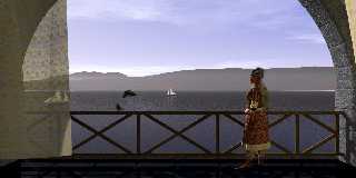

In Norbert Kern's Bluebell Wood discussion, there was mention of the use
of basckside illumination by Alain and myself. Here is an example of its
use, a 2019 update of a 2012 scene from the Iskander/Gancaloon universe.
Backside illumination was applied to the curtains.
Download 'the sultana - her portrait_2019_02b.jpg' (164 KB)
Preview of image 'the sultana - her portrait_2019_02b.jpg'
> Thomas
I have not yet used backside illumination, so I'm curious as to what I should
see in your scene. I assume that the curtain objects themselves are
semi-transparent(?), and that the effect is seen as the small triangular light
patches on the left-side curtain?
So many tricks to learn, so little time ;-)
From: MichaelJF
Subject: Re: Backside illumination
Date: 22 Nov 2020 11:24:39
Message: <5fba90c7$1@news.povray.org>
Am 22.11.2020 um 16:22 schrieb Kenneth:
>> Thomas
As all I know, backside illumination and semi transparency is not the
same. Semi transparency can be achieved by using an alpha-channel within
a png-based texture. Backside illumination is a special calculation of
diffuse reflections.
I used
      finish { diffuse albedo 0.55,0.4 }
in this image:
      http://news.povray.org/5f2ae26d%40news.povray.org
at all of the balloons.
As I understand it, it means that 55 % of the light from front
lightsources is diffuse reflected and that 40 % of light from sources at
the backside of an object can pass through.
Best regards
Michael
>>> Thomas
>> should
>> triangular light
> I used
> in this image:
> Best regards
> Michael
You understand correctly, with a little precision : The part that pass
through does it diffusely.

Op 22/11/2020 om 16:22 schreef Kenneth:
>> Thomas
Michael and Alain give the answer.
You will see the effect if you put two versions side by side, one with,
one without the use of backside illumination (used indeed with a
semi-transparant texture): without it, the aspect will be much more dull.
In my image, it it just the "shininess" of the curtain parts in sunlight
that is increased making the whole more attractive but also more natural
imo.

Thanks to all for the tips and explanations. Backside illumination is a feature
that I've always wanted to try, but I have not yet made a scene that would take
advantage of it.
> imo.
Ah, I see.
And about those "small triangular patches" I mentioned: I see now that they are
the sails of another boat, behind the curtain! Duh. Sorry for the confusion.

Op 24/11/2020 om 02:00 schreef Kenneth:
LOL. I was puzzled about that indeed.
