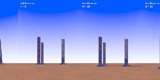

I need the help of a Matrix Master.
I am a regular user of Doctor John's FieldCam macro which enables
slanting architecture to look straight. It simulates the professional
cameras where this adjustment can be done through the lenses.
The macro works perfectly... as long as your scene camera is situated
about the origin of the Y-axis. Recently, I have been working on scenes
where the camera is situated at about y=170.00, and strange things
happen: the camera is moved upwards and forwards, the more so as
elevation gets greater.
To illustrate this, I have attached a little test scene and an image
showing the problem. H is the value for the elevation of the scene
elements along the Y-axis.
I can correct this by adding a translate after the "NoFall" transform in
the camera code, but I assume that this could better be done within the
"NoFall" matrix. I have not the slightest idea how to do this.
Thanks for any help.
Download 'dj_fieldcam_test.pov.txt' (7 KB) Download 'dj_fieldcam_testx.jpg' (66 KB)
Preview of image 'dj_fieldcam_testx.jpg'

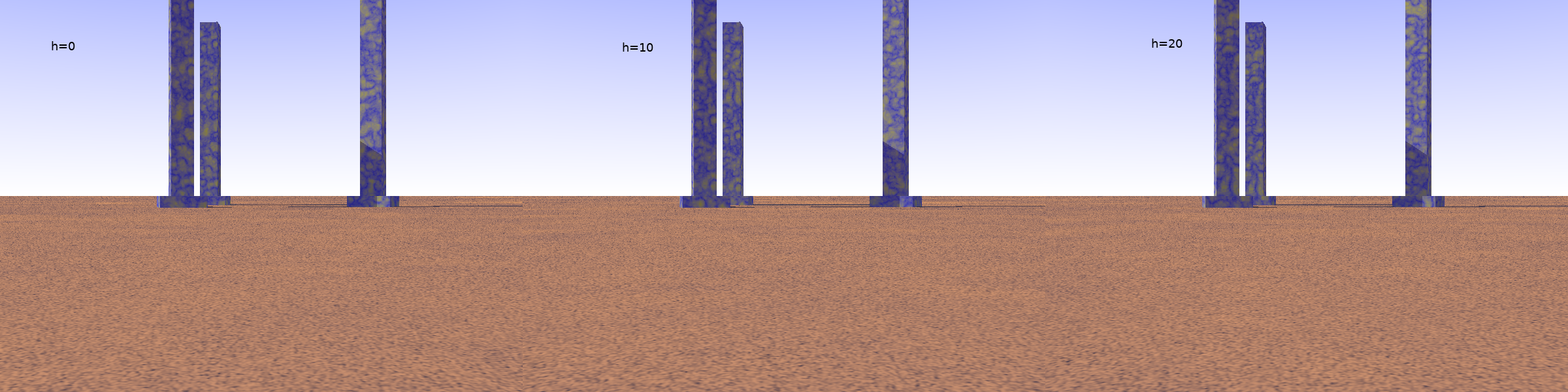

Hi Thomas,
I have never used Doctor John's macro but a quick look at it make me think it is
not supposed to work if the Y coordinates of you camera location and look_at do
not have the same value.
Changing your script as follow:
#case (2)
  #declare CamHeight    = 1;
  #declare CamLoc       = <2000.0, H+CamHeight, -2400.0>;
  #declare CamLookAt    = <2000-100, H+CamHeight, -2400+100>;
#end
and testing with the same H values as you example and FC on gives me correct
images (as far as I understand), cf attachment.
I also don't know if you really need to have a look_at at a different height...
I hope this will help you.

From: BayashiPascal
Subject: Re: Doctor John - FieldCam conundrum
Date: 16 Nov 2020 08:50:07
Message: <web.5fb28346ed460f77108b22750@news.povray.org>
Sorry, after sending my previous message and looking at yours again I think I
have misunderstood what this macro does.
Sorry for the useless post...
Date: 17 Nov 2020 02:32:52
Message: <5fb37ca4@news.povray.org>
Op 16/11/2020 om 14:48 schreef BayashiPascal:
LOL! No Problem; your attention to this is nonetheless appreciated.
Date: 17 Nov 2020 02:34:38
Message: <5fb37d0e@news.povray.org>
Op 16/11/2020 om 16:03 schreef jr:
> hi,
> that disqualifies me immediately.  :-)  however, I did write a simple calculator
> UI to help me see how a change to the matrix affects a point.  maybe it and or
> the thread will be of use.
<http://news.povray.org/povray.binaries.misc/thread/%3Cweb.5c226659252b677e48892b50%40news.povray.org%3E/>
> one pitfall: the range of (matrix) values is limited to range -10.0 to 10.0.  if
> you need larger values, edit the script in line 11.
Frankly, I do not know what to do with this ;-}  A file with a .tk
extension... what program runs this?
Date: 17 Nov 2020 03:03:18
Message: <5fb383c6@news.povray.org>
Op 16/11/2020 om 23:12 schreef Bald Eagle:
> I think it's actually accomplished using the adjustable film plane of the view
> camera.
> The 3-book series on negative, print, and camera by Ansel Adams ought to
> describe it fully and clearly.
> <hint> One might think there are PDF's of those available...   ;) </hint>
In a dim, prehistoric past, I actually played a bit with a technical
camera which could do this: it was a matter of sliding up and/or down
the lens and/or the film plane indeed. Additionally, one could rotate
those horizontally. Great toys for photographing (tall) architecture!
But, back to topic.
> I don't really understand what I'm looking at in the scene, nor how the macro
> corrects the one column and not the others...
 From left to right:
1 - a scene not using FC, camera pointing upwards, base level at y=0.0
2 - same scene using FC. The pillars are now straight as far as the
observer is concerned. Base level still at y=0.0
3 - same scene, again using FC, but now with a base level of y=10.0
4 - idem, base level is y=20.0
Look again: all three pillars are corrected!
