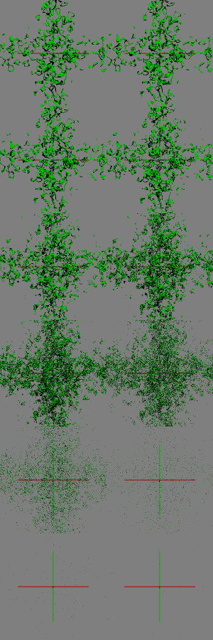

In the attached image created a set up which shows the distribution
moving from a center of 0.25 and range of 0.5 to a center of about 2.0
and a range of 4 as you approach an omega of one. Other settings seem
not to matter much to the distribution, except as looks OK to my eye.

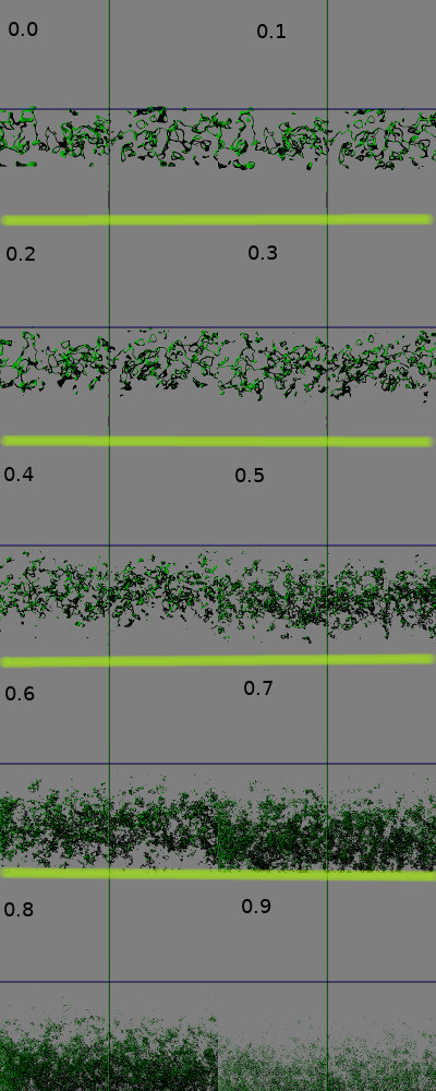

First, we are not as bad off as I first guessed. All of the vector
related turbulence uses DTurbulence which uses DNoise() and these
already do return a 0.0 centered in a -1 to +1 range. See the attached
image.

Download 'storyvectorturbulence.png' (306 KB)
Preview of image 'storyvectorturbulence.png'

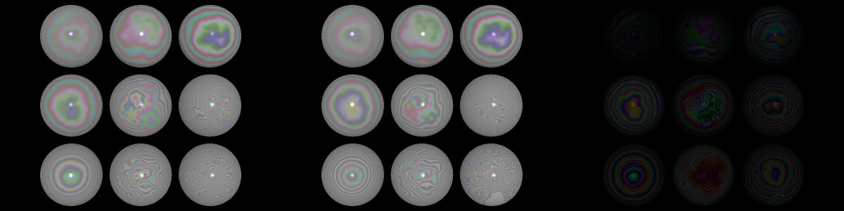

Attached an image up the updated irid code running with the fixed
Turbulence(). I also added the clamp to prevent the film thickness from
going below 0.0 and one of our demo scenes hits this clamp. See the
lower right sphere in the middle set. Less colorful result but I think
correct. There is no film there.
I also tried for a matching fudge factor to match the breadth of the old
Turbulence() distribution. Cannot match previous precisely, but not bad
in my view.
Bill P.

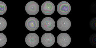

Download 'iridturbulencedistfixandclamp.jpg' (72 KB)
Preview of image 'iridturbulencedistfixandclamp.jpg'

> The finish irid feature ....
> ... This feature has some
> other issues like lack of ability to scale relative to the incoming
> coordinates which will make it tricky to get something which always
> works with respect to scene dimensions.
I would very much like a function that "scales space" prior to passing world
space cooordinates into functions.
Having had to grapple with that issue, I'm wondering what the best
implementation of that would be.  I'm also curious what your approach is when
you use functions.
I haven't figured out how to graph a function with the native (x,y,z) - so I
define all my functions with capitals, which just act as containers for the
lowercase I pass to it on invocation.
Then I can graph them using a #for (X, 0, tau) loop ....
Yeah - iridescence seems ... "special".
Using Iridescence
"Iridescence is what we see on the surface of an oil slick when the sun shines
on it. The rainbow effect is created by something called thin-film interference
(read section Iridescence for details). For now let's just try using it.
Iridescence is specified by the irid statement and three values: amount,
thickness and turbulence. The amount is the contribution to the overall surface
color. Usually 0.1 to 0.5 is sufficient here. The thickness affects the busyness
of the effect. Keep this between 0.25 and 1 for best results. The turbulence is
a little different from pigment or normal turbulence. We cannot set octaves,
lambda or omega but we can specify an amount which will affect the thickness in
a slightly different way from the thickness value. Values between 0.25 and 1
work best here too."
> I think
given numerical accuracy there should be some >=0 clamping to not
sometimes get negative thicknesses
maybe abs() ?
> Not tested to confirm, but the fog features using turbulence I suspect
> are in bad shape. There is a min(1.0,Turbulence(..)... bit used a ouple
> places which I believe will make it very hard to get much turbulence
> given the distribution center is way the heck out at 4.0 with defaults!
yeah wow - that's WAY out there...

I agree, more inbuilt ability to see the value distributions is needed.
It would, over the years, have saved me huge chunks of time - especially
where POV-Ray has been wrong! Not yet quite sure how to approach it in a
practical sense. By adding functions like f_turb() I am making
accessible what's not been, but that's just a piece of what is needed.
> I'd say that from an isosurface perspective, it would be MOST helpful in
> determining where to set the threshold, or what to subtract from the equation in
> order to get a zero-value surface.
I think pretty much always have the threshold at 0.0 for best
interoperability of functions. Subtract or add to the function to get to
a zero values surface as you say. Aside: I think putting out a bunch of
canned functions with thresholds all over the place mostly makes things
more difficult for typical users. I get why mathematicians would think a
non-zero threshold capability a good idea, but in a tool like POV-Ray
it's mostly a bad one.
Yep, agree.
Yep...
