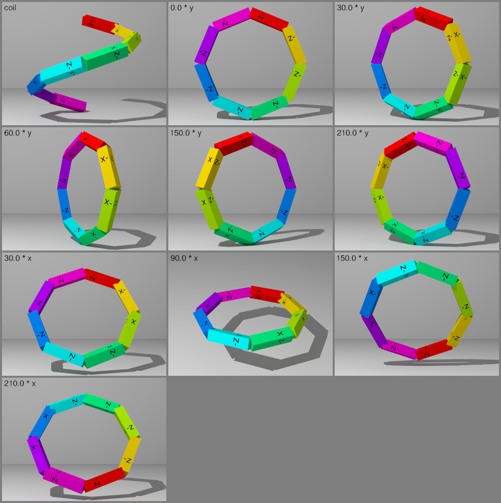

I want to string objects together in a chain.  Each segment is initially
defined vertically, then rotated using macro Reorient_Trans() before
being translated into position.
When I string the objects together, they usually end up rotated with
respect to each other.  Since the objects all start out vertical, a
simple counter-rotation about y should align them.  The question is, by
what amount?  I've been wrestling with this problem for days, and I am
utterly stumped.  I even tried bypassing Reorient_Trans() altogether,
the result being boxes scattered seemingly randomly all over the place.
Is there a general solution to this problem?
This is the code for the images in montage reorient-twist-pbi.jpg:
--------------------[BEGIN CODE]--------------------

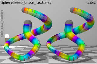

Such a solution would have obvious application toward uv-textured sphere
sweeps.  Image test_sswp_textured10.jpg shows the suboptimal results
when the cylindrical warp is transformed with Reorient_Trans() without
any counter-rotation.  (Filling in those gray gaps is a separate issue
that I'm not inclined to address while I have this more fundamental
unsolved problem.)
> sweeps.
sphere_sweep have been uv-mapped (in hgpovray).
Basic approach: an initial vector and the first 2 points define the
origin for one uv axis, as two normals. It's arbitrary anyway, but being
predictable and adjustable is better when using uv-mapping.
(the two normals and the oriented segment make a local 3D reference
system that is going to slide along the sphere sweep)
On each successive point, compute the plane in which the rotation is
occurring (3 poins, one plane) and propagate the normals on next segment
using the "natural" rotation in the plane. Repeat until there is no more
point.
Alas, currently in hgpovray38, sphere_sweep is not marked as UVMeshable,
so you cannot read back the data from uv values using uv_min, uv_max,
uv_vertex and uv_normal (also extension of hgpovray38).
Nevertheless, you can use trace() as usual to retrieve the uv value if
you known how to have an intersection (hint: middle of a segment and
trying two perpendicular vectors, for linear sphere sweep; more
difficult for the other types)

From: Bald Eagle
Subject: Re: How to untwist Reorient_Trans?
Date: 10 Jun 2019 17:10:01
Message: <web.5cfec70da79162ca4eec112d0@news.povray.org>
> what amount?
I'm assuming that you want to rotate them around y the opposite way before
applying the macro which will then cancel your pre-rotation.
Here's my logic, untested.
The transforms in Reorient_Trans() are matrix transformations that have elements
that are cos, sin and -sin of the angle in radians.
Just intercept the values of that before they are used, convert them to degrees,
(make sure they all match), and then rotate your object around -y by that
amount.
I think just uncommenting the two rotate directives below ought to do it.
