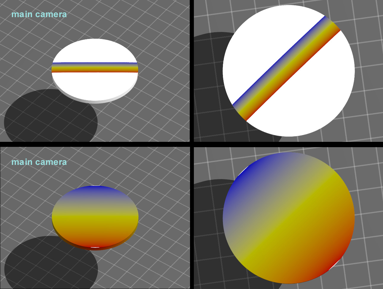

So, I am using this macro to generate chromadepth textures:
// this script assumes the depth effect is *linear* from near to far,
// which may not be the case
// red, white, blue
#macro MakeChromadepthTextureCameraRWB(CameraLocation, CameraLookAt)
	#local iMax = 240;
	pigment
		spherical
		color_map
			[0.0 color srgb <0,0,1>]
			[0.5 color srgb <1,1,1>]
			[1.0 color srgb <1,0,0>]
//	finish
//		ambient 1
//		diffuse 0
	scale vlength(CameraLocation - CameraLookAt) * 2
	translate CameraLocation
#end
The texture is centered on the camera location, and stretches to a point
opposite the model. The problem is that the model ends up mostly white,
with only touches of blue and red, as you can see in the attached image.
I think the texture should hug the model a bit closer, so that more red
and blue are visible. The problem is that the texture is centered on the
camera instead of the model, or I could just scale the texture a bit
smaller.
What method can I use to fix the texture? I know what the model's center
point and bounding box are.
Thanks.
Mike
Download 'wrapper_showcase.jpg' (225 KB)
Preview of image 'wrapper_showcase.jpg'

From: Kenneth
Subject: Re: Chromadepth scaling to model
Date: 17 Feb 2018 11:40:01
Message: <web.5a885a2fb61f5657a47873e10@news.povray.org>
Just from sketching some graphical ideas on paper, I think there are probably
two problems involved-- although I hope that I'm understanding the intended use
of your macro!
The spherical pattern by default occupies a sphere space of radius 1.0. The
macro is finding the distance from the *center* of that sphere to the center of
your model (I'm guessing that's what you have in mind, anyway.) Then the camera
is translated to the center point of the scaled-up pattern. So far, the idea
sounds OK. But the spherical pattern's outer 'surface' is already 1 unit away
from the camera location to start with-- so I'm wondering how far that 'new'
outer surface extends to. And it looks like the X2 multiplier is making it much
larger than it needs to be.(?)
If that's the case, then the color_map entries are also getting 'stretched out'.

From: Bald Eagle
Date: 17 Feb 2018 14:40:01
Message: <web.5a88844cb61f56575cafe28e0@news.povray.org>
I think what you want to do is center the texture on the model, and scale it
according to the bounding box.   That way you get the full range of colors on
the model.
If you're actually trying to somehow encode the distance from the camera into
the texture, then clipka posted a way to do that recently in response to
someone's query.
In any event, include a plane in the scene, and texture that with your color-map
so you can see the whole pattern and how it behaves in relation to where your
object is.
From: Mike Horvath
Date: 17 Feb 2018 15:24:28
Message: <5a888f7c$1@news.povray.org>
I ended up using this:
// This script assumes the depth effect is *linear* from near to far,
which may not be the case.
// red, white, blue
#macro MakeChromadepthTextureCameraRWB(CameraLocation, CameraLookAt,
FudgePercent)
	#local FudgeMin = FudgePercent/100/2;
	#local FudgeMax = 1 - FudgePercent/100/2;
	pigment
		spherical
		color_map
			[FudgeMin	color srgb <0,0,1>]
			[FudgeMax	color srgb <1,0,0>]
//	finish
//		ambient 1
//		diffuse 0
#end
I can shrink and grow the texture using the FudgePercent parameter. I
think this is as close as I'll get.
Mike

From: Kenneth
Date: 17 Feb 2018 17:35:00
Message: <web.5a88ac0eb61f5657a47873e10@news.povray.org>
The idea looks interesting! And your model proves that it works.
In the interim time, I had a brainstorm. I had to work it out graphically on
paper, discarding one idea after another, but finally came up with a solution.
It's more complex than your's, but it doesn't have any fudge factor that I know
of. I have to describe it in words; if you can put it into an equation, kudos
;-) (I'm really tired and the ol' brain is fizzling out...)
1) Choose a camera position; it can be anywhere. (So can the object.)
2) Get the bounding-box coordinates of the object-- the farthest and nearest
corner locations, whatever they happen to be.
3) find vlength from camera to nearest bounding-box corner. Call it L-1
4) find vlength from camera to farthest B-B corner. Call it L-2
5) L-1 / L-2 = S   This will be somewhere between 0.0 and 1.0-- it depends on
how far your object is from the camera. The farher apart, the larger this will
be.
6)  Then, (1.0 - S) = T
7) Using T, change your spherical color_map's original 0.0-to-1.0 index values
to a more 'squased' version, closer to the outer spherical 'surface'. (And don't
scale it up yet.)
     [0.0 BLUE] // outer radius of spherical pattern
     [.5*T WHITE]
     [T  RED ]  // what used to be the center point of the pattern; now father
                // out toward edge
8) Now scale-up the spherical pattern by L-2. That *should* put the outer
edge of the BLUE at or near the object's farthest bounding-box corner; and RED
should begin at or neat the closer corner.
CAVEAT: No guarantees are implied... :-P

From: Kenneth
Date: 19 Feb 2018 11:15:00
Message: <web.5a8af675b61f5657a47873e10@news.povray.org>
So, I finally coded-up my idea, and it does indeed put the 'center' color of the
color_map across the center of the object. That part works, at least. But the
color pattern's 'limits' on the object have a problem: the color spread doesn't
extend all the way across. So far, after several days of trying to figure out
why, I still don't have a clue. I tried changing *every* parameter in the code,
but no luck-- although there's probably a hidden 'clue' in those trials.
So, I had to resort to some fudge-factors as well :-/  I eventually found one
set of those that actually works consistently... so the overall scheme is
workable after all. Only two 'fudging' values need changing, by eye; they depend
on relative distance between object and camera, and on the scale of the object.
I don't know if those values change linearly, exponentially, or what.
Essentially, they increase the distance between the object's found  bounding-box
coordinates, *as if* the object is larger. A clue?
The first image is the result of the initial code idea; the second is with the
fix. The fudge factors indicate that the 'squashed' color_map values depend on
some kind of so-far-unknown variable. There HAS to be an answer; I just haven't
found it yet :-(
The camera and object positions are arbitrary, as is object scale, and can be
anything... within reason ; there can be precision issues behind-the-scenes. See
the #debug messages.
#declare CAM_LOCATION = <32, 56, -35>*3; // easily change location using the
// (positive) multiplier (actually changes it between location <0,0,0> and
// farther out)
#declare OBJECT_CENTER_LOCATION = <3,6,22>*1.0; // ditto
#declare OBJECT_SCALE =  2.7;
#declare CAM_ANGLE = 3; // 0.9 Just to easily change the camera angle when
// you change object scale or camera/object distance.
// main camera
camera {
  perspective
  location  CAM_LOCATION
  look_at   OBJECT_CENTER_LOCATION
  right     x*image_width/image_height  // aspect
  angle CAM_ANGLE
// OR, separate camera, 'un-coupled' from code, looking from another location
// way above
camera {
  perspective
  location  <0,500,0>
  angle CAM_ANGLE
light_source {
  0*x
  color rgb .7
  translate <40, 80, 30>
background{rgb .1}
// stripes are 1-unit apart
plane{y,0
    pigment{
           average
           pigment_map{
                [ 1 gradient x
                 color_map{
                     [.05 rgb .8]
                     [.05 rgb .3]
                [ 1 gradient z
                 color_map{
                     [.05 rgb .8]
                     [.05 rgb .3]
           scale 1
#declare OBJECT_1 =  // does not need to be centered on origin when made
// box{0,<1,.1,1> scale OBJECT_SCALE
// rotate 40
// translate OBJECT_CENTER_LOCATION
// OR...
cylinder{-.05*y,.05*y 1
   scale OBJECT_SCALE
   translate OBJECT_CENTER_LOCATION  // yes, PRE-translated -- it's part
                                     // of the idea
#declare NEAR_CORNER = min_extent(OBJECT_1);
#declare FAR_CORNER = max_extent(OBJECT_1);
#declare L_1 = vlength(NEAR_CORNER - CAM_LOCATION) - 0;  // or - 1.68 FUDGE
// FACTOR
#declare L_2 = vlength(FAR_CORNER - CAM_LOCATION) + 0;  // or + 1.44 FUDGE
// FACTOR
#declare S = L_1/L_2;
#declare T = 1.0 - S;
#declare SPHERE_PIG =
pigment{
     spherical
     color_map{
          [0 rgb 3]
          [0 rgb <0,0,1>] // BLUE -- outside edge of pattern
          [0.5*T rgb <1,1,0>] // YELLOW
          [T rgb <1,0,0>] // RED
          [T rgb 3]
      // to experiment with...
      color_map{
          [0 rgb 3]
            [.48*T rgb <0,0,1>]
            [.48*T rgb <1,1,0>]
            [.52*T rgb <1,1,0>]
            [.52*T rgb <1,0,0>]
          [T rgb <1,0,0>]
          [T rgb 3]
      scale L_2
      translate CAM_LOCATION
object{OBJECT_1// already translated
     pigment{SPHERE_PIG} // ditto
#debug concat("\n", "object SCALE = ",str(OBJECT_SCALE,0,9),"\n")
#debug concat("\n", "distance to bounding box NEAR corner (L_1) =
",str(vlength(NEAR_CORNER - CAM_LOCATION) - 0,0,9),"\n")
#debug concat("\n", "distance to bounding box FAR corner (L_2) =
",str(vlength(FAR_CORNER - CAM_LOCATION) - 0,0,9),"\n")
#debug concat("\n", "L_1/L_2 = ",str(L_1/L_2,0,9),
"  (should never go over 1.0 !)","\n")
#debug concat("\n", "T = ",str(T,0,9),"\n")
Download 'chromadepth_example.jpg' (225 KB)
Preview of image 'chromadepth_example.jpg'
> found it yet :-(
Awesome! Let us know when you figure out why the fudge factor is needed.
If you flip over the disc you'll see that the second fudge factor is too
small. You need to set it to + 1.65 instead of + 1.44.
Mike
