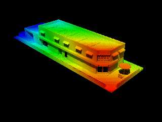

So, I am using this macro to generate chromadepth textures:
// this script assumes the depth effect is *linear* from near to far,
// which may not be the case
// red, white, blue
#macro MakeChromadepthTextureCameraRWB(CameraLocation, CameraLookAt)
	#local iMax = 240;
	pigment
		spherical
		color_map
			[0.0 color srgb <0,0,1>]
			[0.5 color srgb <1,1,1>]
			[1.0 color srgb <1,0,0>]
//	finish
//		ambient 1
//		diffuse 0
	scale vlength(CameraLocation - CameraLookAt) * 2
	translate CameraLocation
#end
The texture is centered on the camera location, and stretches to a point
opposite the model. The problem is that the model ends up mostly white,
with only touches of blue and red, as you can see in the attached image.
I think the texture should hug the model a bit closer, so that more red
and blue are visible. The problem is that the texture is centered on the
camera instead of the model, or I could just scale the texture a bit
smaller.
What method can I use to fix the texture? I know what the model's center
point and bounding box are.
Thanks.
Mike
Download 'wrapper_showcase.jpg' (225 KB)
Preview of image 'wrapper_showcase.jpg'

From: Mike Horvath
Subject: Re: Chromadepth scaling to model
Date: 17 Feb 2018 15:24:28
Message: <5a888f7c$1@news.povray.org>
I ended up using this:
// This script assumes the depth effect is *linear* from near to far,
which may not be the case.
// red, white, blue
#macro MakeChromadepthTextureCameraRWB(CameraLocation, CameraLookAt,
FudgePercent)
	#local FudgeMin = FudgePercent/100/2;
	#local FudgeMax = 1 - FudgePercent/100/2;
	pigment
		spherical
		color_map
			[FudgeMin	color srgb <0,0,1>]
			[FudgeMax	color srgb <1,0,0>]
//	finish
//		ambient 1
//		diffuse 0
#end
I can shrink and grow the texture using the FudgePercent parameter. I
think this is as close as I'll get.
Mike

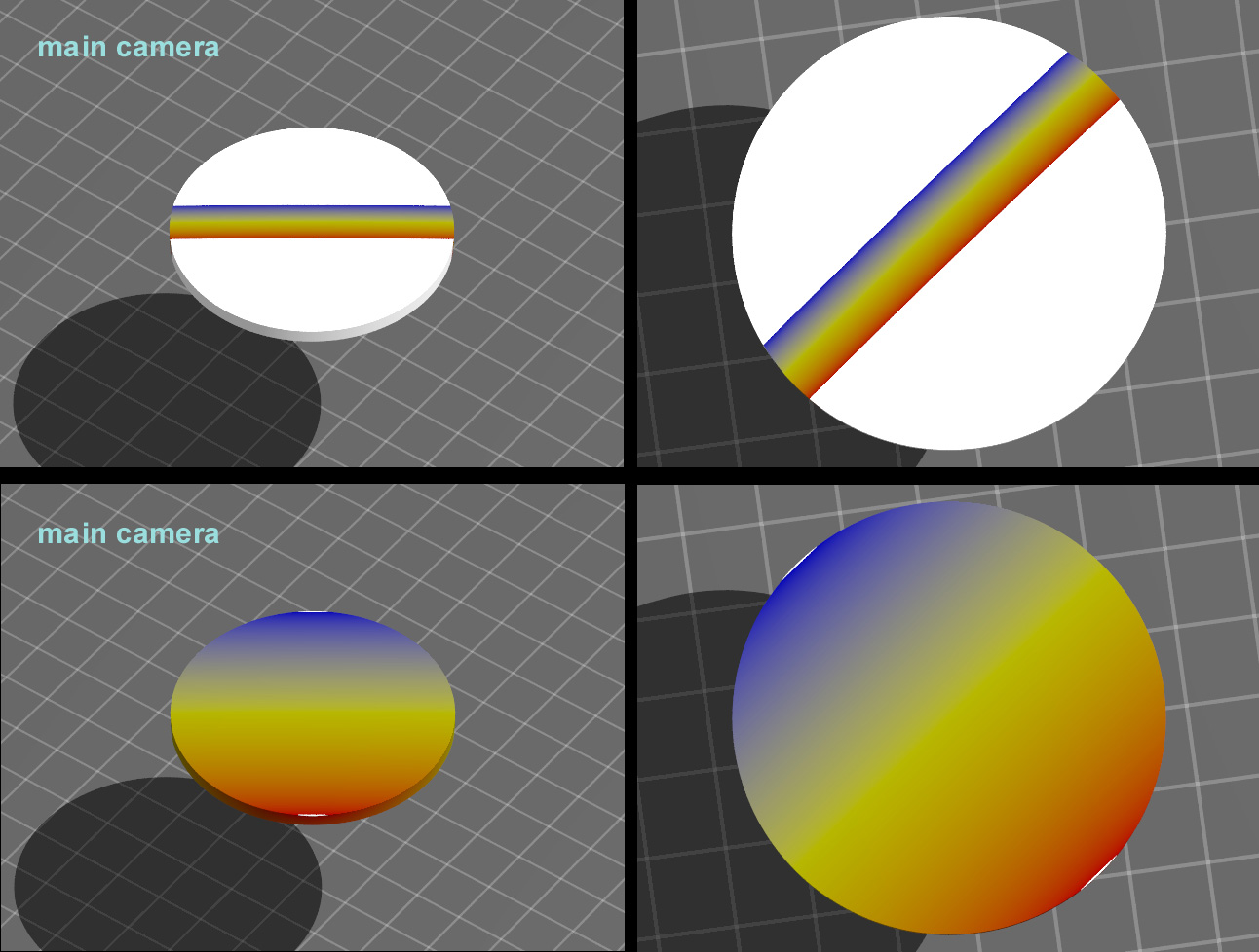

on relative distance between object and camera, and on the scale of the object.
I don't know if those values change linearly, exponentially, or what.
Essentially, they increase the distance between the object's found  bounding-box
coordinates, *as if* the object is larger. A clue?
The first image is the result of the initial code idea; the second is with the
fix. The fudge factors indicate that the 'squashed' color_map values depend on
some kind of so-far-unknown variable. There HAS to be an answer; I just haven't
found it yet :-(
The camera and object positions are arbitrary, as is object scale, and can be
anything... within reason ; there can be precision issues behind-the-scenes. See
the #debug messages.
#declare CAM_LOCATION = <32, 56, -35>*3; // easily change location using the
// (positive) multiplier (actually changes it between location <0,0,0> and
// farther out)
#declare OBJECT_CENTER_LOCATION = <3,6,22>*1.0; // ditto
#declare OBJECT_SCALE =  2.7;
#declare CAM_ANGLE = 3; // 0.9 Just to easily change the camera angle when
// you change object scale or camera/object distance.
// main camera
camera {
  perspective
  location  CAM_LOCATION
  look_at   OBJECT_CENTER_LOCATION
  right     x*image_width/image_height  // aspect
  angle CAM_ANGLE
// OR, separate camera, 'un-coupled' from code, looking from another location
// way above
camera {
  perspective
  location  <0,500,0>
  angle CAM_ANGLE
light_source {
  0*x
  color rgb .7
  translate <40, 80, 30>
background{rgb .1}
// stripes are 1-unit apart
plane{y,0
    pigment{
           average
           pigment_map{
                [ 1 gradient x
                 color_map{
                     [.05 rgb .8]
                     [.05 rgb .3]
                [ 1 gradient z
                 color_map{
                     [.05 rgb .8]
                     [.05 rgb .3]
           scale 1
#declare OBJECT_1 =  // does not need to be centered on origin when made
// box{0,<1,.1,1> scale OBJECT_SCALE
// rotate 40
// translate OBJECT_CENTER_LOCATION
// OR...
cylinder{-.05*y,.05*y 1
   scale OBJECT_SCALE
   translate OBJECT_CENTER_LOCATION  // yes, PRE-translated -- it's part
                                     // of the idea
#declare NEAR_CORNER = min_extent(OBJECT_1);
#declare FAR_CORNER = max_extent(OBJECT_1);
#declare L_1 = vlength(NEAR_CORNER - CAM_LOCATION) - 0;  // or - 1.68 FUDGE
// FACTOR
#declare L_2 = vlength(FAR_CORNER - CAM_LOCATION) + 0;  // or + 1.44 FUDGE
// FACTOR
#declare S = L_1/L_2;
#declare T = 1.0 - S;
#declare SPHERE_PIG =
pigment{
     spherical
     color_map{
          [0 rgb 3]
          [0 rgb <0,0,1>] // BLUE -- outside edge of pattern
          [0.5*T rgb <1,1,0>] // YELLOW
          [T rgb <1,0,0>] // RED
          [T rgb 3]
      // to experiment with...
      color_map{
          [0 rgb 3]
            [.48*T rgb <0,0,1>]
            [.48*T rgb <1,1,0>]
            [.52*T rgb <1,1,0>]
            [.52*T rgb <1,0,0>]
          [T rgb <1,0,0>]
          [T rgb 3]
      scale L_2
      translate CAM_LOCATION
object{OBJECT_1// already translated
     pigment{SPHERE_PIG} // ditto
#debug concat("\n", "object SCALE = ",str(OBJECT_SCALE,0,9),"\n")
#debug concat("\n", "distance to bounding box NEAR corner (L_1) =
",str(vlength(NEAR_CORNER - CAM_LOCATION) - 0,0,9),"\n")
#debug concat("\n", "distance to bounding box FAR corner (L_2) =
",str(vlength(FAR_CORNER - CAM_LOCATION) - 0,0,9),"\n")
#debug concat("\n", "L_1/L_2 = ",str(L_1/L_2,0,9),
"  (should never go over 1.0 !)","\n")
#debug concat("\n", "T = ",str(T,0,9),"\n")
Download 'chromadepth_example.jpg' (225 KB)
Preview of image 'chromadepth_example.jpg'
From: Mike Horvath
Date: 19 Feb 2018 19:19:08
Message: <5a8b697c$1@news.povray.org>
On 2/19/2018 11:13 AM, Kenneth wrote:
> So, I finally coded-up my idea, and it does indeed put the 'center' color of the
> color_map across the center of the object. That part works, at least. But the
> color pattern's 'limits' on the object have a problem: the color spread doesn't
> extend all the way across. So far, after several days of trying to figure out
> why, I still don't have a clue. I tried changing *every* parameter in the code,
> but no luck-- although there's probably a hidden 'clue' in those trials.
> So, I had to resort to some fudge-factors as well :-/  I eventually found one
> set of those that actually works consistently... so the overall scheme is
> workable after all. Only two 'fudging' values need changing, by eye; they depend
> found it yet :-(
Awesome! Let us know when you figure out why the fudge factor is needed.
If you flip over the disc you'll see that the second fudge factor is too
small. You need to set it to + 1.65 instead of + 1.44.
Mike
