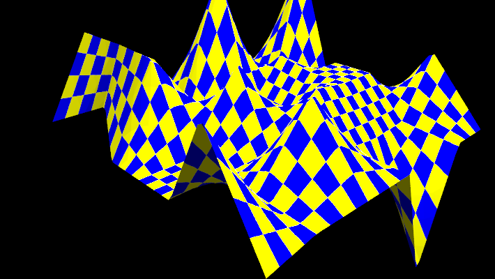

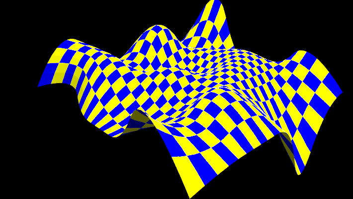

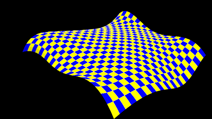

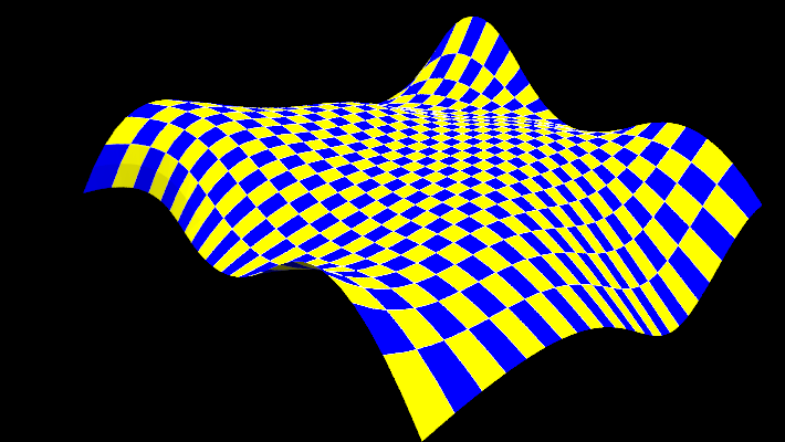

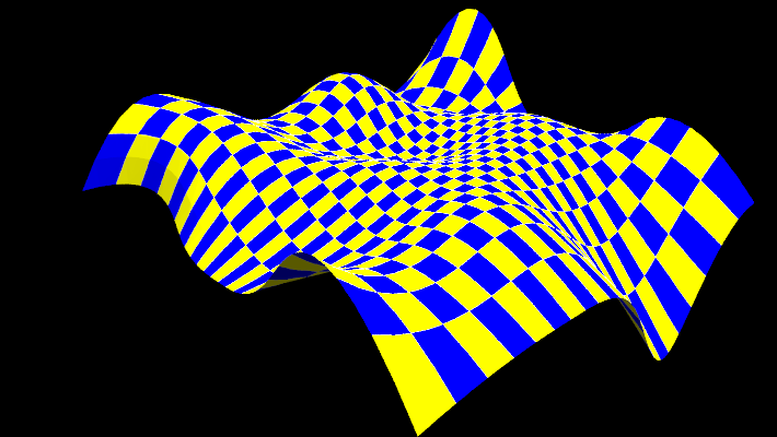

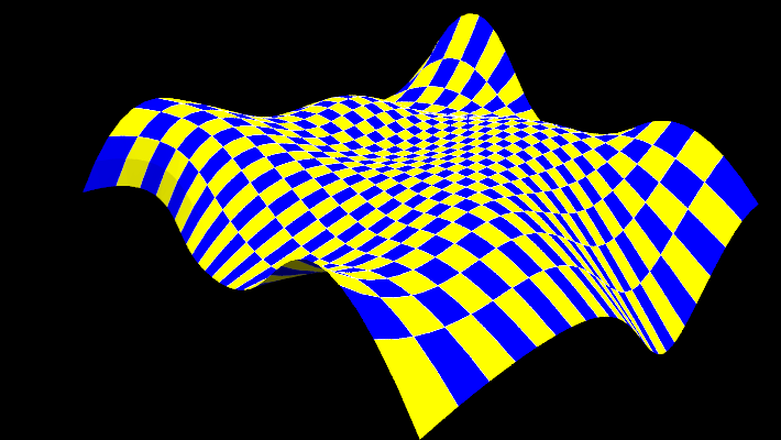

From: Le Forgeron
Subject: Re: NURBS
Date: 15 Aug 2016 14:10:53
Message: <57b205ad@news.povray.org>
Le 30/07/2016 à 13:13, LanuHum a écrit :
> Le_Forgeron <jgr### [at] freefr> wrote:
>> I would need a few more round tuits and my stock is low.
> And who is now easy to live?
A bit of progress.
The number on the image is the order (aka degree+1) of the curve used in the Nurbs.
I hope you are ready to handle the knot vectors, because I gave up the
user-friendliness of opened/clamped/closed
nu7 is similar to the rational bezier that was previously available. (because with 7
control points, at order 7, the nurbs (with the knot vectors that were provided) is a
single rational bezier)
nu3 is more similar to your provided picture, or it could be nu4.
Still to do: implement the computation of normal (I found a nice formula, but I lack
the time to code it), not used so far.
Also attached is the SDL scene with what is the equivalent of Jar-Jar in front of the
Chamber:
I do not know yet who is Palpatine, but there is a big step towards the dark side of
the Force.
Because the nurbs is transformed into a mesh (in the SDL so far).
Download 'nu7.png' (40 KB) Download 'nu6.png' (43 KB) Download 'nu5.png' (45 KB) Download 'nu4.png' (47 KB) Download 'nu3.png' (56 KB) Download 'nu2.png' (79 KB) Download 'nurbsmesh.inc.txt' (2 KB) Download 'nu.pov.txt' (4 KB)
