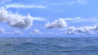

Thanks, Thomas, John... see if these cirrus look better.
jaime
The wizard did it again! :-)
Yes, that is much, much better.
> jaime
You're not supposed to use a camera ;-)
Much better. Good work.
John

Am 04.05.2016 um 07:53 schrieb Jaime Vives Piqueres:
Something's still odd about this. Can't put my finger on it though.
Maybe thick low-hanging cumulus together with cirrus is a weather
situation we don't normally see?
Maybe there's a 3D-component to your cirrus clouds, whereas in reality
they seem to be quite flat?
Subject: Re: concentric blobs clouds
Date: 4 May 2016 12:28:58
Message: <572a234a@news.povray.org>
> jaime
Usualy, cirrus clouds looks rather flat due to their altitude and their
small vertical extent.
My take would be to use a plane or very large, somewhat flattened,
sphere and use an image_map. Just be sure to set that to no_shadow.
Anyway, normaly, cirrus don't cast noticeable shadows as they are so thin.
Personaly, I'v seen some cases where you have cirrus above some other
clouds formations. Even cirrus above other cirrus, in this case, it's
usualy strato-cirrus above cirrus.
   Well, it's not really that strange to have cirrus over cumulus, tough
most of the time there is a clear sky over them.
> reality they seem to be quite flat?
   The media shell is very thin, so I think that's not the problem. I
think it was the fact that I forgot to map them spherically, so they
don't look to be as high as they should.
jaime
> their small vertical extent. My take would be to use a plane or very
> large, somewhat flattened, sphere and use an image_map. Just be sure
> to set that to no_shadow. Anyway, normaly, cirrus don't cast
   I tried first the image map, but it was hard to match the lighting on
the photo with the sun on the scene, so I opted to use the photo as a
pattern for scattering media.
>  clouds formations.
   Me too...
jaime

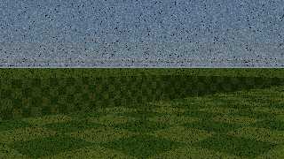

I am having trouble adapting this code. Here's what I have:
#declare lego_units = 20;	// LDU per foot
#declare earth_radius	= 20900000 * lego_units;
#declare earth_circum	= floor(2 * pi * earth_radius / 640) * 640;
#declare earth_radius	= earth_circum/2/pi;
#declare cloud_min_radius	= 6000 * lego_units;
#declare cloud_max_radius	= 9000 * lego_units;
	#local inner_radius = earth_radius + cloud_min_radius;
	#local outer_radius = earth_radius + cloud_max_radius;
	#local bound_radius = sin(acos(earth_radius/outer_radius)) * outer_radius;
	#local cloud_scale = 1;
	#local cloud_media = media
         method 3
         samples 20
         scattering {2, color rgb 0.0075 extinction 1}
         density
             wrinkles
             scale outer_radius * 300 * <1,1/4,1>
             warp { turbulence 2 }
             lambda 4
             color_map
                 [0.00 color rgb 1.0]
                 [0.50 color rgb 0.8]
                 [0.55 color rgb 0.0]
                 [1.00 color rgb 0.0]
         density
             gradient y
             scale (cloud_max_radius - cloud_min_radius)
             color_map
                 [0.0  color rgb 0.00]
                 [0.4  color rgb 1.00]
                 [0.9  color rgb 1.00]
                 [1.0  color rgb 0.00]
		scale 1
	#local cloud_sphere = difference
		sphere {0, outer_radius}
		sphere {0, inner_radius}
//		bounded_by {cylinder {<0,-earth_radius,0,>, <0,-outer_radius,0,>,
bound_radius}}
		hollow
		material
			texture {pigment {color srgbft <1,1,1,0,1>}}
			interior
				media {cloud_media}
			scale cloud_scale
		translate +y * earth_radius
	object {cloud_sphere}
However, the effect is very grainy and dark. If I continue to scale it
upward, it turns nearly black. If I scale it downward, I can't see the
clouds any more. Does anyone know what I am doing wrong? Thanks.
Mike
> Mike
Never mind. I think I have a handle on it.
Mike
