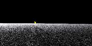

Following the little discussion in the thread Saturn's Greetings, I
started to explore the ring structure. This is a very first wip using 1
million discrete objects. Obviously, if I want to follow this approach
further, I shall need many more objects. Writing their positions (and
testing their visibility in the scene) takes most of the time. This
exercise too about half an hour. Very acceptable.
I have not taken into account the real dimensions of the ring. I should
provide for that too.

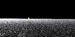

From: Christian Froeschlin
Subject: Re: Saturn Ring - a first wip
Date: 4 Jan 2015 20:05:06
Message: <54a9e342@news.povray.org>
On 03.01.2015 16:17, Thomas de Groot wrote:
> Obviously, if I want to follow this approach further, I shall need
> many more objects.
If that doesn't scale up you could try an isosurface such as
#declare f_particles = function(x,y,z)
   0.8 - f_crackle(400*x,400*y,400*z) +
   0.1 * f_granite(500*x,500*y,500*z)
isosurface
   function { f_particles(x,y,z) }
   contained_by { box {<-3,0,0>,<3,0.1,1000>} }
   accuracy 0.0001
   max_gradient 1000
   pigment {color rgb 1}
Download 'particles2_800.png' (474 KB)
Preview of image 'particles2_800.png'
Date: 5 Jan 2015 03:17:52
Message: <54aa48b0@news.povray.org>
Ah yes! That is what I need in addition. Thanks! I was thinking of using
a media in combination with the ring particles but this would be much
better indeed.
Note that the particles are also traced into a ring pattern Ideally, the
isosurface should mimic that too.
Date: 5 Jan 2015 15:42:08
Message: <54aaf720$1@news.povray.org>
> better indeed.
> Thomas
Just add a wood or onion pattern to the function, or an image pattern to
get a beter control.
   0.1 * f_granite(500*x,500*y,500*z) +
   0.9 * f_onion(500*x,0,500*z)
Date: 6 Jan 2015 03:10:54
Message: <54ab988e$1@news.povray.org>
Yes, I had not got that far yet, but that was my intention indeed too :-)
An image is coming soon.
Date: 6 Jan 2015 06:52:13
Message: <54abcc6d@news.povray.org>
Next attempt.
Here dimensions are correct for Saturn's B-ring.  The onion pattern in
the function does not show in the fine structure. Maybe not too much of
a problem; the larger particles determine the concentric structure.

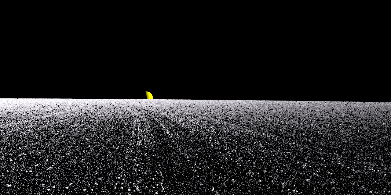

Date: 6 Jan 2015 08:17:19
Message: <54abe05f@news.povray.org>
The preceding image was rendered at a safe altitude of about 100 km
above the ring. Cautiously navigating downwards, we are here at about an
altitude of 10 km. :-)
Distance from Saturn's Centre: 100.000 km, which means still about some
17.000 km from the B-ring's edge.
Download 'complex.png' (824 KB)
Preview of image 'complex.png'
Date: 6 Jan 2015 10:55:43
Message: <54ac057f@news.povray.org>
My pilot is reckless!
On our way to the rim of the B-ring, he plunged into the ring itself!
Media to simulate the sub-millimetre particles; reddish zone to indicate
where the "mountains" are going to be. Distance to there is about 500 km.
Download 'complex.png' (452 KB)

From: Jörg 'Yadgar' Bleimann
Date: 6 Jan 2015 11:34:13
Message: <54ac0e85$1@news.povray.org>
Hi(gh)!
On 06.01.2015 12:51, Thomas de Groot wrote:
> Next attempt.
The yellow half-lit sphere looming over the rings' edge - is it meant to
be Titan? If yes, you perhaps should have chose a more orange hue...
