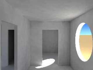

After fiddling around with the settings from rad_def.inc (and not
getting near anything really looking good), I searched the Web for a
tutorial on PoV-Ray radiosity and found this:
http://www.simnet.is/hildurka/content/tut1page.htm
So I carefully worked through the steps described there - but when I
came to the final setting (see code below), I noticed that my scene
matched Mrs. Andresdottir's example scene as far as brightness of the
shadowed parts is concerned - but still contained considerably more
artifacts than her really clean scene (seventh from top, just above the
version with area_light).
In her tutorial, Mrs. Andresdottir does not give the version of PoV-Ray
she used, as her original code contains a switch for versions newer than
3.1, I assume that it is 3.5 rather than 3.6 (which I use). Could it be
that 3.5 uses different default radiosity settings than 3.6? Or is it
because Mrs. Andresdottir places the whole scene inside an (monochrome)
ambient 1 sphere rather than a gradiented sky_sphere?
Here is the code:
       radiosity
         brightness 1.5
	count 300
	error_bound 0.05
         gray_threshold 0.8
         low_error_factor 0.2
         minimum_reuse 0.015
         nearest_count 10
	recursion_limit 5
         adc_bailout 0.01
         max_sample 0.9 // -1
         always_sample 1
	pretrace_start 0.08
	pretrace_end 0.01
         load_file "whatmough_residential.rad"
	save_file "whatmough_residential.rad"
The only difference to Andresdottir's original code is that I use a
gray_threshold of 0.8 rather than 0.
See you in Khyberspace!
Yadgar
Download '2011-10-22 port whatmough residential building #1, take 188 - view from kitchen into atelier, cheap little beginner's ra' (25 KB)
Preview of image '2011-10-22 port whatmough residential building #1, take 188 - view from kitchen into atelier, cheap little beginner's ra'
I cannot explain why Andresdottir's render is cleaner than yours.  I can say
that, in my experience, a really tiny pretrace_end is good for reducing
artifacts.
I have no experience with 3.1, so I can't comment on that.  It is not a question
of any difference in the defaults between 3.5 and 3.6, as all the parameters are
specified.  I do not recall any difference in output between 3.5 and 3.6.  I
don't think there's any difference between a sphere and a sky_sphere, although
someone else will have to confirm this.
I am no expert at radiosity, but I question some of Andresdottir's settings:
>          brightness 1.5
This is physically unrealistic.  A high brightness value can compensate for a
low recursion_limit, but that's obviously not the case here.  I suppose that
this looks more "realistic" because a straight rendering does not capture the
dynamic range of real-life lighting.
>  error_bound 0.05
I've found that setting error_bound this low does nothing more than slow down
your render, and perhaps add more intractable artifacts.
>  recursion_limit 5
See the tutorial in the documentation.  There's no reason to set recursion_limit
this high, unless you enjoy waiting for stuff.
>  pretrace_end 0.01
I found that this works well in 3.6, but when you upgrade to 3.7, it won't be
small enough for many scenes.
I'm not sure what it means to load_file and save_file at the same time.  (I
vaguely recall that there's some trick that this effects, but it wasn't
fantastic enough for me to retain it.)
Good luck!
From: Jörg 'Yadgar' Bleimann
Subject: Re: Following a tutorial on radiosity...
Date: 25 Oct 2011 12:40:41
Message: <4ea6e689@news.povray.org>
Hi(gh)!
> artifacts.
So I changed the pretrace_end to 0.002...
...and increased error_bound to 0.1 - aside from the scene now rendering
somewhat faster, I found no advantages, there are still the same
annoying artifacts (see below)! Perhaps I really should try the ambient
sphere...
Yadgar
Download '2011-10-25 port whatmough residential building #1, take 190 - view from kitchen into atelier, modified andresdottir radi' (20 KB)
Preview of image '2011-10-25 port whatmough residential building #1, take 190 - view from kitchen into atelier, modified andresdottir radi'

From: clipka
Date: 25 Oct 2011 16:07:04
Message: <4ea716e8$1@news.povray.org>
> ....and increased error_bound to 0.1 - aside from the scene now
> rendering somewhat faster, I found no advantages, there are still the
> same annoying artifacts (see below)! Perhaps I really should try the
> ambient sphere...
What you really should try is POV-Ray 3.7 - radiosity has changed a lot
since 3.6.
You'll probably need to increase the radiosity count parameter at any
rate though; the irregularities seen on the walls indicate that POV-Ray
doesn't "catch" the bright patches of sunlight on the floor reliably.
In case render times increase unacceptably, there are some ways in 3.7
to counter this increase to some degree. (In particular, you can define
fully transparent objects to "mark" the patches of sunlight, set to
"radiosity { importance 1.0 } no_image no_shadow no_reflection", while
you set the walls to "radiosity { importance 0.1 }" or some such.)
