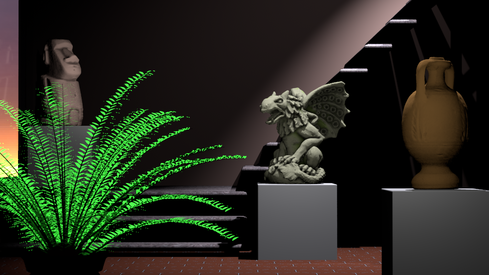

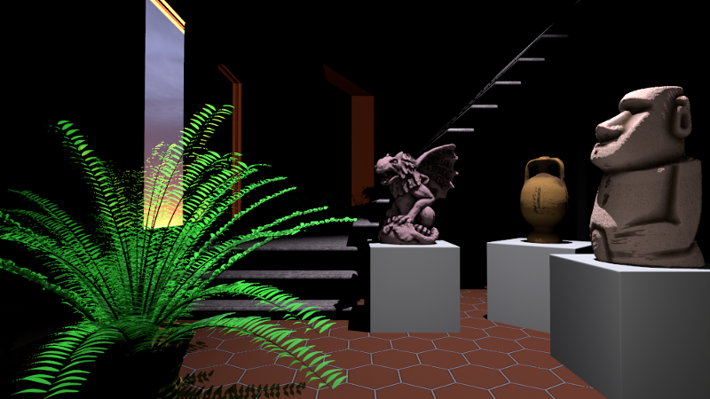

I've been giving Trevors crevice grime macro a try and I think I'm
getting the hang of it. The three objects on the pedestals have an
object light that was used to fill in the areas that the overhead and
mezzanine lights didn't reach. I started getting better results when I
used the location of each objects light as the grime macros "camera
location" instead of the scene camera location.
Oh yeah ... check out the backside diffuse on the fern.
Now a question (the real reason of this post) ... what's up with the
slightly tilted look (back and forth) with the Moai. My camera's look_at
is 180 from it's origin, so it's flat. The angle is default. I'd like to
be able to solve this without a lot of trial and error. My 1st thought
was rotate a little x (cam is at -z) but was wondering if changing the
look_at y vector just a tad was better ... Or maybe I should pull the
camera back and make angle smaller.
Hey if there's a "teaching moment" out there ... I'm all ears.
Jim
PS: don't be giving me the gears about the dark walls ... I'm workin' on
it ;-)

What you are seeing is probably perspective distortion.  For example look at how
the shape of the floor tiles looks at the corners of the image vs the center.
The way to minimize this is to pull your camera back and tighten the view angle,
nuch like zooming in real photography.
Yep ... I'm debating on getting rid of the wall behind the camera and
maybe the light from the environment map will help blend the overall
lighting ... I hate it when I answer my own question after posting ...
one of those delayed brain farts I guess ;-)

Trevor, the above info would make a great addition to your next update,
it really helped me out with getting my setup correct.
The gargoyle is my favorite, the amphora turned out neat (very subtle)
... some of the shading on it comes from edge detect as the spots
orbiting the objects are shadowless, they just fill in where the
overhead center, the mezzanine, and the sun set lights didn't hit. I
also seem to be getting good mileage from have the orbiting object
lights as the cam position for the edge/crevice detect.
Thanks for the addition to my toolbox :-)
Jim
