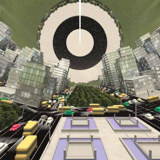

I moved the rendering to here:
http://isometricland.com/gearhead/ghpanotour_spinner_test.php
Right now (not in the above image yet) I'm experimenting with radiosity
and a bit of atmospheric haze. What would good values be for scattering
media? I'm assuming the density should be greater toward the edges of
the cylinder, but by how much? Should the density increase linearly or
exponentially?
Thanks!

For the density. It would remain almost constent near the axis of
rotation, then increase somewhat faster as you get nearer to the outer
surface. I'd go for proportional to the square of the radius. At least,
it looks reasonable to me. Use a cylindrical pattern:
density{cylindrical poly_wave 0.5 density_map{[0 1][1,0.3]}}
Your cloudy "sky" looks out of place here. A large transparent area,
while good to get some natural light, is a great structural weakness,
not to mention that that area is lost from the ocupancy potential of the
station. If it's just a decoration for the inabitants, it's even worst.
Also, as the illumination seems to come from that bright axial beam, it
should be constant everywhere.
If you want your buildings to taper toward the top, I suggest using
prisms instead of simple boxes. But, unless a building is particularly
broad, there is no real reason that they should'nt have a constant width.

Thanks for the comments. Do I need to scale the density file to the
scale of my scene?
The "sky" is also meant to place the opposite side in shade in order to
produce "night". I've tried other methods like placing a sleeve around
the lamp, but due to radiosity the opposite side is then never fully in
the dark. I.e. the "bright" side casts reflected light onto the supposed
"dark" side.
As for loss of occupancy, you're assuming people want to live in zero G.
Only the areas near the surface have suitable "gravity".
The "sky" does look ugly though.

Yes, you need to scale the cylindrical pattern to the radius of the scene.
For the "night", in an environment such as that station, there is never
one, and it's quite realistic that there should be no dark side.
If they want a "night", they should do it by turning off the central
glowing beam, or dim it down. There is absolutely no reason to have
areas dark while other are brightly illuminated, it's the same hour and
time of the day everywhere. Have you seen Babylon 5? It's a very good
example of a spining cylindrical space station.
For the loss of ocupancy, I mean loss of living surface due to the "sky"
area, not going all the way up to the axis.
Good idea.
I uploaded a new render (same URL). I'm still having problems with the
scene looking "artificial", or like a miniature model. I can't quite put
my finger on it.

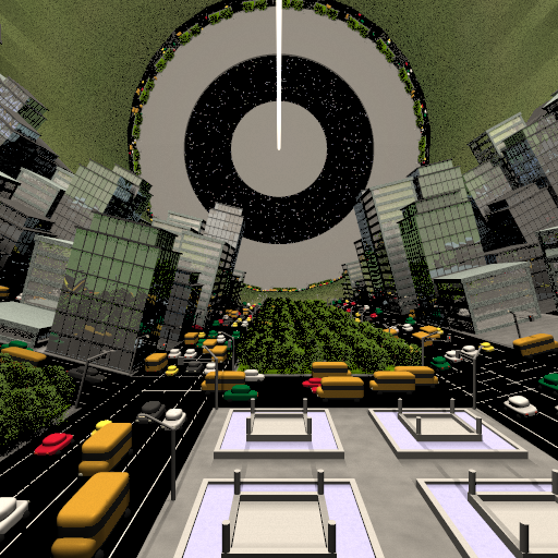

From: SharkD
Subject: Re: "Spinner" space colony (2)
Date: 9 Jun 2010 14:32:53
Message: <4c0fde55@news.povray.org>
Still looks washed out... :(
> Good idea.
> my finger on it.
All those cars and the streets don't help. I'd expect a comunal
transport system, part on grount, part suspended, to accomodate the
cityzens transportation.
I still have a dificulty with your clouds and "blue sky". If there are
some clouds, they would tend to gather into a cylinder around the center
beam, but never touching it.
Any blueish area due to the athmospheric scattering would be in the
direction of the central beam relative to the observer. Now, it's about
120° from where it should be.
The location IS artificial by definition. You may add some light fog, it
may help to give a sense of scale.
You may try puting the camera on the roof of a building or at street level.
From: SharkD
Date: 9 Jun 2010 19:56:38
Message: <4c102a36@news.povray.org>
I adjusted all the pigments to compensate for assumed_gamma. The scene
is no longer as washed-out and bright.
Another problem I haven't fixed yet are the streets. For some reason
they show up as black when they instead should be gray. I don't know
why. I thought I fixed all coincident/overlapping surfaces.
Date: 10 Jun 2010 03:28:29
Message: <4c10941d$1@news.povray.org>
Better indeed.
From looking at the buildings, I feel that the cylinder should have a much
larger radius. People will get claustrophobic here, with the impression that
the buildings are falling on their heads. :-)
I think that the sense of scale would be improved with a better balance
between cylinder dimensions and building dimensions. I suggest a larger
cylinder and (much more) scaled-down buildings/living space. Add some
atmospheric media or a subtle fog for suggesting distance and you will get a
much more believable scene.
From: Stephen
Date: 10 Jun 2010 04:21:10
Message: <4c10a076@news.povray.org>
On 10/06/2010 8:28 AM, Thomas de Groot wrote:
> Better indeed.
I agree.
I suggest a larger
If Mike does that then it may be realistic but it will be boring to look
at. IMO realistic space scenes show one feature while hiding most others
due to differences in scale. Do you remember the posts from a few years
Having said that the ground could be s bit further away ;-)
