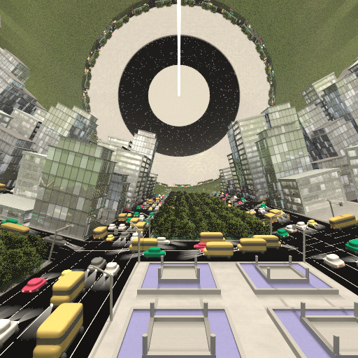

I uploaded a new render (same URL). I'm still having problems with the
scene looking "artificial", or like a miniature model. I can't quite put
my finger on it.
http://isometricland.com

Still looks washed out... :(

Le 2010-06-07 16:58, SharkD a écrit :
> On 6/7/2010 2:22 PM, Alain wrote:
>> If they want a "night", they should do it by turning off the central
>> glowing beam, or dim it down.
> Good idea.
> my finger on it.
All those cars and the streets don't help. I'd expect a comunal
transport system, part on grount, part suspended, to accomodate the
cityzens transportation.
I still have a dificulty with your clouds and "blue sky". If there are
some clouds, they would tend to gather into a cylinder around the center
beam, but never touching it.
Any blueish area due to the athmospheric scattering would be in the
direction of the central beam relative to the observer. Now, it's about
120° from where it should be.
The location IS artificial by definition. You may add some light fog, it
may help to give a sense of scale.
You may try puting the camera on the roof of a building or at street level.

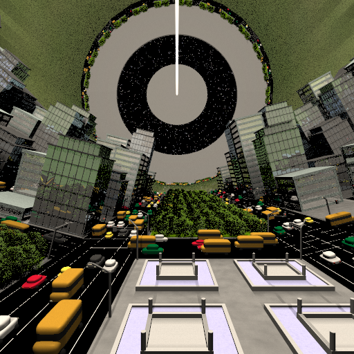

I adjusted all the pigments to compensate for assumed_gamma. The scene
is no longer as washed-out and bright.
Another problem I haven't fixed yet are the streets. For some reason
they show up as black when they instead should be gray. I don't know
why. I thought I fixed all coincident/overlapping surfaces.

Message: <4c10941d$1@news.povray.org>
Better indeed.
From looking at the buildings, I feel that the cylinder should have a much
larger radius. People will get claustrophobic here, with the impression that
the buildings are falling on their heads. :-)
I think that the sense of scale would be improved with a better balance
between cylinder dimensions and building dimensions. I suggest a larger
cylinder and (much more) scaled-down buildings/living space. Add some
atmospheric media or a subtle fog for suggesting distance and you will get a
much more believable scene.

On 10/06/2010 8:28 AM, Thomas de Groot wrote:
> Better indeed.
I agree.
I suggest a larger
If Mike does that then it may be realistic but it will be boring to look
at. IMO realistic space scenes show one feature while hiding most others
due to differences in scale. Do you remember the posts from a few years
Having said that the ground could be s bit further away ;-)
