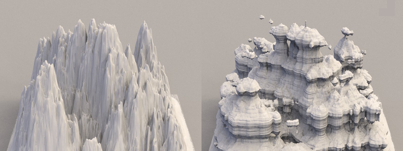

Hello,
Here's a method for slicing a height_field into many pieces and
translating/scaling the parts to create caves and overhangs. It renders
faster than an isosurface, but produces visible seams. It's still pretty
slow :(
The left portion of the attached image shows an unmodified height_field.
The portion to the right is the same height_field sliced 50 times. A
surface normal was added to diminish the appearance of seams. With
enough slices, and with a smoother controlling pigment to create the
overhangs, some of the sharper features can go away.
The coincident surfaces near the base is a consequence of giving the
ground plane a difference pigment than the height_field.
The macro places the object between <0,0,0> & <1,1,1>.

Sam
Download 'hf_slicer.jpg' (148 KB)
Preview of image 'hf_slicer.jpg'

From: nemesis
Subject: Re: rendering height fields with overhangs
Date: 17 Dec 2009 16:55:01
Message: <web.4b2aa7a5ce35323773c9a3e0@news.povray.org>
Going from the Alps to the Gran Canyon.  Nice! :)
From: Edouard
Date: 17 Dec 2009 18:50:01
Message: <web.4b2ac3a1ce35323c0cdd8870@news.povray.org>
stbenge <UN### [at] hotmailcom> wrote:
> Oops, there was some vestigial code in that last macro. Here's a better
> version:
Fantastic idea - although this updated macro doesn't work for me on 3.7. The
original does, so I'm playing with that.
Cheers,
Edouard.

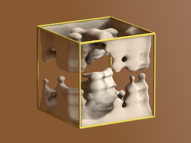

From: stbenge
Subject: a less buggy hf_slicer
Date: 17 Dec 2009 20:40:28
Message: <4b2add8c@news.povray.org>
Those other ones were quite buggy. Odd numbers wouldn't work, the
function for testing the control pigment wasn't accurate, and the thing
was not filling a unit cube correctly.
While testing this, also I realized that the more it stretches a
height_field, the slower it becomes. I wish I could make it more
efficient somehow.
#macro hf_slicer(hfs, hfs_control_pigment, hfs_n_slices)
  #local hfs_n_slices=hfs_n_slices-1;
  #local hfs_incre=1/(hfs_n_slices+1.001);
  #local hfs_function=function{pigment{hfs_control_pigment}}
  #local hfs_p1=0;
  #local hfs_V=0;
  union{
   #local hfs_counter=0;
   #while(hfs_counter<=hfs_n_slices)
    #local hfs_pv=hfs_function(0,(hfs_V+1/hfs_n_slices),0).x;
    #local hfs_p2=hfs_p1;
    #local hfs_p1=hfs_pv;
    object{hfs
     #if(hfs_p1>hfs_p2)
      clipped_by{plane{y,hfs_p1}} clipped_by{plane{y,hfs_p2 inverse}}
     #else
      clipped_by{plane{y,hfs_p1 inverse}} clipped_by{plane{y,hfs_p2}}
     #end
     translate -y*hfs_p2
     scale<1,hfs_incre/(hfs_p1-hfs_p2),1>
     translate y*hfs_V
    #local hfs_V=hfs_V+hfs_incre;
    #local hfs_counter=hfs_counter+1;
   #end
#end
Download 'hf_slicer_5_27.jpg' (35 KB)
Preview of image 'hf_slicer_5_27.jpg'
From: stbenge
Date: 17 Dec 2009 20:43:05
Message: <4b2ade29$1@news.povray.org>
>> version:
Thanks. Were you getting anything at all? How many segments were you
specifying for it?
I just reworked the entire code. Too few slices won't work. Currently,
you can have a minimum of three slices.

From: Tor Olav Kristensen
Subject: Re: a less buggy hf_slicer
Date: 18 Dec 2009 19:15:00
Message: <web.4b2c1ab75f6b9df6a049a19e0@news.povray.org>
> efficient somehow.
Hi Samuel
I had a look at your macro to see if I could make it more efficient.
Here's what I came up with:
#macro SliceHF(HeightField, ControlPigment, NrOfSlices)
  #local Step = 1/NrOfSlices;
  #local M_Fn = function { pigment { ControlPigment } }
  #local N_Fn = function(_C) { M_Fn(0, _C*Step, 0).gray }
  union {
    #local Cn = 0;
    #local Dn = N_Fn(Cn);
    #while (Cn < NrOfSlices)
      #local Cp = Cn;
      #local Cn = Cn + 1;
      #local Dp = Dn;
      #if (Dn != Dp)
        intersection {
          object { HeightField }
          box { <0, Dp, 0>, <1, Dn, 1> }
          translate -Dp*y
          scale <1, Step/(Dn - Dp), 1>
          translate Cp*Step*y
      #end // if
    #end // while
#end // macro SliceHF
But I'm not sure if it still works like you intended.
Tor Olav
http://subcube.com
From: stbenge
Date: 19 Dec 2009 14:23:41
Message: <4b2d283d@news.povray.org>
>> efficient somehow.
> Hi Samuel
It seems to work better than my versions.
With the changes you made, it might be actually be advantageous to use
this instead of an isosurface for some things.
Thanks! If I release another version of hf_tools.inc, I'll include your
version and give you proper credit :)
From: Kenneth
Date: 19 Dec 2009 15:25:00
Message: <web.4b2d3604ce3532365f302820@news.povray.org>
> Hello,
> faster than an isosurface...
Once again, you've come up with some magical sleight-of-hand! (Your POV code
creations are coming so fast, I can't keep up with them!) I was hoping someone
might come up with a method for producing HFs with overhangs. Kudos to you!
Results so far just astound me; it's one amazing tool. (I haven't yet tried Tor
Olav's version; just noticed it.) In the short time I've been playing with your
version #3 code, there seem to be endless shapes it can produce (by varying this
or that parameter.)  Yeah, I'm experimenting with some of your code, adding
things here and there, doing everything I can to break it (!) just to see what
will happen--then putting it back together, of course. :-) I continue to
'examine' the code to see how it operates, and what exactly it does. Seems like
voodoo at present.  :-p
BTW, a question about one of your #while loop lines:
hfs_pv=hfs_function(0,hfs_V,0).x
Any particular reason why you used .x (i.e., .red) rather than .gray?  Just
curious.
Your slicing method shows GREAT promise, so by all means continue with its
development. I foresee *many* uses for your technique.
Ken
