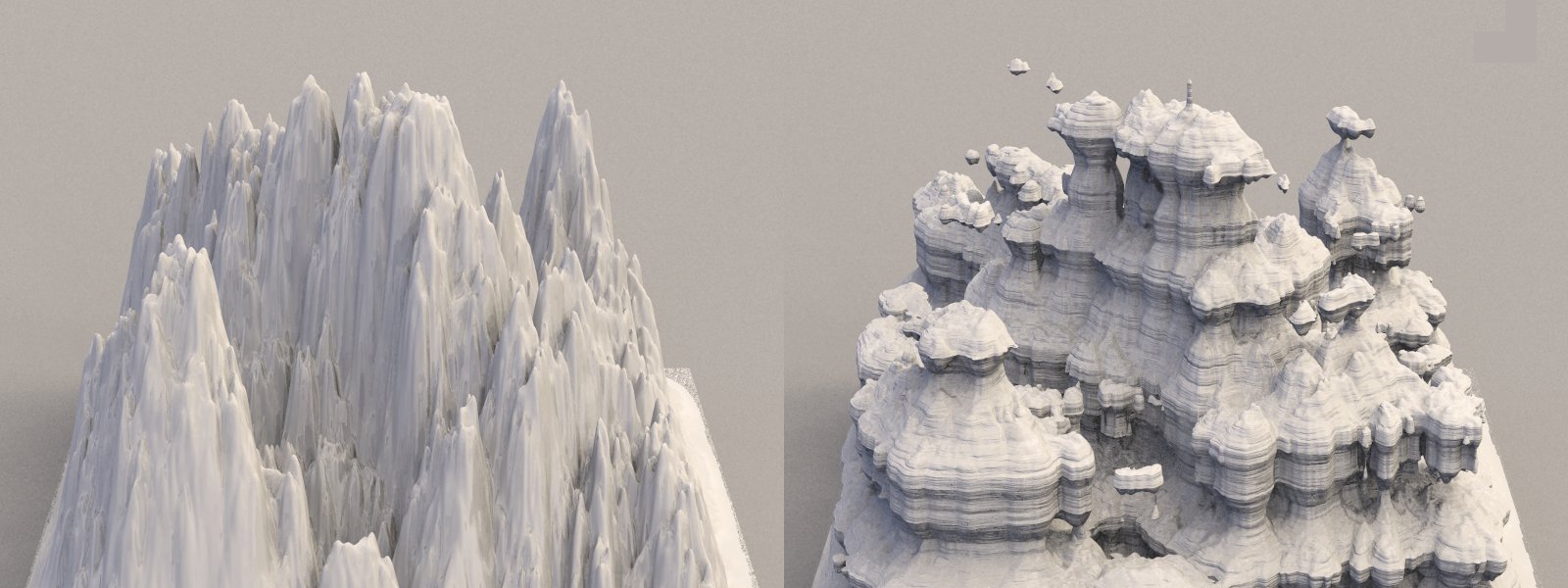

Hello,
Here's a method for slicing a height_field into many pieces and
translating/scaling the parts to create caves and overhangs. It renders
faster than an isosurface, but produces visible seams. It's still pretty
slow :(
The left portion of the attached image shows an unmodified height_field.
The portion to the right is the same height_field sliced 50 times. A
surface normal was added to diminish the appearance of seams. With
enough slices, and with a smoother controlling pigment to create the
overhangs, some of the sharper features can go away.
The coincident surfaces near the base is a consequence of giving the
ground plane a difference pigment than the height_field.
The macro places the object between <0,0,0> & <1,1,1>.

From: stbenge

From: nemesis
Subject: Re: rendering height fields with overhangs
Date: 17 Dec 2009 16:55:01
Message: <web.4b2aa7a5ce35323773c9a3e0@news.povray.org>
Going from the Alps to the Gran Canyon.  Nice! :)

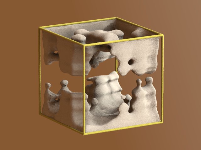

From: stbenge
Subject: a less buggy hf_slicer
Date: 17 Dec 2009 20:40:28
Message: <4b2add8c@news.povray.org>
Those other ones were quite buggy. Odd numbers wouldn't work, the
function for testing the control pigment wasn't accurate, and the thing
was not filling a unit cube correctly.
While testing this, also I realized that the more it stretches a
height_field, the slower it becomes. I wish I could make it more
efficient somehow.
#macro hf_slicer(hfs, hfs_control_pigment, hfs_n_slices)

Download 'hf_slicer_5_27.jpg' (35 KB)
Preview of image 'hf_slicer_5_27.jpg'

From: Kenneth
Date: 19 Dec 2009 15:25:00
Message: <web.4b2d3604ce3532365f302820@news.povray.org>
stbenge <UN### [at] hotmailcom> wrote:
> Hello,
> faster than an isosurface...
Once again, you've come up with some magical sleight-of-hand! (Your POV code
creations are coming so fast, I can't keep up with them!) I was hoping someone
might come up with a method for producing HFs with overhangs. Kudos to you!
Results so far just astound me; it's one amazing tool. (I haven't yet tried Tor
Olav's version; just noticed it.) In the short time I've been playing with your
version #3 code, there seem to be endless shapes it can produce (by varying this
or that parameter.)  Yeah, I'm experimenting with some of your code, adding
things here and there, doing everything I can to break it (!) just to see what
will happen--then putting it back together, of course. :-) I continue to
'examine' the code to see how it operates, and what exactly it does. Seems like
voodoo at present.  :-p
BTW, a question about one of your #while loop lines:
hfs_pv=hfs_function(0,hfs_V,0).x
Any particular reason why you used .x (i.e., .red) rather than .gray?  Just
curious.
Your slicing method shows GREAT promise, so by all means continue with its
development. I foresee *many* uses for your technique.
Ken
