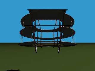

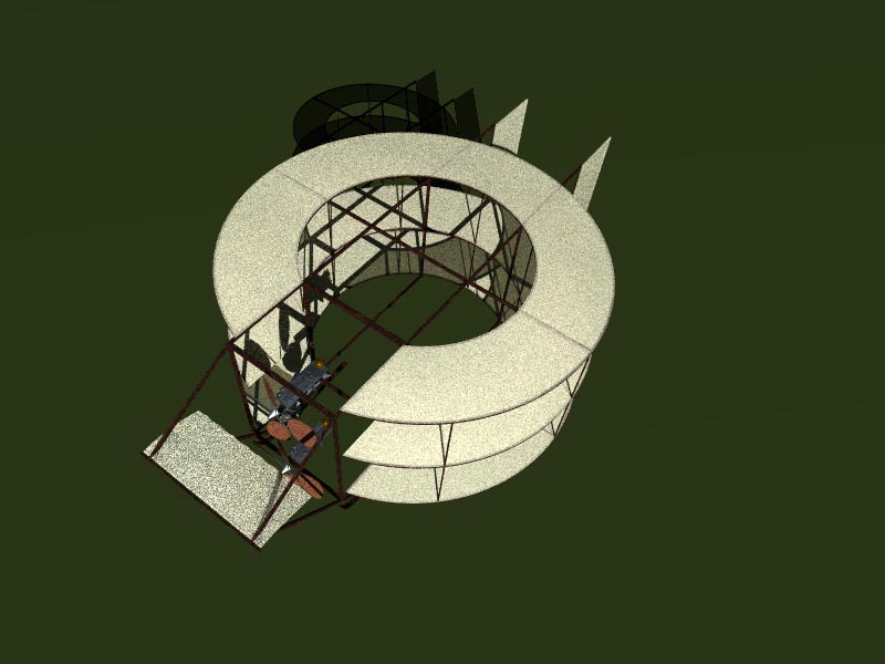

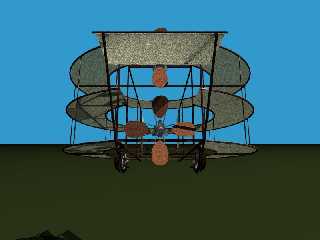

Hi.
Somehow I don't come close to where I want to go. Who can help me?
The series of vintage airplanes of the first hour is all made of convas and
wood. With the help of Tim Attwood and many others, I created some sort of
canvas texture. It works if you look from the lightened side onto the
canvas. But when looking from below, you would expect some transluscent
light but it is like a big block of shadow. Please see the three pictures I
have attached, they show my canvas from atop, from below, and a real photo
of canvas how it actually should be when watching it from below. NOT a plain
transparency I need. Also, when recognizing structures below the canvas,
they appear kinda smooth, blurred.
I am not too experienced if it comes to create materials which are
"light-proof". Therefore, I need your help. Bear in mind, canvas allows to
recognize, somehow, elements below the canvas, like parts of the wooden
frame of the airplane. Who can help me to create a light-proof canvas
material?
Here's the current canvas code:
#declare Wing3 = texture
 pigment
  image_map
   png "Canvas.png"
   transmit all 0.15
  rotate 90*x
 normal
  bump_map
   png "canvas.png"
   interpolate 2
  rotate 90*x
  scale 4
 finish { specular 0.3 roughness 0.05 }
Plenty thanks!
Download 'SL Crazy Wings - The Run - Top.jpg' (40 KB) Download 'SL Crazy Wings - The Run - Bottom.jpg' (49 KB) Download 'Sikorsky S-2.jpg' (67 KB)
Preview of image 'SL Crazy Wings - The Run - Top.jpg'
Preview of image 'SL Crazy Wings - The Run - Bottom.jpg'
Preview of image 'Sikorsky S-2.jpg'

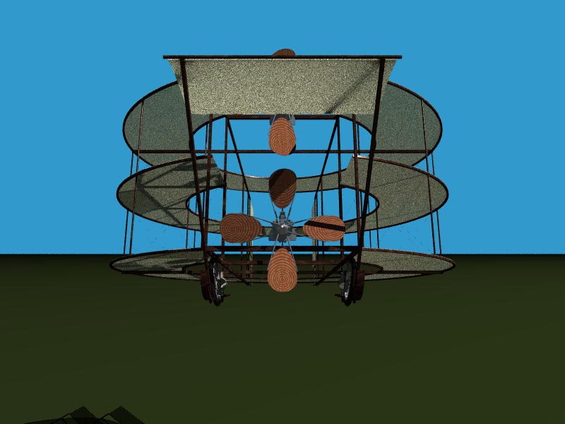

From: Jim Charter
Subject: Re: These Maginificent Men in their Flying Machines: Canvas Problem
Date: 9 Mar 2008 21:20:49
Message: <47d49b01@news.povray.org>
Sven Littkowski wrote:
What you are trying for is something of a POV grail.  There is no pat
solution.  There are
a few other attributes you can play with though.  You can also add
'filter all' which adds the fabric color to the light 'coming through'.
  Filter was actually the intended POV answer to translucence I believe.
  To lighten the undershadow you need to add radiosity and boost the
diffuse.  If you boost the specular you will also increase the
difference between the apparent translucence when viewed from the
lighted side verses the shadowed side.  Finally I also implemented (I
think) the idea suggested by Jan Dvorak.  By boosting the scale and
bump_size excessively You can see what he was suggesting you could play
with.
[Note, for ease of testing I left the image_map in the z plane, applied
it to a box then rotated the object rather than rotating the image_map
into the x plane before applying it like you have.  This was tested
using the radiosity scene template provide in the insert menu.]
#declare Wing3 =
material {
   texture
    pigment
      rgbt 1
    normal
    {  bumps 1
     //bump_map
     // png "canvas.png"
     // interpolate 2
     // bump_size 2
     scale <10,1,1>/1000
    rotate z*60
   texture
    pigment
      rgbt 1
    normal
    {  bumps 1
     //bump_map
     // png "canvas.png"
     // interpolate 2
     // bump_size 2
     scale <10,1,1>/1000
    rotate z*120
   texture
    pigment
     image_map
      png "Canvas.png"
      transmit all .3
      filter all .4
     scale 4
    normal
    { bumps 1
    // bump_map
    //  png "canvas.png"
    //  interpolate 2
    //  bump_size 2
     scale <10,1,1>/1000
    finish {
     diffuse .8
     specular 0.45
     roughness 0.5
   interior { ior 2.5 }
Download '2.jpg' (21 KB)

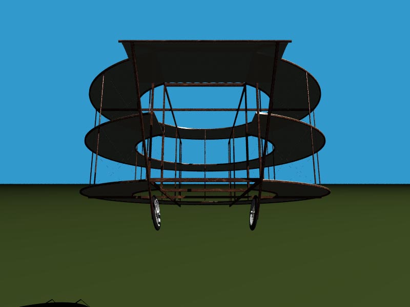

From: Sven Littkowski
Date: 10 Mar 2008 03:02:30
Message: <47d4eb16@news.povray.org>
The following pictures attached to this posting show the progress with the
texture, but all the fame goes to Jim Charter who provided my with his very
useful canvas material.
While this model of a vintage airplane is still incomplete (I am working on
the proper positioning of the wheels among other things), the canvas
material is probably nearly the way it could be. The noise on the color is a
bit too strong, I thing. I welcome your feedbacks!

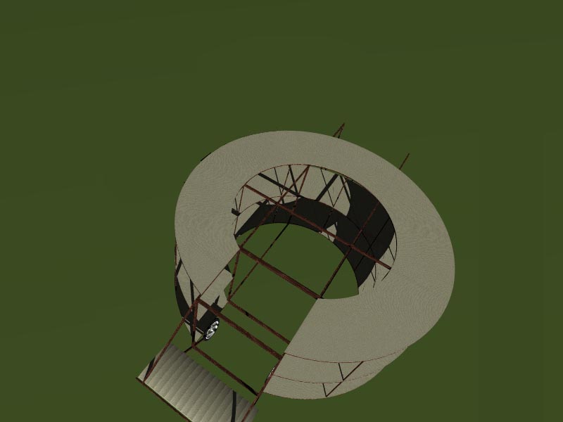

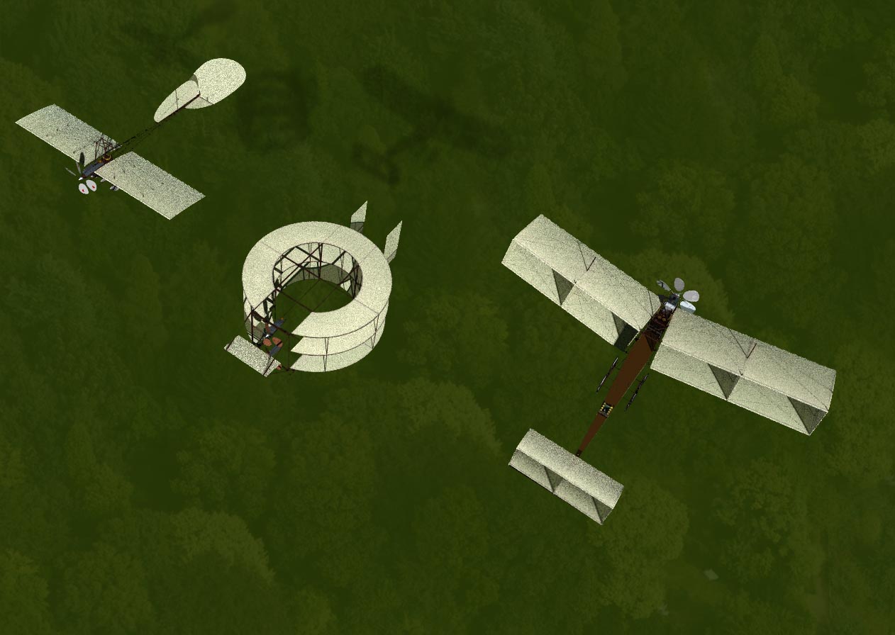

Date: 10 Mar 2008 05:22:24
Message: <47d50be0@news.povray.org>
Update. See the image for the individual vintage air planes of the scene.
Many more planes to come!
I am working on a scene resembling the atmosphere at the start location of
the London-Paris air race in 1911 (movie: "Those Magnificent Men in their
Flying Machines") and the famous "Round Britain Air Race" in 1911!
Here a link, if you want to see a video of the ORIGINAL air race of 1911!!!
http://youtube.com/watch?v=93UdIgU3_sA
Help welcome for the following related side projects:
- Hangar Constructions (see the movie)
- Large Tents (see movie) for persons
- Large Tents (see movie) as hangars for the smaller airplanes
- Vintage Oldtimer Cars as seen in the movie, from that time: English and
French cars (due the two possible locations)
- Persons dressed as seen in the movie and in the video clip: standing,
walking, running, sitting (pioneer pilots), riding etc. Obey the dress code
of 1911.
- Landscape (with a simplified English village or a simplified castle in the
distance?)
- other constructins as seen on the air field in the movie
All has to be converted into POV-Ray scene code. 1 meter = 1 POV unit
Download 'SL Crazy Wings - The Run - Sample.jpg' (119 KB)
Preview of image 'SL Crazy Wings - The Run - Sample.jpg'
