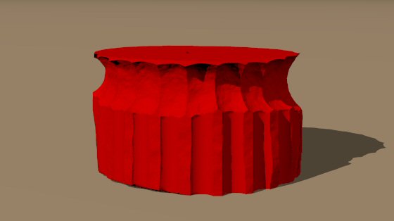

I need a bit of advice.
I try to model the top end of the flutes on a column shaft. It should end
with a hemispherical feature. However, as you can see on the image, the
sphere used is much too large, although I thought I coded its size
correctly. Undoubtedly, I overlooked something.
I add the code below:

Just a minor hint: It would be much easier to debug the basic shape if
you remove any kind of noise or turbulence.

I should have added that, imo, the problem is with the function f_flutend(),
or its embedding in the isosurface macro.

Sorry about that! You are right. To simplify, the isosurface should read:

Without the noise, the isosurface renders correctly...
However, when you add    + f_rough(x, y, z)    to the isosurface function,
the problem appears again. For reasons I do not understand, the noise
appears not to influence the inside of the flutes, except for the top
hemisphere. I tried to put flute and top hemisphere inside a min() function
(union equivalent) but that makes not any difference.
Maybe you should try out Christoph's IsoCSG library...
http://www.imagico.de/pov/ic/index.html

Shame on me :-(   I have iso_csg sitting on my system and I just totally
forgot about it....
Thanks, Tim, for bringing me back to Earth the harsh way :-)
This works as expected indeed. Still, as a matter of curiosity, I wonder why
my code didn't...
