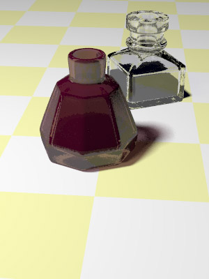

This is a sdl generated mesh object.  The idea was to transition from a
flat-sided body to a round cross-sectioned neck. ( Variations on that
transition are the design of many ink bottles.)
The macro must be fed x-y coordinates to describe the vertical profile
of the bottle in the form of an array. This array is submitted to Cris
Colefax's spline macro to produce a spline for the profile. The
horizontal cross-sections are produced from a macro based on a few
parameters like number of sides, size of bevel and tension. This macro
also outputs an array of points.  The diameter of each cross-section is
derived from the profile spline.  The cross-section array is used to
produce and store a cross-section spline.  A final macro walks these
cross-section splines and generates the mesh triangles.
At present the macro will not stand alone, the code must be tweeked for
each bottle to accomplish the transition from a sided scrossection to a
rounded cross-section.

Here is another bottle, and some ink in the earlier one
Download 'inkbottle.0016.jpg' (36 KB)
Preview of image 'inkbottle.0016.jpg'

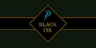

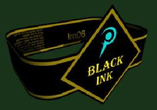

I've been working on a label generator over the last few days. The objects I
sent in for the 'office supplies' subject both needed labels, so I took the
code I wrote for them to make a generic labelling system. As of this morning
it generates either flat or cylindrical labels using layers of pigment to
incorporate combinations of POV-Ray objects and image maps.
By coincidence, yesterday I was thinking about how to do labels for rounded
boxes/superellipsoids though I haven't coded that up yet. I was thinking of
using the width, the depth and the roundness of the corners to control the
shape of a label. The label width would control how far around the sides of
the container the label stretched. Any ideas for anything that might make it
more useful to you?
Chris B.

From: William Tracy
Subject: Re: office supplies - ink bottle
Date: 10 Feb 2008 15:01:38
Message: <47af5822$1@news.povray.org>
The normals seem a touch overdone, but otherwise this is practically
perfect. :-)
William Tracy

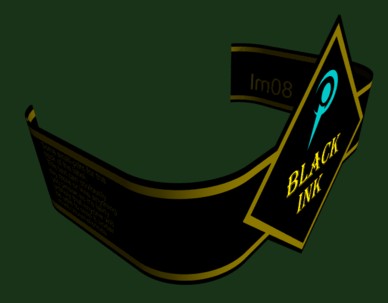

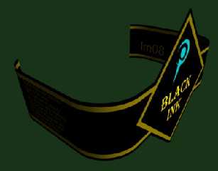

At the moment I've used CSG, but the SDL is split into two parts and
modularised to make it easy to extend:
1. There's a label design file, in which you can render the label design
laid out flat. The design is built up of as many layers as you need. Each
layer can contain image maps, POV-Ray pigments, object pigments, text blocks
etc.
2. There's a series of macros, each of which creates a label object of a
particular shape, based on standardised variables to control the size, then
wraps the texture around onto its surface. The Width variable defines how
far around the object the label extends and therefore defines whether it's
continuous or whether there's a gap round the back.

I did a rounded box label shape macro yesterday. Once I've wrapped a texture
onto it I'll post an image. Do you have a label design for the square
ink-bottle that I could maybe use as an example - a scan, a sketch or a
description that I could interpret?
Chris B.
From: Chris B
Date: 11 Feb 2008 19:12:48
Message: <47b0e480@news.povray.org>
"Chris B" <nom### [at] nomailcom> wrote in message
news:47b0295f$1@news.povray.org...
> texture
Here's what I've got so far. Virtually everything is configurable, including
all of the text and the shapes and colours used. The radius of the corners
and the lengths of the sides can all be set and the label will adjust itself
to fit. The width of the label can be the same as the circumference of the
bottle or less, in which case it'll wrap round the bottle for as far as
necessary.
The first image shows the label as it renders in design mode.
The second shows a label doing a complete circuit of a rounded box and
meeting at the back.
The third shows one that wraps round as far as the back corners.
Chris B.
