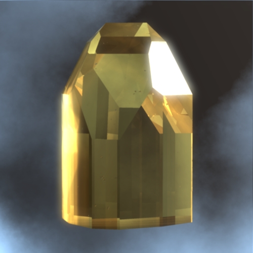

Hi everyone,
I discovered a way to accurately depict minerals with POV-Ray. I found a
demo version of a program called KrystalShaper
(http://www.jcrystal.com/products/krystalshaper/) which allows one to
view various crystal morphologies for different minerals. The demo
version does not allow you to save or export, but you can view the
Miller indices (http://en.wikipedia.org/wiki/Miller_index) of a
crystal's faces, and determine the angle between them.
Using the angles acquired from the program, I made an intersection of
planes to create the crystal. It would not be too difficult to randomize
the result to make unique, natural-looking specimens.
The render itself is nothing amazing, but the possibilities represented
by it are exciting!
Questions and comments, welcome as always!
Sam
Download 'topaz.jpg' (84 KB)
Preview of image 'topaz.jpg'

Nice image, all the nicer for the colour bleeding!

Actually I thought the render itself *was* pretty amazing.

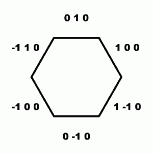

Look at the attached image. If we were talking just straight normals
here, the numbers would be decimals or very large integers. Instead, we
have angles represented by three small integers, ranging between -1 and
1 (they can be higher, I've seen them as high as 6).
I don't understand how the Miller indices work, but I know it has to do
with how molecules in the crystal are offset from one another. The
Wikipedia article just confused me, as I have no formal training in
higher mathematics.
If you have a way to calculate the normals for single faces (not the
angle between two faces), by all means, let me know! Otherwise, I'm off
to try the answer via Google....
Sam

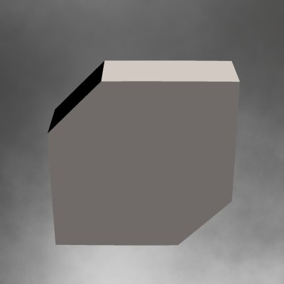

Attached is an image demonstrating the result of that approach.
Here is the code:
intersection{
  plane{z,1}
  plane{-z,1}
  plane{<0,-1,0>,3 }
  plane{<1,-1,0>,3 }
  plane{<1,0,0>,3 }
  plane{<0,1,0>,3 }
  plane{<-1,1,0>,3 }
  plane{<-1,0,0>,3 }
  pigment{rgb .5}
See the problem? These indices were supposed to make a hexagon, but
instead produced 90 and 45 degree angles. Am I missing something?
Sam

I agree with Jim's comments, and add my own comments of "fantastic"
I've been wanting to do something like this, but had no clue how.
Nor even the knowledge to ask the question. I started searching with
the keywords: mineral, crystal and facet; but in over my head.
Thanks for sharing.
I'll be lirking around hoping to benefit from you hard work.
Leef_me

This render is really beautiful! I'll keep a copy in my private depository
of 'Beautiful images'.
Miller indices, yes... it's coming slowly back now. I used to have a
'Wulff's net' to analyse crystal shapes
http://euromin.w3sites.net/Nouveau_site/histoire/dates/pic_hist/wulff11.htm
and we used the Miller indices to place the normals of the faces on this 3D
projection...
