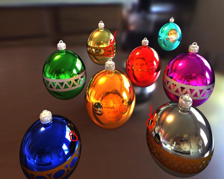

Hi
I'm getting strange black reflections on shiny balls.I'm usingt mlpov 0.8
with hdri. Anybody has an idea what is causing this?
The balls consits of two parts an inner ball with the following texture
#declare  lightyellowfinball =   finish { ambient 0 diffuse .0 reflection
{ <2.3,2.3,1>*1.1*0.9,<0.5,0.5,0.5>*0.9  } }
around this is a second ball slightly thicker
with the following texture map
#declare ttextur=   texture { pigment {rgbt <1,1,1,1>} normal {bumps 1 scale
.01}};
#if (strcmp(texturepic,"")!=0)
sphere{
0,1+0.001
      texture { uv_mapping
        image_pattern { gif texturepic  }
        texture_map {
                [0 uv_mapping ttextur]
                [1 uv_mapping textur scale 1/mapscale]
         scale mapscale
         translate <0,1.02*mapscale,0>
rotate <0,15,0>
translate <0,1,0>
this seems to work fine for the balls themselves, but the transparent part
of the reflections go black... When i render the same pic without the second
ball the reflections don't go black
Download 'HDRItest3.jpg' (70 KB)
Preview of image 'HDRItest3.jpg'

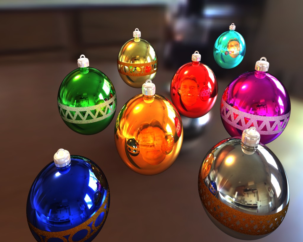

I changed the settings to
global_settings {
  radiosity {
    pretrace_start 0.08           // start pretrace at this size
    pretrace_end   0.04           // end pretrace at this size
    count 60                      // higher -> higher quality (1..1600) [35]
    nearest_count 5               // higher -> higher quality (1..10) [5]
    error_bound 1.8               // higher -> smoother, less accurate [1.8]
    recursion_limit 5             // how much interreflections are
calculated (1..5+) [3]
    low_error_factor .5           // reduce error_bound during last pretrace
step
    gray_threshold 0.0            // increase for weakening colors (0..1)
[0]
    minimum_reuse 0.015           // reuse of old radiosity samples [0.015]
    brightness 1                  // brightness of radiosity effects (0..1)
[1]
//    adc_bailout 0.01/2
    adc_bailout 1/64
    normal on                     // take surface normals into account [off]
  max_trace_level 26
This seems satisfactory to me, most disturbing black spots seem to be gone
now.
I plan to do an animation with this scene (hopefully ready by christmas
2007), so I guess I'll have to reduce the trace level to something like 17
make it faster
Thanks for the advice.
