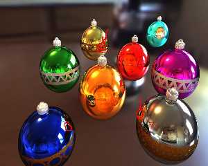

Hi
I'm getting strange black reflections on shiny balls.I'm usingt mlpov 0.8
with hdri. Anybody has an idea what is causing this?
The balls consits of two parts an inner ball with the following texture
#declare  lightyellowfinball =   finish { ambient 0 diffuse .0 reflection
{ <2.3,2.3,1>*1.1*0.9,<0.5,0.5,0.5>*0.9  } }
around this is a second ball slightly thicker
with the following texture map
#declare ttextur=   texture { pigment {rgbt <1,1,1,1>} normal {bumps 1 scale
.01}};
#if (strcmp(texturepic,"")!=0)
sphere{
0,1+0.001
      texture { uv_mapping
        image_pattern { gif texturepic  }
        texture_map {
                [0 uv_mapping ttextur]
                [1 uv_mapping textur scale 1/mapscale]
         scale mapscale
         translate <0,1.02*mapscale,0>
rotate <0,15,0>
translate <0,1,0>
this seems to work fine for the balls themselves, but the transparent part
of the reflections go black... When i render the same pic without the second
ball the reflections don't go black
Download 'HDRItest3.jpg' (70 KB)
Preview of image 'HDRItest3.jpg'

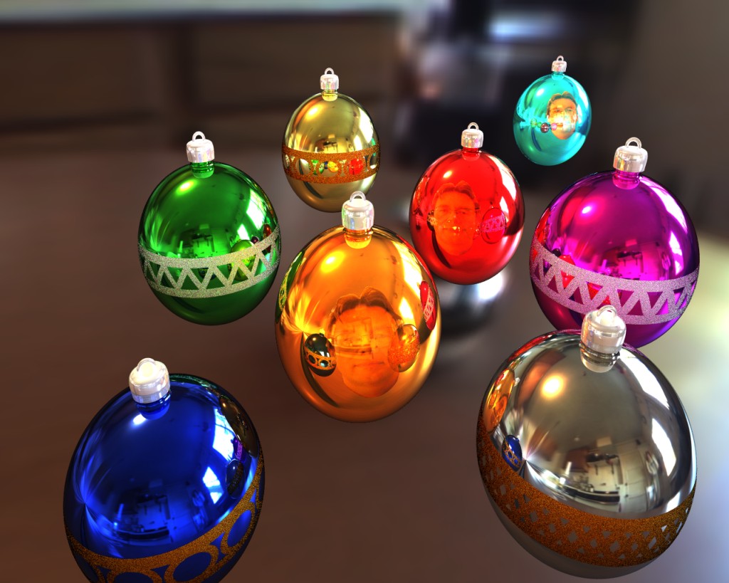

From: Orchid XP v3
Subject: Re: black reflections on shiny balls
Date: 27 Jan 2007 10:27:32
Message: <45bb6f64$1@news.povray.org>
I would guess you're hitting the max trace limit. Try adding this:
global_settings {max_trace_level 10}
(IIRC the default is 5. Check the documentation...)
From: Johan Feyaerts
Date: 27 Jan 2007 10:41:44
Message: <45bb72b8@news.povray.org>
yep that seems to work.
I don't really get why the trace level needs to increase when there is a
transparent layer around the shiny finish,but anyhow problem  is solved now.

From: Gail Shaw
Date: 27 Jan 2007 11:02:34
Message: <45bb779a@news.povray.org>
"Johan Feyaerts" <joh### [at] nospamhotmailcom> wrote in message
news:45bb72b8@news.povray.org...
now.
Max trace is the amount of objects that the light ray is allowed to
reflect/pass through before it returns the colour as black. With you putting
a transparent layer around each ball, you've doubled the number of
interactions (once for the transparent layer, once for the reflection)
I've got a scene that uses trees with alpha-mapped transparency and water
and because of those two, I need a max trace of about 90. If I remove the
trees, it's more like 10. If I remove the water, it's somewhere around 40.
Date: 27 Jan 2007 16:37:51
Message: <45bbc62f$1@news.povray.org>
Johan Feyaerts nous apporta ses lumieres en ce 27-01-2007 10:41:
> "Orchid XP v3" <voi### [at] devnull> wrote in message
> news:45bb6f64$1@news.povray.org...
Each time you reflect on a sphere, the trace level goes up by 3: 1 getting into
the transparent outer shell, 1 relecting on the iner reflective part, and 1 more
geting OUT of the transparent shell.
If the reflection hit 2 balls, it register 6 levels, 9 if it hits 3 balls. Add
one to reatch the background or any surrounding object.
So, for one ball, you need a Max_trace_level of at least 4. For 2, you need at
least 7, and 10 if you hit 3.
In your case, I'd go up to arount 15 or 17. For that scene, I'd go up to the max
of 255 and set adc_bailout to 1/128 or even as large as 1/64.
Note that there are many more max_trace_level related black spots than those you
spotted. I can find at least 8 more, and I probably missed some.

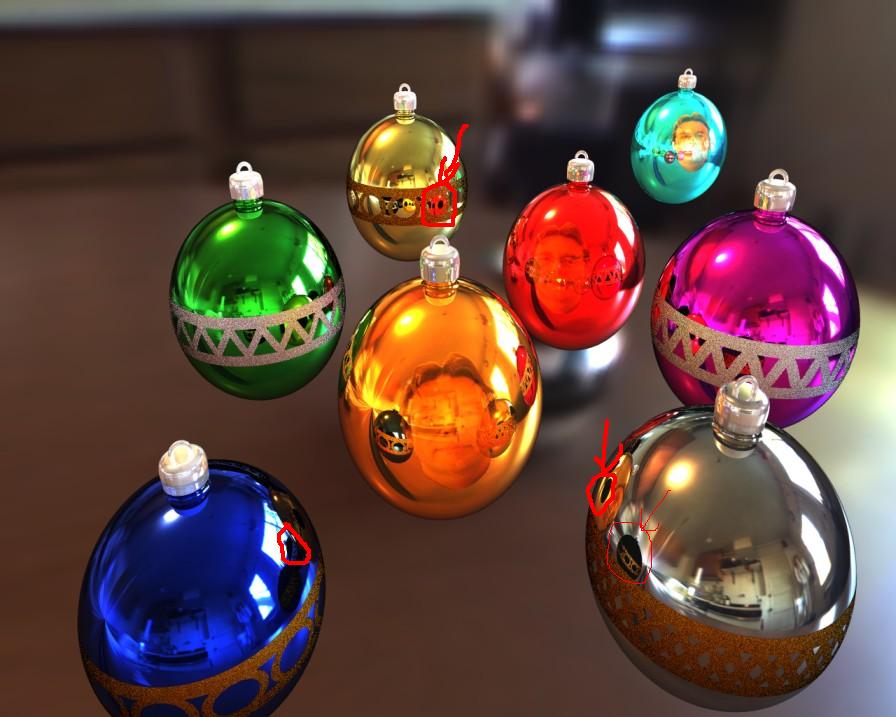

Date: 27 Jan 2007 17:37:07
Message: <45bbd413@news.povray.org>
I changed the settings to
global_settings {
  radiosity {
    pretrace_start 0.08           // start pretrace at this size
    pretrace_end   0.04           // end pretrace at this size
    count 60                      // higher -> higher quality (1..1600) [35]
    nearest_count 5               // higher -> higher quality (1..10) [5]
    error_bound 1.8               // higher -> smoother, less accurate [1.8]
    recursion_limit 5             // how much interreflections are
calculated (1..5+) [3]
    low_error_factor .5           // reduce error_bound during last pretrace
step
    gray_threshold 0.0            // increase for weakening colors (0..1)
[0]
    minimum_reuse 0.015           // reuse of old radiosity samples [0.015]
    brightness 1                  // brightness of radiosity effects (0..1)
[1]
//    adc_bailout 0.01/2
    adc_bailout 1/64
    normal on                     // take surface normals into account [off]
  max_trace_level 26
This seems satisfactory to me, most disturbing black spots seem to be gone
now.
I plan to do an animation with this scene (hopefully ready by christmas
2007), so I guess I'll have to reduce the trace level to something like 17
make it faster
Thanks for the advice.
