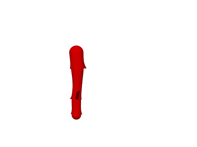

I've not used sphere_sweeps much, but perhaps someone can explain why mine
looks like it does in this image?  I thought I should see a nice smooth
transition from one sphere to the other...  Granted, I'm working on a small
scale (as the code below shows), so is this a precision problem?  I've tried
fiddling around, but I'm not understanding what's happening.
Any comments as to (a) what's wrong, and (b) how to fix this would be
greatly appreciated.
- How

why's everything so small?  camera angle of 1.5?!
perhaps that's the problem:  you're getting low accuracy from getting into
microscopic realm... also, i heard sphere_sweeps have issues when they are
very big.  perhaps they also have problems when very small...

Hrmph.  You're right, of course.  I got carried away in my scene, forgot I
had zoomed in to look at some detail or other, thought how neat it would be
to put a sphere_sweep riiiight here... and it's no wonder I've got weird
problems.  Once I backed out and made my shape correctly, things settled
down.
Thanks for the reality check, Nemesis!
