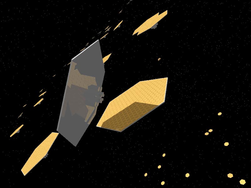

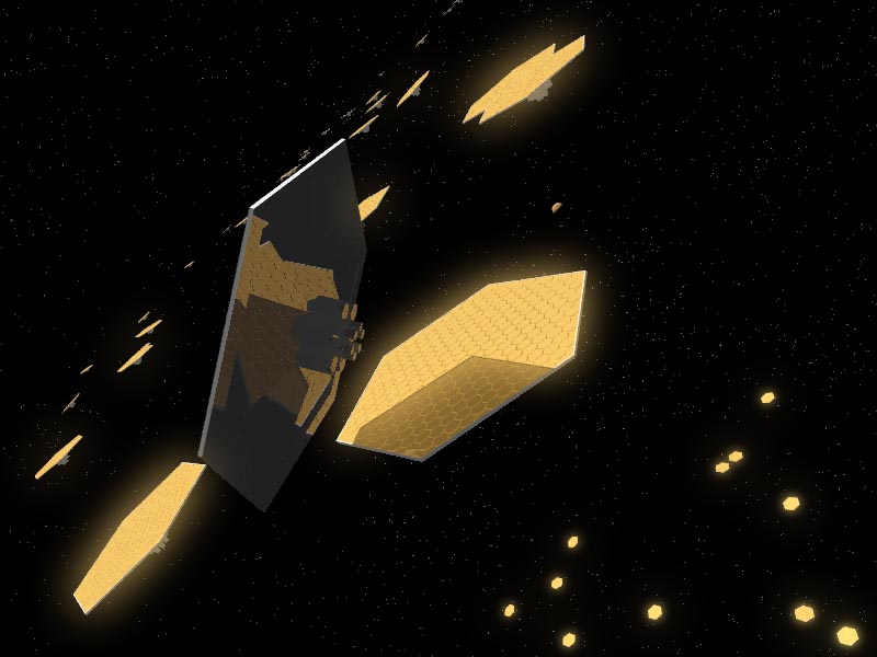

This is a scene not too far away in the future, maybe 50 years or so. the
dirty energy sources coal and oil are nearly empty, and mankind has finally
started to place large solar power stations in Mercury and Venus distance to
the sun. Those stations transmit the permanently huge amount of energy to
the Earth by radio.
This picture shows many of the large 2km-diameter solar power stations, one
just newly arriving and adjusting into the arrays of stations. Neccessary
power for their propulsion and interior comes straight from the sun.
Probably there will not be humans needed, everything automatic (which is
logical due its close position to the sun and far distance to Earth). You
can see, in a distance, the planet Mercury.
There are two images: one the final version, the other one how the render
result is originally. I am highly unsatisfied with the low contrast of the
white parts of the station, it is like ambient or getting some light. I
don't know, why. Maybe someone can help me to make it to a better scene. The
scene code is attached, as well.
Download 'SolarBases2.jpg' (64 KB) Download 'Solar Bases.pov.txt' (36 KB) Download 'SolarBases1.jpg' (62 KB)
Preview of image 'SolarBases2.jpg'
Preview of image 'SolarBases1.jpg'

Sven Littkowski nous apporta ses lumieres en ce 03/10/2006 20:39:
As those parts are away from the sun, they should be completely black, only
showing the reflection of the stars and other stations.
You can add default{finish{ambient 0 diffuse 1}} near the top of the scene.
Or, you can add ambient 0 in the finish of your textures.
As the metals.inc include textures with high ambient. I made mine without
ambient. (metals2.inc attached) Essential for radiosity scenes and case like
yours where ambient is unwellcome.
Note: in radiosity, "media on" enable emissive media only to affect radiosity
lighting. It enable such media to shed light on nearby objects. It have NO other
effect.

From: Sven Littkowski
Subject: Re: View to Tomorrow
Date: 10 Oct 2006 14:19:12
Message: <452be420@news.povray.org>
Thanks! It works now!
Sven

> // F_MetalE  :  Very highly polished & reflective.
> #declare F_MetalA  =
> finish {
>    ambient 0
>    brilliance 2
>    diffuse 0.3
>    metallic
>    specular 0.80
>    roughness 1/20
>    reflection 0.1
> #declare F_MetalB  =
> finish {
>    ambient 0
>    brilliance 3
>    diffuse 0.24
>    metallic
>    specular 0.70
>    roughness 1/60
>    reflection 0.25
> #declare F_MetalC  =
> finish {
>    ambient 0
>    brilliance 4
>    diffuse 0.15
>    metallic
>    specular 0.80
>    roughness 1/80
>    reflection 0.5
> #declare F_MetalD  =
> finish {
>    ambient 0
>    brilliance 5
>    diffuse 0.06
>    metallic
>    specular 0.80
>    roughness 1/100
>    reflection 0.65
> #declare F_MetalE  =
> finish {
>    ambient 0
>    brilliance 6
>    diffuse 0.03
>    metallic
>    specular 0.80
>    roughness 1/120
>    reflection 0.8
> // Equivalant en macro
> #macro MetFinish(Type)
>    #switch(Type)
>        #case(1) // Very soft and dull.
>            ambient 0.00
>            brilliance 2
>            diffuse 1.0
>            conserve_energy
>            metallic
>            specular 0.80
>            roughness 1/20
>            reflection { 0.05, 0.15 metallic }
>        #break
>        #case(2) // Fairly soft and dull.
>            ambient 0.00
>            brilliance 3
>            diffuse 1.0
>            conserve_energy
>            metallic
>            specular 0.70
>            roughness 1/60
>            reflection { 0.10, 0.25 metallic }
>        #break
>        #case(3) // Medium reflectivity. Holds color well.
>            ambient 0.00
>            brilliance 4
>            diffuse 1.0
>            conserve_energy
>            metallic
>            specular 0.80
>            roughness 1/80
>            reflection { 0.20, 0.50 metallic }
>        #break
>        #case(4) // Highly hard and polished. High reflectivity.
>            ambient 0.00
>            brilliance 5
>            diffuse 1.0
>            conserve_energy
>            metallic
>            specular 0.80
>            roughness 1/100
>            reflection { 0.25, 0.65 metallic }
>        #break
>        #case(5) // Very highly polished & reflective.
>            ambient 0.00
>            brilliance 6
>            diffuse 1.0
>            conserve_energy
>            metallic
>            specular 0.80
>            roughness 1/120
>            reflection { 0.30, 0.8 metallic }
>        #break
>    #end
> #end
> //                           METAL TEXTURES
> //                              BRASSES
> #declare T_Brass_1A = texture { pigment { P_Brass1 } finish {
> F_MetalA  } }
> #declare T_Brass_1B = texture { pigment { P_Brass1 } finish {
> F_MetalB  } }
> #declare T_Brass_1C = texture { pigment { P_Brass1 } finish {
> F_MetalC  } }
> #declare T_Brass_1D = texture { pigment { P_Brass1 } finish {
> F_MetalD  } }
> #declare T_Brass_1E = texture { pigment { P_Brass1 } finish {
> F_MetalE  } }
> #declare T_Brass_2A = texture { pigment { P_Brass2 } finish {
> F_MetalA  } }
> #declare T_Brass_2B = texture { pigment { P_Brass2 } finish {
> F_MetalB  } }
> #declare T_Brass_2C = texture { pigment { P_Brass2 } finish {
> F_MetalC  } }
> #declare T_Brass_2D = texture { pigment { P_Brass2 } finish {
> F_MetalD  } }
> #declare T_Brass_2E = texture { pigment { P_Brass2 } finish {
> F_MetalE  } }
> #declare T_Brass_3A = texture { pigment { P_Brass3 } finish {
> F_MetalA  } }
> #declare T_Brass_3B = texture { pigment { P_Brass3 } finish {
> F_MetalB  } }
> #declare T_Brass_3C = texture { pigment { P_Brass3 } finish {
> F_MetalC  } }
> #declare T_Brass_3D = texture { pigment { P_Brass3 } finish {
> F_MetalD  } }
> #declare T_Brass_3E = texture { pigment { P_Brass3 } finish {
> F_MetalE  } }
> #declare T_Brass_4A = texture { pigment { P_Brass4 } finish {
> F_MetalA  } }
> #declare T_Brass_4B = texture { pigment { P_Brass4 } finish {
> F_MetalB  } }
> #declare T_Brass_4C = texture { pigment { P_Brass4 } finish {
> F_MetalC  } }
> #declare T_Brass_4D = texture { pigment { P_Brass4 } finish {
> F_MetalD  } }
> #declare T_Brass_4E = texture { pigment { P_Brass4 } finish {
> F_MetalE  } }
> #declare T_Brass_5A = texture { pigment { P_Brass5 } finish {
> F_MetalA  } }
> #declare T_Brass_5B = texture { pigment { P_Brass5 } finish {
> F_MetalB  } }
> #declare T_Brass_5C = texture { pigment { P_Brass5 } finish {
> F_MetalC  } }
> #declare T_Brass_5D = texture { pigment { P_Brass5 } finish {
> F_MetalD  } }
> #declare T_Brass_5E = texture { pigment { P_Brass5 } finish {
> F_MetalE  } }
> //                           COPPERS & BRONZES
> #declare T_Copper_1A = texture { pigment { P_Copper1 } finish {
> _MetalA  } }
> #declare T_Copper_1B = texture { pigment { P_Copper1 } finish {
> _MetalB  } }
> #declare T_Copper_1C = texture { pigment { P_Copper1 } finish {
> _MetalC  } }
> #declare T_Copper_1D = texture { pigment { P_Copper1 } finish {
> _MetalD  } }
> #declare T_Copper_1E = texture { pigment { P_Copper1 } finish {
> _MetalE  } }
> #declare T_Copper_2A = texture { pigment { P_Copper2 } finish {
> _MetalA  } }
> #declare T_Copper_2B = texture { pigment { P_Copper2 } finish {
> _MetalB  } }
> #declare T_Copper_2C = texture { pigment { P_Copper2 } finish {
> _MetalC  } }
> #declare T_Copper_2D = texture { pigment { P_Copper2 } finish {
> _MetalD  } }
> #declare T_Copper_2E = texture { pigment { P_Copper2 } finish {
> _MetalE  } }
> #declare T_Copper_3A = texture { pigment { P_Copper3 } finish {
> _MetalA  } }
> #declare T_Copper_3B = texture { pigment { P_Copper3 } finish {
> _MetalB  } }
> #declare T_Copper_3C = texture { pigment { P_Copper3 } finish {
> _MetalC  } }
> #declare T_Copper_3D = texture { pigment { P_Copper3 } finish {
> _MetalD  } }
> #declare T_Copper_3E = texture { pigment { P_Copper3 } finish {
> _MetalE  } }
> #declare T_Copper_4A = texture { pigment { P_Copper4 } finish {
> _MetalA  } }
> #declare T_Copper_4B = texture { pigment { P_Copper4 } finish {
> _MetalB  } }
> #declare T_Copper_4C = texture { pigment { P_Copper4 } finish {
> _MetalC  } }
> #declare T_Copper_4D = texture { pigment { P_Copper4 } finish {
> _MetalD  } }
> #declare T_Copper_4E = texture { pigment { P_Copper4 } finish {
> _MetalE  } }
> #declare T_Copper_5A = texture { pigment { P_Copper5 } finish {
> _MetalA  } }
> #declare T_Copper_5B = texture { pigment { P_Copper5 } finish {
> _MetalB  } }
> #declare T_Copper_5C = texture { pigment { P_Copper5 } finish {
> _MetalC  } }
> #declare T_Copper_5D = texture { pigment { P_Copper5 } finish {
> _MetalD  } }
> #declare T_Copper_5E = texture { pigment { P_Copper5 } finish {
> _MetalE  } }
> //                           CHROMES & STEELS
> #declare T_Chrome_1A = texture { pigment { P_Chrome1 } finish {
> _MetalA  } }
> #declare T_Chrome_1B = texture { pigment { P_Chrome1 } finish {
> _MetalB  } }
> #declare T_Chrome_1C = texture { pigment { P_Chrome1 } finish {
> _MetalC  } }
> #declare T_Chrome_1D = texture { pigment { P_Chrome1 } finish {
> _MetalD  } }
> #declare T_Chrome_1E = texture { pigment { P_Chrome1 } finish {
> _MetalE  } }
> #declare T_Chrome_2A = texture { pigment { P_Chrome2 } finish {
> _MetalA  } }
> #declare T_Chrome_2B = texture { pigment { P_Chrome2 } finish {
> _MetalB  } }
> #declare T_Chrome_2C = texture { pigment { P_Chrome2 } finish {
> _MetalC  } }
> #declare T_Chrome_2D = texture { pigment { P_Chrome2 } finish {
> _MetalD  } }
> #declare T_Chrome_2E = texture { pigment { P_Chrome2 } finish {
> _MetalE  } }
> #declare T_Chrome_3A = texture { pigment { P_Chrome3 } finish {
> _MetalA  } }
> #declare T_Chrome_3B = texture { pigment { P_Chrome3 } finish {
> _MetalB  } }
> #declare T_Chrome_3C = texture { pigment { P_Chrome3 } finish {
> _MetalC  } }
> #declare T_Chrome_3D = texture { pigment { P_Chrome3 } finish {
> _MetalD  } }
> #declare T_Chrome_3E = texture { pigment { P_Chrome3 } finish {
> _MetalE  } }
> #declare T_Chrome_4A = texture { pigment { P_Chrome4 } finish {
> _MetalA  } }
> #declare T_Chrome_4B = texture { pigment { P_Chrome4 } finish {
> _MetalB  } }
> #declare T_Chrome_4C = texture { pigment { P_Chrome4 } finish {
> _MetalC  } }
> #declare T_Chrome_4D = texture { pigment { P_Chrome4 } finish {
> _MetalD  } }
> #declare T_Chrome_4E = texture { pigment { P_Chrome4 } finish {
> _MetalE  } }
> #declare T_Chrome_5A = texture { pigment { P_Chrome5 } finish {
> _MetalA  } }
> #declare T_Chrome_5B = texture { pigment { P_Chrome5 } finish {
> _MetalB  } }
> #declare T_Chrome_5C = texture { pigment { P_Chrome5 } finish {
> _MetalC  } }
> #declare T_Chrome_5D = texture { pigment { P_Chrome5 } finish {
> _MetalD  } }
> #declare T_Chrome_5E = texture { pigment { P_Chrome5 } finish {
> _MetalE  } }
> //                               SILVERS
> #declare T_Silver_1A = texture { pigment { P_Silver1 } finish {
> _MetalA  } }
> #declare T_Silver_1B = texture { pigment { P_Silver1 } finish {
> _MetalB  } }
> #declare T_Silver_1C = texture { pigment { P_Silver1 } finish {
> _MetalC  } }
> #declare T_Silver_1D = texture { pigment { P_Silver1 } finish {
> _MetalD  } }
> #declare T_Silver_1E = texture { pigment { P_Silver1 } finish {
> _MetalE  } }
> #declare T_Silver_2A = texture { pigment { P_Silver2 } finish {
> _MetalA  } }
> #declare T_Silver_2B = texture { pigment { P_Silver2 } finish {
> _MetalB  } }
> #declare T_Silver_2C = texture { pigment { P_Silver2 } finish {
> _MetalC  } }
> #declare T_Silver_2D = texture { pigment { P_Silver2 } finish {
> _MetalD  } }
> #declare T_Silver_2E = texture { pigment { P_Silver2 } finish {
> _MetalE  } }
> #declare T_Silver_3A = texture { pigment { P_Silver3 } finish {
> _MetalA  } }
> #declare T_Silver_3B = texture { pigment { P_Silver3 } finish {
> _MetalB  } }
> #declare T_Silver_3C = texture { pigment { P_Silver3 } finish {
> _MetalC  } }
> #declare T_Silver_3D = texture { pigment { P_Silver3 } finish {
> _MetalD  } }
> #declare T_Silver_3E = texture { pigment { P_Silver3 } finish {
> _MetalE  } }
> #declare T_Silver_4A = texture { pigment { P_Silver4 } finish {
> _MetalA  } }
> #declare T_Silver_4B = texture { pigment { P_Silver4 } finish {
> _MetalB  } }
> #declare T_Silver_4C = texture { pigment { P_Silver4 } finish {
> _MetalC  } }
> #declare T_Silver_4D = texture { pigment { P_Silver4 } finish {
> _MetalD  } }
> #declare T_Silver_4E = texture { pigment { P_Silver4 } finish {
> _MetalE  } }
> #declare T_Silver_5A = texture { pigment { P_Silver5 } finish {
> _MetalA  } }
> #declare T_Silver_5B = texture { pigment { P_Silver5 } finish {
> _MetalB  } }
> #declare T_Silver_5C = texture { pigment { P_Silver5 } finish {
> _MetalC  } }
> #declare T_Silver_5D = texture { pigment { P_Silver5 } finish {
> _MetalD  } }
> #declare T_Silver_5E = texture { pigment { P_Silver5 } finish {
> _MetalE  } }
> //                       Macros Standard Metals
> #macro MetalTex(Type, Col, Fin)
>    #if(strcmp(Type, "Gold")=0) pigment { GoldCol(Col) } #end
>    #if(strcmp(Type, "Silver")=0) pigment { SilverCol(Col) } #end
>    #if(strcmp(Type, "Brass")=0) pigment { BrassCol(Col) } #end
>    #if(strcmp(Type, "Copper")=0) pigment { CopperCol(Col) } #end
>    #if(strcmp(Type, "Chrome")=0) pigment { ChromeCol(Col) } #end
>    #if(strcmp(Type, "Iron")=0) pigment { IronCol(Col) } #end
>    finish { MetFinish(Fin) }
> #end
> //                        User-defined metallic texture
> #macro MetalCol(Col, Fin)
>    pigment { rgb Col }
> #end
> #version Metals_Inc_Temp;
> #end
From: EagleSun
Date: 11 Oct 2006 22:00:00
Message: <web.452da0ea2797d75c5862e4250@news.povray.org>
"Sven Littkowski" <sve### [at] jamaica-focuscom> wrote:
Hi Sven!
> the Earth by radio.
Yeah I see it!  Pretty cool!
Have you had any luck using my atmosphere code?
