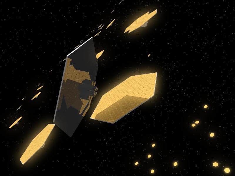

This is a scene not too far away in the future, maybe 50 years or so. the
dirty energy sources coal and oil are nearly empty, and mankind has finally
started to place large solar power stations in Mercury and Venus distance to
the sun. Those stations transmit the permanently huge amount of energy to
the Earth by radio.
This picture shows many of the large 2km-diameter solar power stations, one
just newly arriving and adjusting into the arrays of stations. Neccessary
power for their propulsion and interior comes straight from the sun.
Probably there will not be humans needed, everything automatic (which is
logical due its close position to the sun and far distance to Earth). You
can see, in a distance, the planet Mercury.

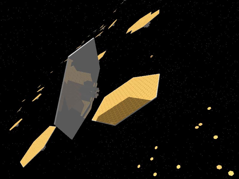

There are two images: one the final version, the other one how the render
result is originally. I am highly unsatisfied with the low contrast of the
white parts of the station, it is like ambient or getting some light. I
don't know, why. Maybe someone can help me to make it to a better scene. The
scene code is attached, as well.
Download 'SolarBases2.jpg' (64 KB) Download 'Solar Bases.pov.txt' (36 KB) Download 'SolarBases1.jpg' (62 KB)
Preview of image 'SolarBases2.jpg'
Preview of image 'SolarBases1.jpg'
Subject: Re: View to Tomorrow
Date: 3 Oct 2006 21:49:18
Message: <4523131e$1@news.povray.org>
Sven Littkowski nous apporta ses lumieres en ce 03/10/2006 20:39:
As those parts are away from the sun, they should be completely black, only
showing the reflection of the stars and other stations.
You can add default{finish{ambient 0 diffuse 1}} near the top of the scene.
Or, you can add ambient 0 in the finish of your textures.
As the metals.inc include textures with high ambient. I made mine without
ambient. (metals2.inc attached) Essential for radiosity scenes and case like
yours where ambient is unwellcome.
Note: in radiosity, "media on" enable emissive media only to affect radiosity
lighting. It enable such media to shed light on nearby objects. It have NO other
effect.
Don't cry because it is over, smile because it happened.

From: Sven Littkowski
Date: 10 Oct 2006 14:19:12
Message: <452be420@news.povray.org>
Thanks! It works now!
Sven
