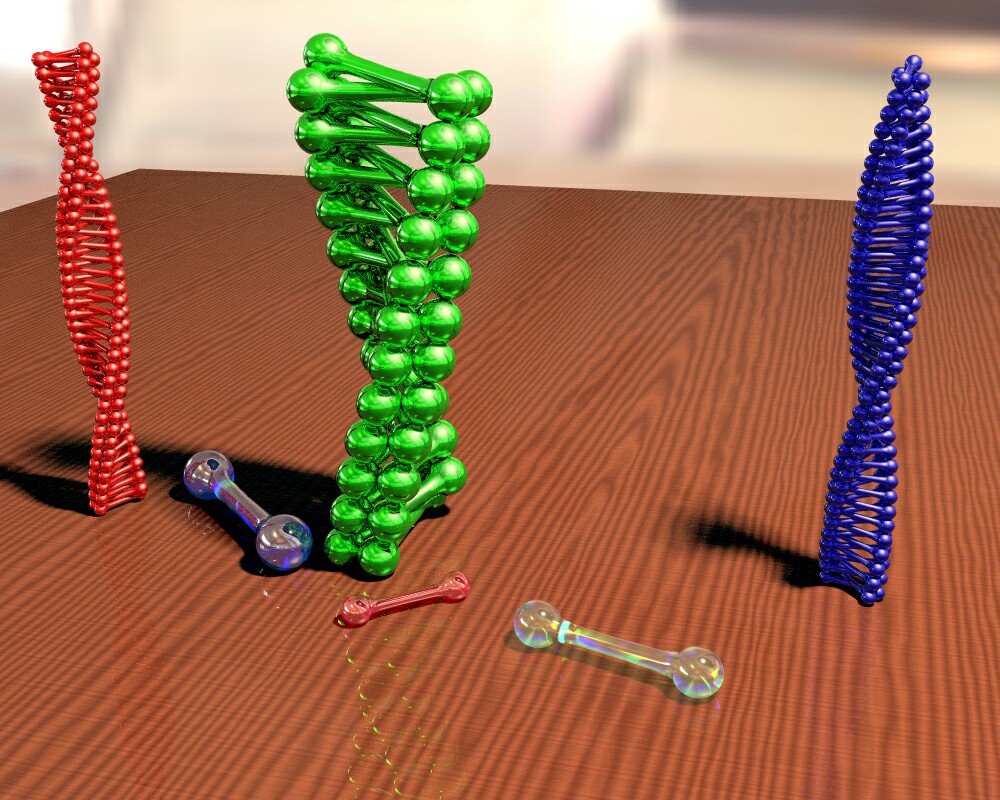

Something for the weekend for you to look at and ponder.
  Photons were used, but there's no resulting 'sparklies'. Probably because
I used an ior of 1.458 for a quartz effect on the three single barbells.
(What's with those bright bands on the blue and bright green barbells?)
   The shadows look weird to me too. The blue barbell has a solid shadow,
and the other two don't. (?)
   Anyway, it took about 8.5 hours to render with +a0.0.
      ~Steve~

When using photons, all transparent objects throw solid shadows. If the
photons don't reach through the green barbell, you'll retain the solid
shadow. How deep did you set the trace_level for the photons? I'm not
sure if they can get through such complex objects...
+a0.0 with which recursion level and antialiasing method? That's
important as well, you know... ;-)
Overall, a nice, simple image and clean image. The wood could use some
more irregularities, and personally I'd like some more dramatic lighting
effects (a la sparklies, or just a different mood in lighting), but it's
a nice one. It's a little heavy towards the left side (more objects and
color differences there), so if you'd switch sides, it could be a good
backdrop for Windows-Desktops with lots of icons. :-)
> shadow. How deep did you set the trace_level for the photons? I'm not sure
     Just checked: max_trace_level 5
> +a0.0 with which recursion level and antialiasing method? That's important
     No, I didn't do a recursion level. Stumped now with this new term...
     This is what I did do though...
   //CODE
  global_settings {
  assumed_gamma 1
  max_trace_level 5
  #if (Photons)
    photons {
      spacing .03
      gather 20, 100
      jitter 1.0
      adc_bailout 1/255
      autostop 100
      radius 100
      // (---Adaptive Search Radius---)
      //steps 1
      expand_thresholds 0.2, 40
    }#end}
  And, LOL! In my interior statement, I DID forget to lower my
dispersion_samples from playing around before!
    I had it set at 140 for this image.... <sigh, whistles almost
silently....>   :-o -->>>
   Thank you Tim.
> effects (a la sparklies, or just a different mood in lighting), but it's a
    Heh, that did cross my mind as I had loads of DT icons! (Now cleaned
up).  :o)
    ~Steve~
