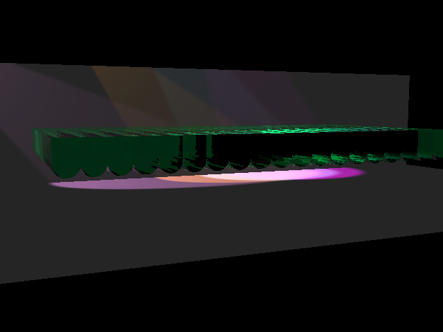

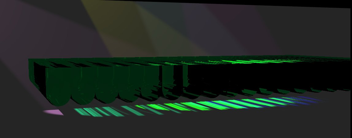

Image showing light refraction of inverted lenticular, but
Even though I have color set up white, my transparent material turns green.
I've tried all tehse settings:
   //   rgbft <1,1,1,0.9,0.1>
   //color transmit 1.0
   color red 1.0  green 1.0  blue 1.0  filter 1.0
If I use
 // color rgbt <1.000000, 1.000000, 0.000000, 0.000000>
I get no photons being generated.
Any ideas,
Sorry for newbie question
Download 'lent_test3.JPG' (35 KB)
Preview of image 'lent_test3.JPG'

I think we'll need to see more or your scene file. What photon settings are
you using? What is in the interior{} block of your lenticular object?
What's its dispersion setting?
[In POV 3.5 there was a bug that produced greenish spots if fresnel &
conserve-energy were both used for a transparent object, but it was a
different shade of green]
> If I use
That's just opaque yellow.
What do you mean? That you don't see photon effects, or that POV doesn't
even shoot any photons?
> Any ideas, Sorry for newbie question
Since you're new, my advice is to try playing with the standard glass
textures (in glass.inc) first & modify them to see what happens before
trying to create your own transparent materials.
PS. Your scene is very dark. What's your gamma setting?

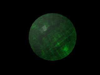

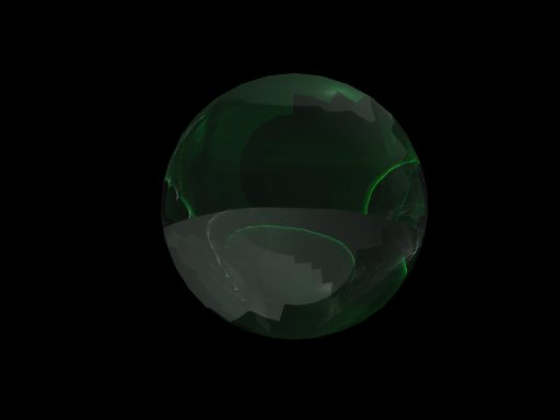

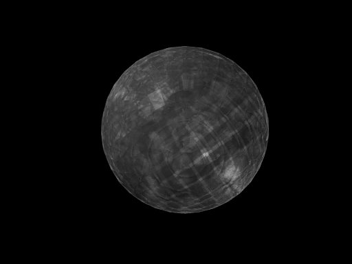

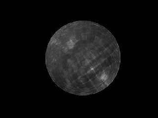

Getting closer to this problem with a smaller object - it seems the normals
are all messed up - got one image that looks like the ghost in the machine.
Suspecting the converter so , am now trying with the normals exported also
and parts of the sphere are now non coloured, but still some weird green tis
there. See pic 1&2.

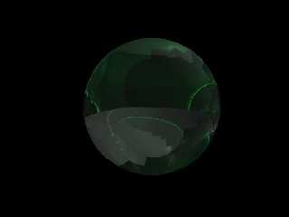

I found the problem, or at least the solution, still dont understadn where
the green came from, but I had dispersion on and for some reason my shapes
always dispersed to green.  With dispersion 1.0, the green goes away.  Stil
some eird textures inside my spehere though.
        interior {ior 1.10 dispersion 1.0 dispersion_samples 7}

dispersion 1 = NO dispersion

the global_settings block (in your file "lent_test3_a.inc") you'll get an
image like this (no_photons.png).
And, perhaps if you use this include file perhaps set:
count 1000000
instead of
space 0.03
That'll reduce the number of photons to 1 Mio and renders much faster. Do
this at least when you're testing.
Your last posting:
I don't know what this test sphere is all about.
To your idea with the normals:
See next post.
Yours,
Bu.
Download 'no_photons.png' (32 KB)
Preview of image 'no_photons.png'
Aha!  I think i found something.  I had suspected that dispersion had
something to do with it, and your dispersion 1.0 trial confirms it.
From lent_test3.pov:
> interior {ior 1.10 dispersion 1.2 dispersion_samples 3}
I've noticed that photons don't quite honor the dispersion count; it is as
if the photons undercount the dispersion_samples by 2.  With your
dispersion_samples set at 3, you'll only have one color to work with--the
middle color of the spectrum, *green*.
(I haven't attempted to report this as a bug because it's less painful to
increase dispersion_samples by 2 than to bother the POV Team.)
Also, be careful with your dispersion compared to your ior.  At ior 1.1
dispersion 1.2, if i understand this right (not guaranteed!), the red will
not refract at all.

You prompted me to do a small test:
	interior{ior 1.2 dispersion 1.5 dispersion_samples 44}
Using a simple prism with rgbt 3 to boost the spectra brightness.
The red does refract a little. If I raise the dispersion to 1.6, the red refract UP
'the' is a registered trademark of Microsoft Corporation
Download 't8.jpg' (2 KB)
Preview of image 't8.jpg'
