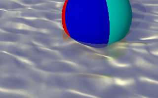

From: David El Tom
Subject: Re: Seashore (wip)
Date: 29 Sep 2005 02:28:46
Message: <433b899e@news.povray.org>
Paolo Gibellini wrote:
> Ok, this is one test of blur averaging the normals.
> Rendering becomes sloooow, and my test are made with not much normals, but
> the result is interesting.
> This weekend I will end the test and post sources.
> Bye,
> Paolo
Hi Paolo,
just a quick shot of yesterday evening. I know the water texture is
pooooooor compared to yours, but it shows the effect I wanted to point out.
Slightly blurred normals (10 textures averaged) gives you the feeling of
slightly motion blurred image (as the water geometry alters coninously)
and overcome this hyperrealistic snapshot effect of to accurate reflections.
... dave

From: Paolo Gibellini
Date: 29 Sep 2005 10:01:40
Message: <433bf3c4$1@news.povray.org>
I think I've understood the concept, my main difficulty now is perform test
in decent times.
I'm trying to render 8 textures averaged and I've estimate a render time of
3 days...
Paolo
