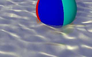

just a quick shot of yesterday evening. I know the water texture is
pooooooor compared to yours, but it shows the effect I wanted to point out.
Slightly blurred normals (10 textures averaged) gives you the feeling of
slightly motion blurred image (as the water geometry alters coninously)
and overcome this hyperrealistic snapshot effect of to accurate reflections.
... dave
