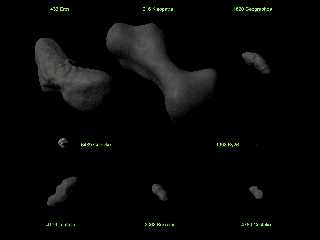

Got these asteroid models from:
http://astronomy.swin.edu.au/%7Epbourke/terrain/asteroid2/
Only textured surfaces here, not like the kind described by Paul Bourke at:
http://astronomy.swin.edu.au/~pbourke/terrain/asteroid/
I was trying to render some kind of asteroid thing for temporary Windows
wallpaper after finding these. Was looking for a model of Comet Tempel when
I found them, for rendering a simple Deep Impact (the July 4th
comet/projectile) collision scene. Began it by using isosurface and
scattering media, except the isosurface was merely a random shape.
Anyway... This picture has the scales all wrong-- in a sense. Kleopatra is
the largest, being 217 km long, and Eros is only 33 km. Instead of making
them equal to each other I chose scale their sizes and move them closer or
farther from the camera. Yes, it is supposed to be dark since asteroids
would typically be dark to our eyes. I made the attempt to use relative
brightnesses between all of them, too. Don't expect accuracy in any of it,
only for fun.
Asteroid Ky26 is a speck of just about 30 meters, and it's also the darkest
one. Golevka is the brightest, also small at only 350 meters. Both are shown
4X closer than the bottom three. And Geographos is 5X farther away as them
(Ky26, Golevka). Then, Eros is about 1.5X farther out than Geographos, and
Kleopatra is around 20X beyond Eros. Confusing, sorry. It seemed the
quickest way to get it rendered and still have some proper scaling.
Yeah, I know, they only look vaguely like space rocks. Thought I'd show how
strange they can be if you aren't familiar with them already. Maybe I'll be
able to make better cratered surfaces without resorting to image/bump maps
someday but this isn't the day.
Thanks for looking!
Bob Hughes
Download 'asteroids.jpg' (90 KB)
Preview of image 'asteroids.jpg'

I'm sure the shape-data is accurate as can be, but the texture
looks weird. I would not expect to vary between reddish/bluish
gray. Maybe more like 6489 Golevka (even though I'm sure it's
also the same texture), at least, as a global feeling.
Best,
        S.

Thanks for the comments Steven.
Yes, intermediate-sized ones look better to me too. Eros and Kleopatra have
one more layer of crackle pigment and normal added to them to use two
different sizes of craters. Or at least what is supposed to be craters. I
muted the colors a lot since the first renderings I did. I was trying for
something like the Galileo spacecraft photos of Gaspra and Ida, as seen in
the color pictures at:
http://nssdc.gsfc.nasa.gov/photo_gallery/photogallery-asteroids.html
I think most people think of asteroids as being only grey or a grey-brown,
grey-blue. I'm not sure how realistic any of the photos are of those I've
seen but I still can't get it to look right. I believe all are over-exposed.
Bob Hughes

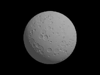

Bob Hughes wrote:
Nice texturing.
show how strange they can be if you aren't familiar with them already.
Maybe I'll be able to make better cratered surfaces without resorting to
image/bump maps someday but this isn't the day.
An idea for some Q&D craters
#local S = seed(1234);
#local DensityCurve =
spline {
    0/2 <0,0,0>
    1/2 <.5,.15,0>
    2/2 <1,1,0>
#local PN =
pigment {
    average
    pigment_map {
       #local I=0;#while(I<256)
           #local ScaleFactor = DensityCurve(rand(S)).y;
           [1
               cylindrical
               scale  .15*ScaleFactor
               #local ScaleFactor =  .5*ScaleFactor;
               poly_wave .8
               pigment_map {
                       [0 rgb   .1]
                       [.1 rgb  10*(1-ScaleFactor)]
                       [.2 rgb -20*(1-ScaleFactor)]
                       [1 rgb  -30*(1-ScaleFactor)]
               rotate <rand(S)*180,rand(S)*180,rand(S)*180>
       #local I=I+1;#end
sphere {
    0, 2
    pigment { rgb .6 }
    normal {
       pigment_pattern {
          average
          pigment_map {
             #local Scl  = 1;
             #local I=0;#while(I<12)
                     [1
                         PN
                         scale Scl
                     #local Scl=Scl*.8;
             #local I=I+1;#end
       bump_size 15
Download 'img.00062.jpg' (38 KB)

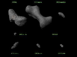

Thanks Jim, only a simple layered texture though. It's crackle form
<1.25,0,0.25>, which was just trial and error to get. Here it is, with
different finish statements and lowest layer (minus uppermost layer, too).
camera {
  location  <0, 0, -3>
  look_at   <0, 0, 0>
light_source {
 <100,100,-100>, 1
sphere {
  0, 1
  texture {
   pigment {
    color rgb 0.5
 texture {
  pigment {
   crackle form <1.25,0,0.25> scallop_wave turbulence 0.1 scale 0.1
   color_map {
    [0 color rgbf <0.7,0.65,0.625,1>]
    [0.3 color rgbf <0.55,0.525,0.5,1>]
    [0.7 color rgbf <0.45,0.5,0.5,1>]
    [1 color rgbf <0.425,0.425,0.45,1>]
  normal {
   crackle -0.7 form <1.25,0,0.25> scallop_wave turbulence 0.1 scale 0.1
  finish {
   specular 0.1 roughness 0.01
 texture {
  pigment {
   crackle form <1.25,0,0.25> scallop_wave turbulence 0.125 scale 0.033
   color_map {
    [0 color rgbt <0.7,0.65,0.625,0.9>]
    [0.3 color rgbt <0.55,0.525,0.5,0.9>]
    [0.7 color rgbt <0.45,0.5,0.5,0.9>]
    [1 color rgbt <0.425,0.425,0.45,0.9>]
  normal {
   crackle -0.85 form <1.25,0,0.25> scallop_wave turbulence 0.125 scale
0.033
  finish {
I'm looking yours over now, trying to understand it.
Clever thing... although, I am finding it to be very slow to render. Since
you used 'average' I'm trying that with the layered crackle patterns now and
it looks better that way.
Should be able to create an isosurface with real surface variations instead
of faking it with a normal; unfortunately, the asteroid mesh models made
that impossible.
You might want to rethink the "Q&D" and say S&C (slow and clean). Only
joking.
> joking.
LOL!
Yes it is very slow. Agreed.
In the code the, ScalingFactor is just an attempt to produce more little
ones than big ones, and at the same time make the little ones inverse
proportionately deeper.
Defining the pigment beforehand is just an attempt to get around the
limit of 256 terms to be averaged.
Also I think it looks better, or at least closer to your example, with
poly_wave set between 1 and 4.
The crater profile is mostly about the pigment_map of course
Otherwise just a bunch of averaged cylindricals rotated and scaled randomly.
Yes Slow. My example rendered -aa in about 5 minutes.
That you would use the idea or something similar to augment your texture
was what I was thinking.  With a little less random, but rather more
judicious application, you might get faster times and better effects.
Subject: Re: some cratering using your idea [18kb JPG]
Date: 17 Jul 2005 15:05:08
Message: <42daabe4@news.povray.org>
news:42da75dc$1@news.povray.org...
I've tried it with poly_wave 1.8 and I see what you are saying about that.
It isn't slow enough to matter, I guess, if doing mainly a cratered
planetoid anyway. In fact, I've tried it with 50 iterations for the first
loop and 25 for the second and using default AA it was 3 minutes 50 seconds
(on a 2GHz CPU here) to do the attached image.
I changed the average value to be rand(S), too, so it could have old and
young craters mixed together. I'm thinking that to use this appropriately on
irregular shapes, like those asteroids, it might be a good idea to try and
match the surface normal using trace in some way. Something to think about
anyhow, not sure I'll ever get around to it though.
Thanks a bunch for sharing this other way Jim.
Bob Hughes
Download 'jccratersrandomaverage.jpg' (14 KB)
Preview of image 'jccratersrandomaverage.jpg'

Subject: Re: changed cratering [~168kb JPG]
Date: 18 Jul 2005 04:29:27
Message: <42db6867@news.povray.org>
news:42dabb42@news.povray.org...
> I've always preferred using an inverted granite pattern---8<---
> //moon
> light_source { <-1,1,-1>*1000, rgb 1 }
> sphere {
> z*3, 1
> pigment { rgb 1 }
> finish { diffuse 1 ambient 0 }
> normal {
> pigment_pattern { granite } -.2
> accuracy 1/5000
Hadn't seen it done that way before.
I did use a small scale negative granite normal on the topmost layer, it
just isn't very obvious. I realize now I overlooked adding a no_bump_scale
keyword to prevent the depth from scaling after applying it to the
asteroids, which were then scaled. Of course that meant readjusting the
normals.
Attaching the changed (rescaled textures) image here.
Download '8asteroids.jpg' (124 KB)
Preview of image '8asteroids.jpg'
