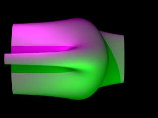

Hi peeps.
Remember this? (Yeah, it's only a short render.)
Anyway, somebody wanted the code...

Top tip: Take out the max() function and watch the render drop from 350
pixels/second to 50 pixels/second. :-)
As-is, renders the attached image. Took 4 minutes on my shiny new AMD64
machine - but running in 32-bit mode. :-( The part you'll want to change
is the isosurface function; if you change that 0 to some other figure,
interesting things can happen. (Maybe you even wanna animate it?)
Alternatively, change to InitP(x, y, z, 0) to swap the hyperplanes
round. (Remember, you're drawing a 3D slice of a 4D shape!)
Also, InitP() draws the M+ set. The *Mandelbrot* set is the intersection
of the M+ set and the M- set. (Use InitM() for M-.) It can be most
interesting to draw both sets at once. Use a different pigment for each
isosurface - and it looks best with x, y, z, 0 rather than z, 0, x, y.
Also of interest: slice the isosurface and stick a matching 2D plot on
the cross-section! (I will do this later if I figure out pigment
functions...)
Download 'cubic2.png' (23 KB)
Uh... yeah... forgot to mention. The *reason* is that without max(), you
have to set max_gradient exp(17) to get a picture. :-| But with max() in
there, you can set it very much lower and it renders correctly.
Change #declare Iterations = 2; to something else to make the surface
more complicated. (And slower to render!) You may need to increase the
max_gradient a notch also; let it render and see if it's OK.

weird. FWIW, it looks like a sculpture of the rear end of an animal, lying
on it's side. not that i've seen any sculptures of rear ends of animals
lying on their sides.
At first glance, it didn't look much like anything but what it was
described as, but now that you mention it.. He should put some zebra
stripes on that thing..

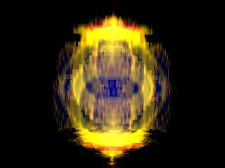

I wanted to modify it to the basic Mandelbrot so I could try and find
the Buddhabrot. No luck as I can't code to save myself. I did come up
with this though and I quite like it. I think I'll call it the
Sumobrot. I used Mike's modification to create 3 df3's and played
about with emitting media. Let your eyes go slightly out of focus.
Regards
        Stephen
Download 'Sumobrot.png' (201 KB)
Preview of image 'Sumobrot.png'
Wow.  Miss a few days, miss a lot.  I'm searching but not finding examples
of "Mike's modification" or "df3s" and I really want to figure this out!
So, please help.  Source perhaps?  Or of your less out-of-focus version
below?  I haven't puzzled out df3's yet.  Maybe this example would soak in.
Thanks
(Really cool by the way, yours and Andrew's and as always, Mike's)
Dave Matthews
Mikes Modification (sounds important like Tim's error in fractint) was
to use Andrews's formula and use it as a pigment.
Of course! It is a three step process.
I added a variable to the formula and created an animation. Then using
tga2df3 I created a df3. The less out of focus image had more tga
images. 120 in the one you asked about. Mikes Modification uses a
three colour, colour map. So I modified that and produced three
monochrome df3's, Red, Yellow and Blue. This took 4 and a half hours
on my Laptop the df3's are 84 Megs.
The POV file to generate the image was made in Moray so the coordinate
system is not the same as in POV and there are INC and INI files. I
have found that there are 4 interesting positions for the camera and
they are symmetrical about the origin.
BTW using a sphere instead of a box produces in interesting image but
I've not found anything worth posting.
I'll post the source in Povray.biniaries.misc as a zip file shortly.
