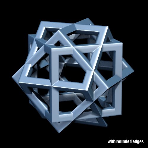

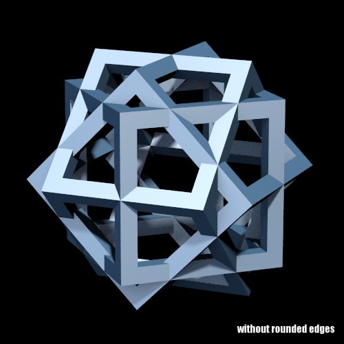

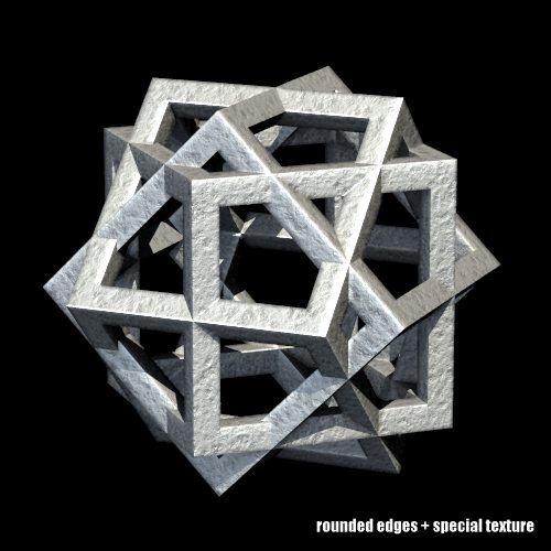

Here's something I began developing recently. It takes any old CSG
object and attempts to round its edges. It's based on the object pigment
pattern and works by exploiting the 'accuracy' of a surface normal.
It doesn't work too well if objects have preexisting round edges (eg.
spheres, cylinders), and doesn't leave the surface normals of the object
pointing in the original directions... which means it won't give you
100% accurate reflections and shading.
It looks nice enough, and is a good way to round the edges of complex
CSG without coding all kinds of cylinders and spheres into your object
definition.
This code will produce all three states as shown in the attached images:
#declare round_edges=on;
#declare edge_amount=1;
#declare edge_samples=20;
#declare obj=
union{
  #local frame=
   difference{
    #local r=0.2;
    box{-1,1}
    box{-1+(x+y-z)*r,1-(x+y-z)*r}
    box{-1+(x-y+z)*r,1-(x-y+z)*r}
    box{-1+(-x+y+z)*r,1-(-x+y+z)*r}
  object{frame rotate y*45}
  object{frame rotate x*45}
  object{frame rotate z*45}
object{obj
  pigment{rgb<.2 .5 1>}
  finish{
   brilliance 2 diffuse .4
   specular 1 roughness .1
  #if(round_edges=on)
  normal{
   average
   normal_map{
    #local V=0;
    #while(V<=1)
     [1
      object{obj } 1-V*1
      accuracy (.01+V/10)*edge_amount
      translate<
       rand(R)-rand(R),
       rand(R)-rand(R),
       rand(R)-rand(R)
      >*.00001
     #local V=V+1/edge_samples;
    #end
    // uncomment to add bumpy surface normal
    //[5 granite -1 accuracy .001
    //poly_wave 2 scale .3]
  #end
  // uncomment to add corresponding pigment
  //pigment{granite poly_wave 2 scale .3
  //color_map{[0 rgb 1][1 rgb .5]}}
Is this helpful to anyone? Questions and comments, appreciated as always!
-Sam
Download 're1.jpg' (28 KB) Download 're2.jpg' (28 KB) Download 're3.jpg' (38 KB)

Ineteresting, that could save a lot of work in some places.
ADB

Neat code! Would it be okay if I'd put that up in my POV-Code section? Won't
be there for a few days though, as I'm rehauling the website, but
nontheless...
Tim
Very helpful indeed; thanks for posting it, a valuable piece of code!
Beginners might not know R is a random number seed, so add:
#declare R = seed(0);
-Mark Slone

Tim, I wouldn't have posted it here if I was snooty about it being
redistributed. Go ahead!

Yikes! I always put that near the top of my scene code, so I totally
missed it. For the record, I used
#declare R = seed(0009);
because out of the twenty seeds I tried, that one had less surface
normal inaccuracies. Maybe I should post the complete code somewhere....
Thanks for catching that, Renderdog!
