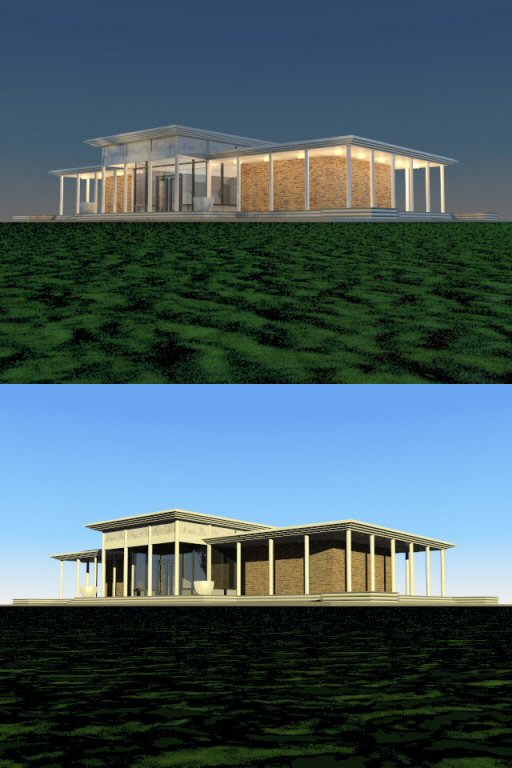

Another couple renderings of the Alabama Welcome Center building, one
showing it late in the day. I've about got it put together right, less some
minor details, so this is basically how the place actually looks. Unlike my
previous renders of it, which weren't very accurate, this now has the upper
front (or facade) as it should be.
I came across some trouble with reflection exponent causing blacked out
areas. At least, that's what I'm thinking must be part of the problem.
Radiosity exaggerates the problem to the point of obliterating most of the
building entrance area. Perhaps something I'm not doing right, just not sure
yet. Anyone reading this seen such a thing happen themselves? I'm guessing
adc_bailout or max_trace_level, or both, could be the solution/problem.
The blank, or black, artifacting is so severe with the introduction of, e.g.
'exponent 0.8', into the reflection statements that I thought it unusual,
having not noticed anything this bad before.
Bob H.

Hi !
Glad to see you're still working on it. (One of my own problems is I give up
projects before they are finished). Well, I'm quite interested in realistic
lighting and such, so maybe I can help.
I haven't used the "reflection exponent" keyword for a long time. It doesn't
seem to be necessary anymore. You have exposure control (at least in
MegaPOV1.0) that compresses the dynamic upper range of an entire rendering.
This means you can setup light_sources with realistic (high) light-emission.
That's why reflections will finally show up properly without the need of a
reflection exponent!
In this particular scene I sort of wonder, why you're putting such
importance into reflections. The materials of the building suggest that
reflection (mirror-like reflection anyway, accessed with the 'reflection'
keyword in POV-Ray) are just the top of the iceberg, meaning, they are
important only when we take a closer look. Most materials here are rough
stone-like (hence gives a very diffuse reflection). If you're talking about
the glassy entrance, it's another story. Well, I don't see any radiosity in
the daylight rendering (shadows are black) so I can't say if it messes up
with the entrance. Assuming you did render this with radiosity, try to
increase "brightness" in radiosity, just to see what's going on... You're
lucky though, with this scene radiosity can do a nice and quick job.
Hugo

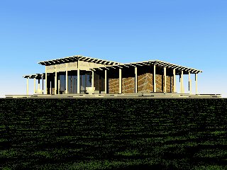

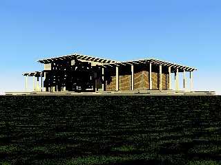

I should have shown an actual image of the artifacting before it was too
late. By that, I mean, I rerendered again today and couldn't get it to
happen. A good thing I guess, but turns it into more of a mystery. I was
trying to get a short test scene to do the same last night and couldn't,
even though I could go back and run a small rendering of this buidling and
still see it happening. I'm attaching a hand-drawn artifact to show what I
was seeing yesterday and what it looks like without radiosity.
Bob H.

Thanks for posting the extra renders. Is it true that both the daylight
rendering that you posted yesterday, and the no_rad version you posted
today, are without radiosity? Because they look the same to me.
The entrance-artifact that you mention could be due to a wrong value in
reflection_exponent (for example, if you wanted to write .8 you might have
written 8 ... it was late at night you said) or max_trace_level was set too
low. Usually, radiosity will not have much effect on glassy surfaces because
they provide very little diffuse reflection. They are mirror-like, and
refracts the light, both of which are independant calculations from
radiosity.

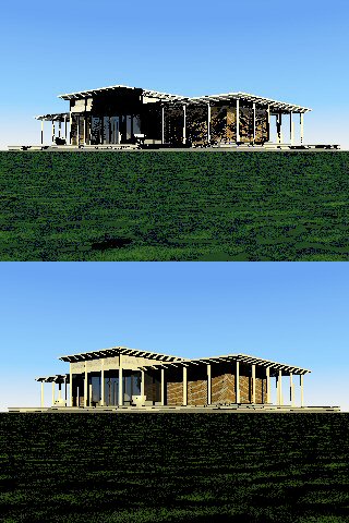

Good point. Nope, not the case, unfortunately. Now I've managed to see the
artifacting again so I attached another image. Both renders are subjected to
the problem, the top one has radiosity and the lower does not (merely
speckles by comparison). This happened after adding back in 'exponent' to
every reflection statement, all but the brick has at least some reflection.
I better speak up about the reflection_exponent no longer being used, it's
only 'exponent' now in 3.6, even though the Editor still recognizes the old
keyword. I had thought it was removed until you mentioned it. #version

Download 'awc_reflect-exp.jpg' (48 KB)
Preview of image 'awc_reflect-exp.jpg'
From: Hugo Asm
Subject: Re: AWC WIP
Date: 8 Aug 2004 11:22:29
Message: <41164535$1@news.povray.org>
> Now I've managed to see the artifacting again
That's strange. Never seen anything quite like it. Reminds me a little of
two coinciding surfaces, both located between the light_source and the
building, resulting in strange shadows.. Or the recent blob & torus accuracy
problem which is obviously not the case here.. So I don't know what it is.
> This happened after adding back in 'exponent' to every
Strange.
> being used, it's only 'exponent' now in 3.6
Oh, thanks for the info. I hadn't noticed, and I must confess that I haven't
even started using 3.6 yet... MegaPOV is my preferred choice.
Hugo
