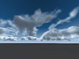

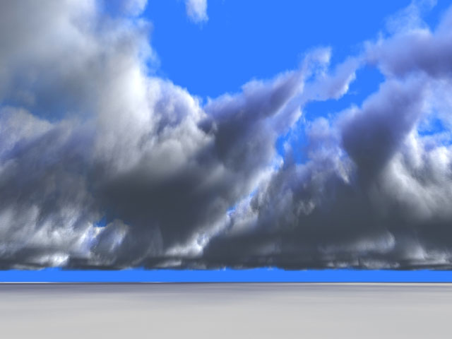

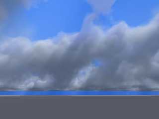

I have been experimenting with media-based clouds using pigment functions.
After lots of playing, I think I've finally begin to understand the balance
between emitting, absorption, and scattering medias.  I've also found that
method 3 with 1 interval and a decent amount of samples seems to work the
best (in terms of speed/quality).
Images number 1 and 3 were the slowest, about (estimated) 17h and 24h on a
P4 2.66GHz machine running at 60% duty cycle.
Image 2 is much faster, about 4 hours on a P4 3.0 @ 3.5 running 100% duty
cycle
Originals were 800 x 600, except for 3 which was 1024x768
Still working on making thunderheads, I think I've found a way using the
cylindrical pattern and a few transforms...
                        Reactor
Download 'cloud_test1.jpg' (32 KB) Download 'cloud_test2.jpg' (22 KB) Download 'cloud_test3.jpg' (18 KB)
Preview of image 'cloud_test1.jpg'
Preview of image 'cloud_test2.jpg'
Preview of image 'cloud_test3.jpg'

WOW! Those look amazing! I especially love the visible light shining
through the coulds in the third picture.

It looks to me that the shape of the cloud is governed by the shape of the
container. In your case this is a flat box. Looking at the cloud from a large
distance (or when it is scaled to a smaller size), the box shape becomes
visible. IMHO, if you adjust the size of the container then you can make any
shape of cloud. So, making a hammerhead shaped container and filling it with
"cloudy media" shoud get you where you want to be.
Maurice

Awesome... especially the first image! But the rendering durations are
also awesome - better not to think about how long such a scene would
take on my pre-war rattletrap (AMD K6-2/400 MHz)!
