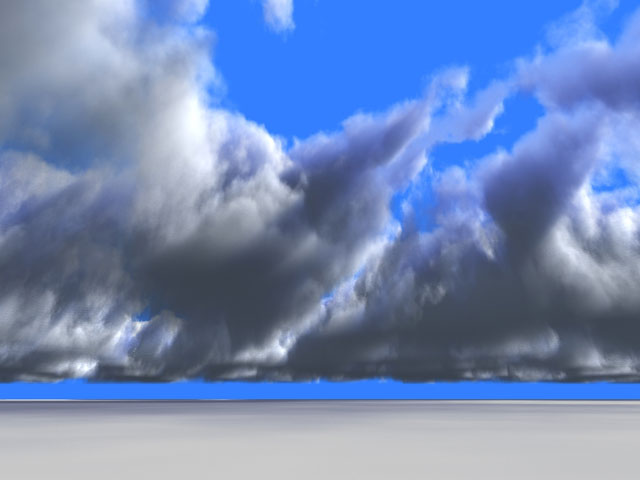

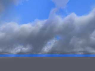

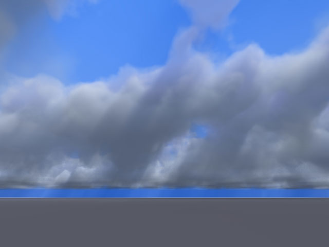

I have been experimenting with media-based clouds using pigment functions.
After lots of playing, I think I've finally begin to understand the balance
between emitting, absorption, and scattering medias.  I've also found that
method 3 with 1 interval and a decent amount of samples seems to work the
best (in terms of speed/quality).
Images number 1 and 3 were the slowest, about (estimated) 17h and 24h on a
P4 2.66GHz machine running at 60% duty cycle.
Image 2 is much faster, about 4 hours on a P4 3.0 @ 3.5 running 100% duty
cycle
Originals were 800 x 600, except for 3 which was 1024x768
Still working on making thunderheads, I think I've found a way using the
cylindrical pattern and a few transforms...
                        Reactor
Download 'cloud_test1.jpg' (32 KB) Download 'cloud_test2.jpg' (22 KB) Download 'cloud_test3.jpg' (18 KB)
Preview of image 'cloud_test1.jpg'
Preview of image 'cloud_test2.jpg'
Preview of image 'cloud_test3.jpg'

Curious what scale you used.  I think that's one of the trickier parts
of choosing media settings.
Was 1 POV unit 1 meter?   1 mile?   1 cloud?   arbitrary?
Was the sun <rgb 1> <rgb 100> etc.
Do the media settings have any correlation to any turbidity/opacity
units (miles of visibility?)
From: Reactor
Subject: Re: Media based cloud testing
Date: 28 Jul 2004 19:49:45
Message: <41083b99$1@news.povray.org>
"Ron M" <rm_### [at] cheapcomplexdevicescom> seems to have written in message
news:410### [at] cheapcomplexdevicescom...
First of all, thanks all for the kind responses.  I am posting a source
snipet that should answer a few questions.  A macro is in the works, but it
might take a while...
I used 1 pov unit = approximately 1 foot.
I have placed comments in the attached source snipet.  It isn't a full
scene, just the media block and explanation.  Please feel free to play with
it, and, if someone figures out how to make good thunderheads, please post
your method... I am experimenting with a few things, and I have a
quarter-baked idea for the "Desert" topic (isn't fully formed enough to be
half baked).
Be aware that media clouds have very long render times.
        Reactor
Download 'clouds_description.pov.txt' (3 KB)
