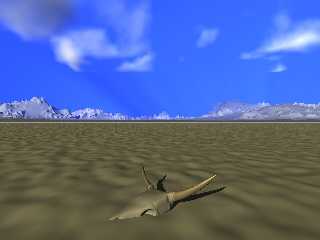

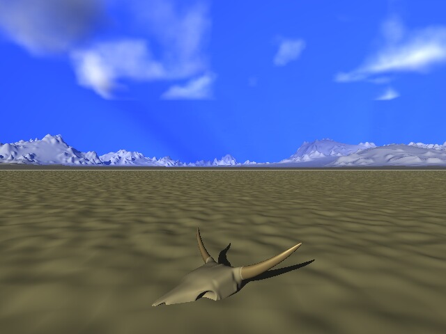

Hmm,
I need some rocks, some sparse vegetation, and some vertibrae possibly
ribs...
The mountains bother me a bit. Though the media is giving the desired
haze effect.... Maybe after I get the proper texture on the mountains.
Comments, suggestions ... criticism?
Download 'desert-wip1.jpg' (44 KB)
Preview of image 'desert-wip1.jpg'

Coming along nicely.  More scrub as you say.  It would be a very unusual
topography, would it not, that would be so sandy and so flat at the same
time?  If sand, then drifts.  If flat, then more clay than sand. Or salt
lake?  I could be wrong.  Anyway I would buy the flat idea,in general,
if there was some slight vegetation.  Of course it goes without saying
that you need more texture to carry the foreground.  Would like to see
some good texture work on the skull especially.  Don't forget you can
save your Wings mesh with different texture assigments, say for the
horns, and they will show up in your mesh2 texture list.  Then you can
manually texture them to get differing effects.
Also the composition is a bit odd with the skull being so dead center
yet relatively small.  Not sure if it's good or bad, but noticeble.
Like the way tourists frame shots.

Yes, those additions would improve the image.
How about more of a gradient in the sky, it looks just a little too blue.
Maybe a dark blue on the top and more of a greyish light blue on the bottom?
I know media atmospheres are quite hard to control.  I'm having the same
problem right now with my desert scene.  I think I can away with using a
ground fog though.
In addition to rocks and vegetation, the actual ground texture itself is
going to need some more detail.  What are you using right now, a plane with
a normal?  How about an isosurface with some noise/turbulence on it, or at
least another smaller normal on the plane?
Skip

Yep, this is one thing I would like to address is adding just a bit more
relief to the sand... some dunes, but I'm having a tough grasp at the
ridged_mf function... Mountains will some somewhat like the contenental
divide,.. snowcapped, a bit darker in color.
I'm thinking POVTree may be able to generate some scraggly bushes, maybe
some mesquite trees...
Yes ;) I do have separate textures for the horns and the skull itself.
I'm curious to know whether Wings saves any UV_Mapping information, if
so, this would make texturing the horns easy.. I have an idea that I
want to carry forward.
> yet relatively small.  Not sure if it's good or bad, but noticeble. Like
Yeah, after I posted the image, I studied it a bit, and I think I'll
move the skull somewhere... I need to add a few more bones.. ribcage and
  such, just a few (something died...Maybe bits were taken away by
coyotes... )
I'd like to keep the focal area pretty much flat, maybe increase some of
the parameters the further down the z-axis to give the appearance of
dunes in the background, before the mountains.
The main idea here is this dead animal has been here for a while and is
half-buried in the sand, now.
Radiosity and a blue ambient sphere may add some coolness to the
shadows, as well. The light's color has been warmed up by the media in
the sky, the skull isn't nearly as yellow as it appears at the moment.

    The skull's looking good apart from the 'square' sides behind the
mouth. Maybe adjust those points/lines/faces in that area so that
there's an indent/depression each side?
  Take a look here, I don't know what skulls these are, but amazingly,
these are in Wales:
     (halfway down)  http://www.glamorganwalks.com/whatsnew.htm
   Looking forward to  the finished image.  :)
