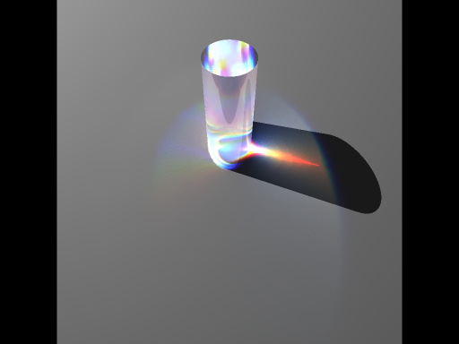

Changing the table to white and the "glass" to almost clear does show
both reflection and refraction caustics with strong dispersion.<br>
My changes to the glass are: remove caustics 2, add collect off in th
photons block, recolor to bluish white "rgbft
<0.9,0.9,1,0.99,0.0>" instead of blue, change the ambient to 0
and diffuse to 0.1, increased dispersion_samples to 20.<br>
I also made the "table" white.<br>
Reverted to default Max_trace_level hithout any obvious black spot.<br>
It renders somewhat faster to.<br>
<img height="768" width="1024" alt=""
 src="cid:par### [at] qwertygov"><br>
<br>

Download 'test.png' (217 KB)
Preview of image 'test.png'

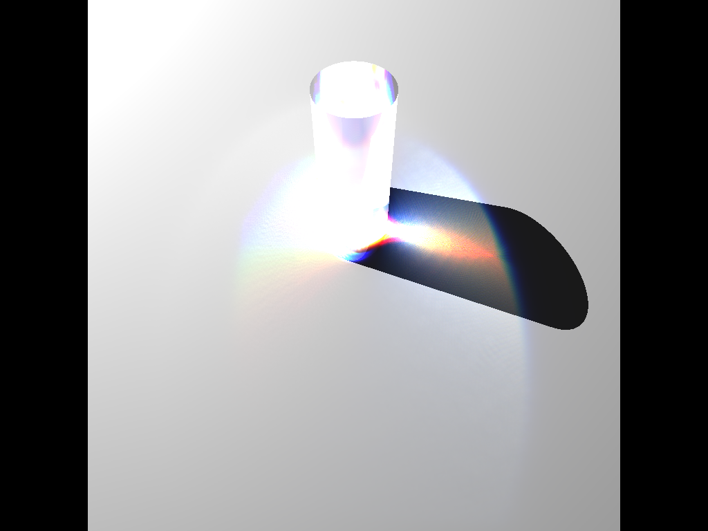

I missed that one: to bright light_source washing things out<br>
Removing the *2 give much beter results.<br>
<blockquote cite="mid40b1240a@news.povray.org" type="cite">
  <blockquote cite="mid40b0f1a8@news.povray.org" type="cite">
    <pre wrap="">
light_source
        <4,4,5>
     >>>>>>>> color rgb <1,1,1>*2
<<<<<<<<<< change to rgb 1
        photons
                refraction on
                reflection on
    </pre>
  </blockquote>
  <img height="384" width="512" alt=""
</blockquote>
Alain<br>

Download 'test.png' (56 KB)
