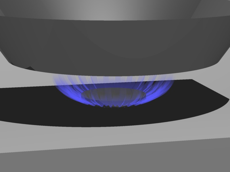

I got many good suggestions in my previous post, "gas flame (needs help)",
and after much experimenting, I ended up using something completely
different. I looked closely at the gas flame on my own kitchen stove and
observed that it appears to have no thickness at all. So I made a mesh with
no thickness and then experimented with different textures. the flame in the
attached image has an ambient value of 1.0, which makes it appear to be
emitting light even though the light is completely blocked.

From: Felbrigg
Subject: Re: Gas Burner
Date: 29 Mar 2004 09:16:35
Message: <40682fc3$1@news.povray.org>
Nice!  Is this the finished image or is it stil WIP?
From: Steve Shelby
Date: 29 Mar 2004 12:37:14
Message: <40685eca@news.povray.org>
Thanks. WIP. I want to try to put some orange in the flame. The other things
in the scene are just props. My goal is to make a detailed scene with a
steaming teakettle.

From: Dan P
Date: 29 Mar 2004 14:29:59
Message: <40687937@news.povray.org>
> Steve Shelby
Wow, totally gettin' there! If the flames emit light and the middle
burner has a high specular value, plus make it a rounded disc, it will
look even more realistic. The flames should not have any absorption in
them; they are purely emissive. Radiosity will help too.

From: scott
Date: 30 Mar 2004 17:01:20
Message: <4069ee30@news.povray.org>
> help)", and after much experimenting, I ended up using something
> completely different. I looked closely at the gas flame on my own
> kitchen stove and observed that it appears to have no thickness at
> all. So I made a mesh with no thickness and then experimented with
> different textures. the flame in the attached image has an ambient
> value of 1.0, which makes it appear to be emitting light even though
> Steve Shelby
Just having a quick look at my gas hob the flame seems to be made from
almost two separate bits.  The first bit is quite opaque light blue (you
can't see through it like you can in your image), then a second bigger flame
is transparent lighter blue.  I think if you did another set of flame
segments, each starting from the same position as the original ones, but
maybe half the size, more opaque and lighter blue, that might look quite
good.
I guess you could take a photo, it's quite hard to tell just by looking at
the flame!
From: Steve Shelby
Date: 30 Mar 2004 21:44:34
Message: <406a3092@news.povray.org>

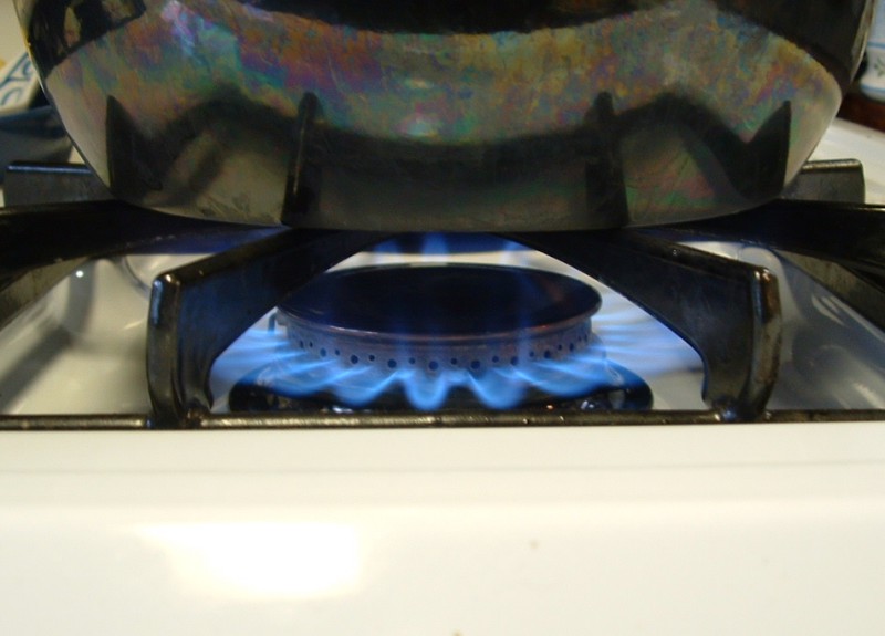

Thanks for suggesting taking a photo. I took some with my digital camera,
(see attachment)and I can compare directly on my computer screen. I can see
now I still have a way to go.

From: Dan P
Date: 30 Mar 2004 22:01:21
Message: <406a3481$1@news.povray.org>
> Steve Shelby
Don't forget the "irid" in that pot! :-)

From: Steve Shelby
Date: 31 Mar 2004 07:02:33
Message: <406ab359@news.povray.org>
"Dan P" <dan### [at] yahoocom> wrote in message
news:406a3481$1@news.povray.org...
Yes. The camera "sees" that better than the naked eye does. I didn't even
notice it until I saw the picture. Also, the camara seems to make the bottom
part of the flame more opaque and the upper part more transparent.
Steve
